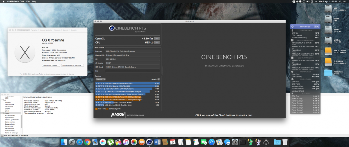

OS: Yosemite 10.10.5
Motherboard: ASUS Sabertooth 990fx r2.0
CPU: AMD FX9590 (currently @ 3600MHz)
GPU: NVIDIA GTX670
Memory: 16GB @ 1333 MHz
Kernel: Bronya RC3
Bootloader: Clover EFI r3330
Sound: Audioengine D1 (usb)
Ethernet: Realtek RTL8168
Kext: Patched AMD Kext + Ethernet Driver
Graphics Driver: Native and Web (both work)
Everything works as expected.
Even my 4k Monitor.
  • Like 3

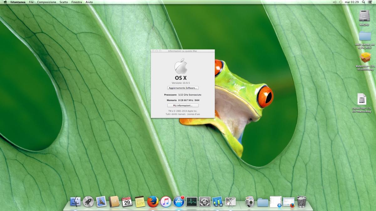

OS X: El Capitan need help! :D ===> Now El Capitan works. :D
El Capitan 10.11.2/Bronya RC1/Enoch
Yosemite 10.10.5/Bronya RC3
Mavericks 10.9.5
Mountain Lion 10.8.5
Snow Leopard 10.6.8/AnV's 10.6.8/Sinetek 10.6.8
Motherboard: GA MA78G DS3H
CPU: AMD Phenom II X4 920
GPU: AMD HD 7770
Memory: 4GB @ 1066 MHz
Kernel:

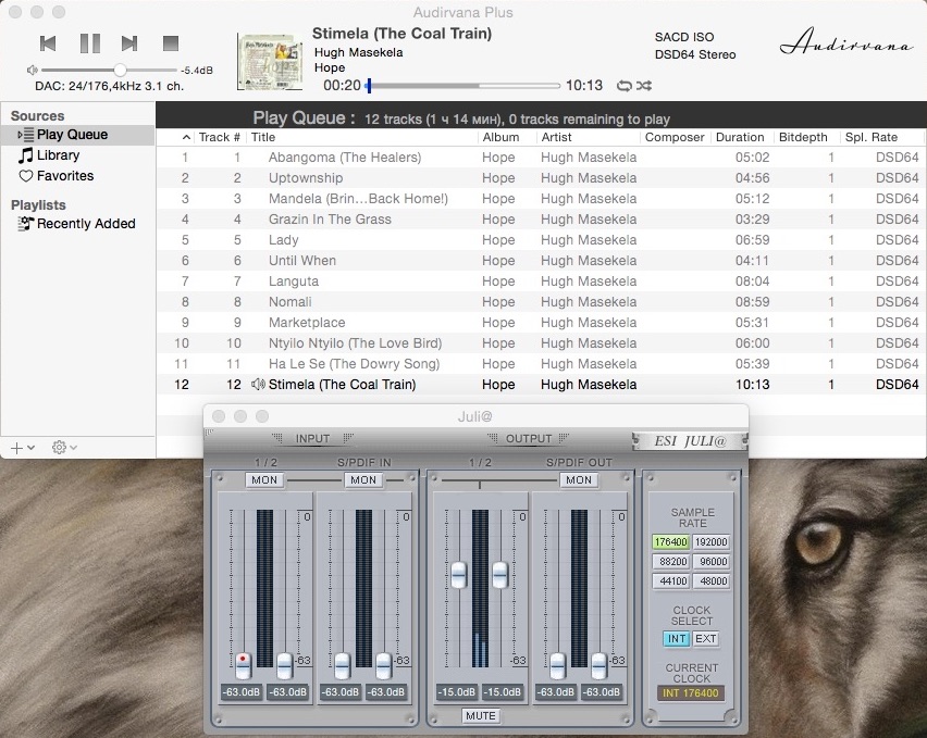

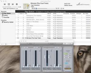

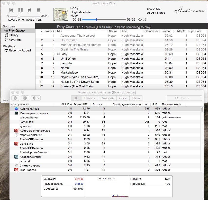

CPU: AMD FX-6200
Motherboard: ASUS Sabertooth 990FX
Chipset: AMD 990FX/SB950
RAM: 8GB
HDD: 1x 250 GB Seagate SATA2
GPU: GeForce GTX 750 Ti 1GB
LANRealtek8111 works with Realtek8111.kext
Sound: Esi Juli@ works with Juli@_XTe-Mac-v2_5.dmg
Installed OS: Yosemite 10.10.5, fully updated.
KernelBronya -  kernel_10.10.5_rc3
Pathed IOPCIFamily.kext for msibase=0x90
http://www.insanelymac.com/forum/topic/302075-amd-yosemite-kernel-testing-for-help-use-the-help-topic/page-57?do=findComment&comment=2121146
Bootloader: Clover in ESP
P.S. Video created 29.03.2016 with internal ALC892.
31.03.2016 internal ALC892 - off, delete voodoohda, instal ESI Juli@.

Just finished installing OS X 10.9 on my build :)  :)
I didn't choose the parts for hackintoshing at first so there were compatibility issues at first
This was a BUDGET build

Installed OS: Yosemite 10.10.5 full updated and El Capitan 10.11.5 ( Waiting Kernel FX  :drool: )
Mobo: MSI 990FX-65GD
CPU: AMD FX -8350 Procesador de núcleos Ocho
RAM: 16 GB 1600 Crucial Ballistix
GPU: Nvidia GTX 960 4GB
Bootloader: Enoch-rev.2839
Kernel: 10.10.5 Bronya RC3
Extra boot flags:  -v  -f  npci=0x3000  nvda_drv=1 EthernetBuiltIn=Yes
kext:
 - AppleACPIPlatform.kext IOACPIFamily.kext IOPCIFamily.kext AHCIPortInjector.kext
 - GPU: Nvidia Web Driver 346.02.03f01
 - Audio: ALC892 VoodooHDA 2.8.8
 - Lan: RealtekRTL8111.kext v.1.2.3
 - Wacom: PenTablet 5.3.6-6
