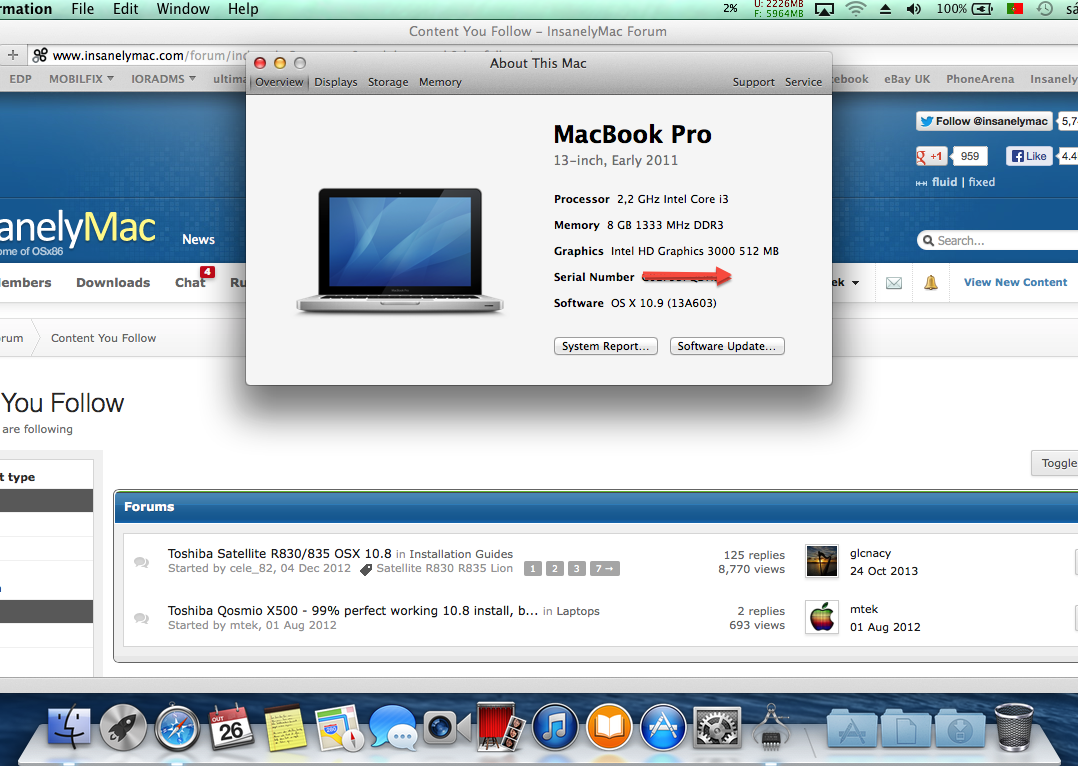

Success!!!  :D
Thanks a lot glnacy for your kext pack that worked pretty much everything important OOB!  :thumbsup_anim:
Almost everything is working just fine and maybe it's time to make a installation guide on official 10.9.
Only problems I've noticed are related to my wifi card that is different (AR90285) that I've switched in order to get the BT to work, but it has issues on 10.9 like it's recognized and works with "your" kext, but then I cannot connect to any protected wifi networks (gives a prompt connection failed error) but oddly enough works on unprotected wifi networks - go figure! So a switch back to the original wifi card or maybe a 100% native recognized airport one is in the works now.
Sleep also doesn't work for me, the screen goes black but never gets into real sleep, then wakes up on pressing a key just to shortly after get the screen corrupt and freeze. Are you using sleepenabler.kext? If so what version? Could you also please share you extra folder? Maybe there's the 'secret'...
Thanks again for everything to all the great guys here.  B)
