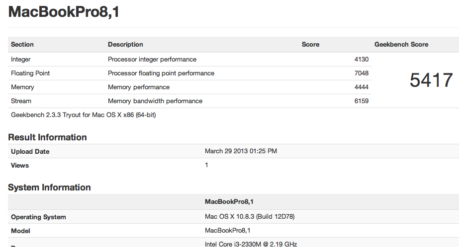

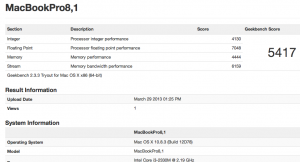

mtek Posted March 29, 2013 Share Posted March 29, 2013 Thanks for the kext - will try it out. I'm currently running without a SSDT and the performance is great and battery life is close to 4h hour on light/normal use. BTW how much do you score in Geekbench 2 with your i5? Mine does circa 5500...without SSDT or turbo mode which is not too bad I believe. Link to comment Share on other sites More sharing options...
cele_82 Posted March 29, 2013 Author Share Posted March 29, 2013 No idea, I never benched my i5... Link to comment Share on other sites More sharing options...
mtek Posted March 30, 2013 Share Posted March 30, 2013 No idea, I never benched my i5... Well if you ever decide to, then Geekbench is the reference system benchmark util. Here's a list of typical mac benchmarks, and from what I read I'm pretty happy with my R830's performance in every way, it's really snappy as a 'mac' and with the new HDD it boots and runs apps lightning fast. A true macbook pro replacement for a fraction of the price. http://browser.primatelabs.com/mac-benchmarks Link to comment Share on other sites More sharing options...

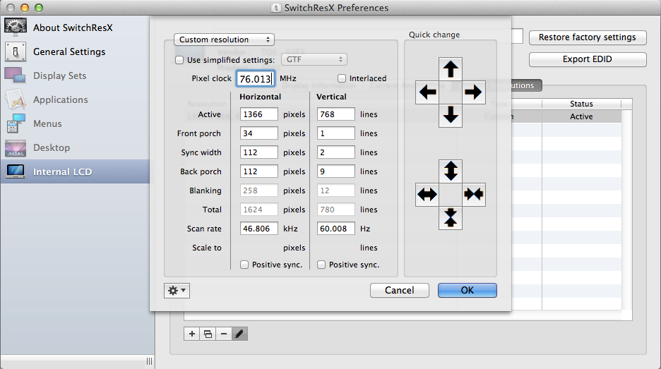

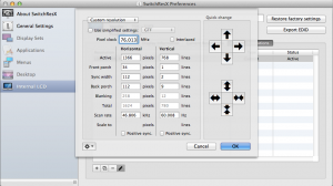

real_didi Posted June 1, 2013 Share Posted June 1, 2013 in Windows and Linux Live i could work with the display but in Mac Os X my eyes got tired very quick. Ok. I've managed to get pixel clock profile from Windows using PowerStrip. After that i installed SwitchResX and added Custom Resolution with this clocks to Internal LCD and restarted. With this settings it's a little bit comfortable to my eyes i think. I've attached custom resolution settings that i use: Also there is some noise from place where cooler fan is placed but it's not from cooler. I think it's a problem with power management and that noise is randomly appears when using network through wifi/ethernet and virtual machine. This noise regularly appears when scrolling web page in Safari/Chrome browser. And there is artifacts appears on screen after some time and in VMWare Fusion. I think i need to sell this laptop P.S. Also I've included my own calibrated display profile and dsdt that i extracted and patched myself with some modifications from cele_82's dsdt just for archive purposes. For those who wants to make their own DSDT (and for me if i forgot something in future): 1. Download DSDT Editor. Google 'DSDT Editor' and use 1st link to insanelymac. 2. Extract dsdt when boot without any other dsdt in bootloader. 3. Find all first-level scopes in tree that starts with "\". rename all of them removing first character:eg "\_SB" to "_SB". 4. Find in tree _SB/PCI0/GFX0 and find scope inside that ends with "PCI0". It should be corrected to "^^PCI0" 5. Apply all patches from downloaded DSDT Editor from Sandy Bridge folder. 6. Try to compile. There will be about hundred errors. Find error that ends with "min/max". There should be two errors of that kind. Click on first of them. There should be code: DWordMemory (ResourceProducer, PosDecode, MinFixed, MaxFixed, Cacheable, ReadWrite, 0x00000000, // Granularity 0x00000000, // Range Minimum 0xFEAFFFFF, // Range Maximum 0x00000000, // Translation Offset 0x00000000, // Length ,, _Y0D, AddressRangeMemory, TypeStatic) replace to DWordMemory (ResourceProducer, PosDecode, MinFixed, MaxFixed, Cacheable, ReadWrite, 0x00000000, // Granularity 0x00000000, // Range Minimum 0xFEAFFFFF, // Range Maximum 0x00000000, // Translation Offset 0xFEB00000, // Length ,, _Y0D, AddressRangeMemory, TypeStatic) (//length parameter only corrected to 0xFEB00000) For second error replace DWordMemory (ResourceProducer, PosDecode, MinFixed, MaxFixed, Cacheable, ReadWrite, 0x00000000, // Granularity 0xFED40000, // Range Minimum 0xFED44FFF, // Range Maximum 0x00000000, // Translation Offset 0x00000000, // Length ,, , AddressRangeMemory, TypeStatic) for DWordMemory (ResourceProducer, PosDecode, MinFixed, MaxFixed, Cacheable, ReadWrite, 0x00000000, // Granularity 0xFED40000, // Range Minimum 0xFED44FFF, // Range Maximum 0x00000000, // Translation Offset 0x00005000, // Length ,, , AddressRangeMemory, TypeStatic) (length param is replaced) 7.Find _DSM method in _SB/PCI0/GFX0 in DSDT from cele_82(first post) and copy it to _SB/PCI0/GFX0. (The _DSM method must be only one if there is old _DSM method you need to add to it missing content from first post's DSDT) This will enable graphics. 8.Find _DSM method in _SB/PCI0/HDEF in DSDT from cele_82(first post) and copy it to _SB/PCI0/HDEF. (The _DSM method must be only one if there is old _DSM method you need to add to it missing content from first post's DSDT) This will enable sound. 9.Compile and save file to /Extra/DSDT.aml Internal LCD Calibrated 3.icc.zip DSDT.aml.zip 2 Link to comment Share on other sites More sharing options...
