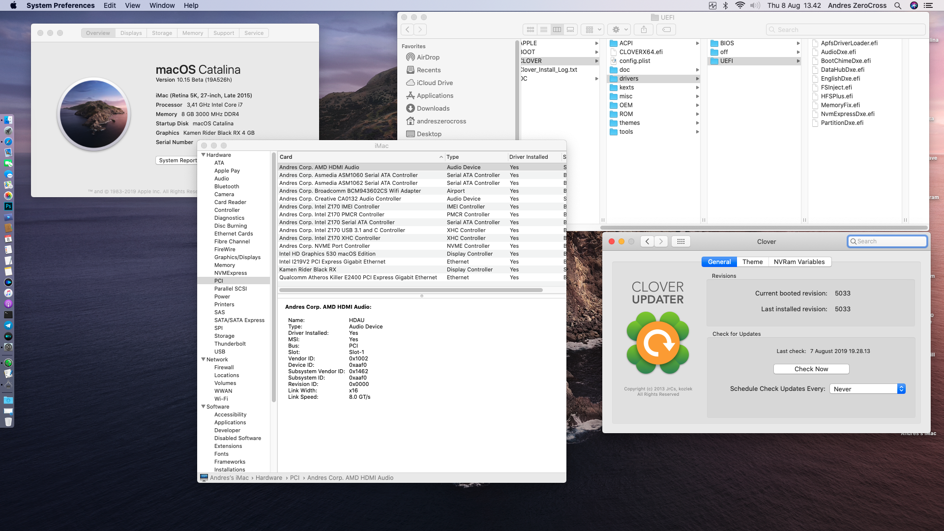

2 hours ago, Andres ZeroCross said:
Slice sorry for this question again,, defaul sample of config.plist always drop DMAR table. But i have tested to delete this, AppleVTD is shown in IOREG (DMAR ACPI TABLE) is loaded in macOS with no problem. I have tested it in Broadwell, Skylake, Kabylake and Coffelake.
Is this neccessery to drop DMAR table??? or can you point me to the link about old issue with DMAR table?
This is very old issue, several years ago, macOS just crashed at start. The workarounds were dropDMAR or dart=0.
May be there was Apple's mistake fixed in new macOS.
  • Like 3
4 minutes ago, Slice said:
Thanks, committed to 5037.
Thanks, i will keep using this table. I don't get any issue with this table.
