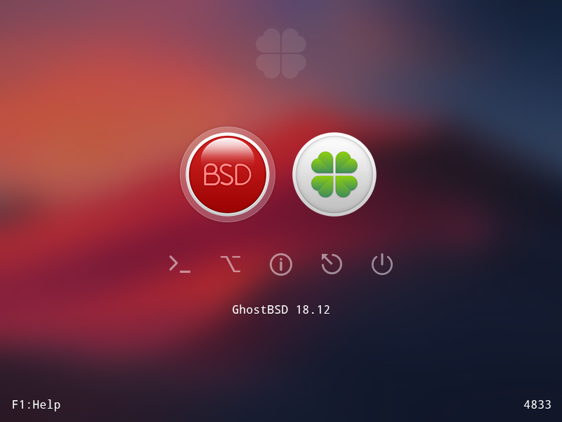

Adding this line is definitely possible, it detected by Clover and BSD System boot just fine (plus os_ghostbsd.icns for GUI):
{ L"\\EFI\\boot\\bootx64-trueos.efi", L"GhostBSD EFI boot menu", L"ghostbsd,linux", "GhostBSD" },
..though sorry for my script kiddie, it' s wrong bcoz BSD is not Linux for sure.

That's a list of icons, you don't need to put linux there, lol. Just do ghostbsd,bsd and make both icons if you want. You can't have both ghostbsd and trueos installed then? That's stupid.
Oh I see, now much better with "os_unknown.icns" instead of wrong generic "os_linux.icns" for BSD System LoL (if there's no os_ghostbsd.icns provided with a theme used).
#EDIT: Nevermind, no longer using "os_unknown.icns" if there's "os_bsd.icns" on /icons dir (which previously was missing).

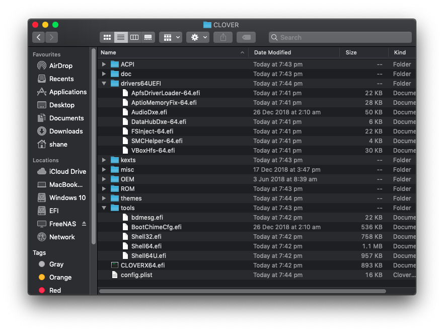

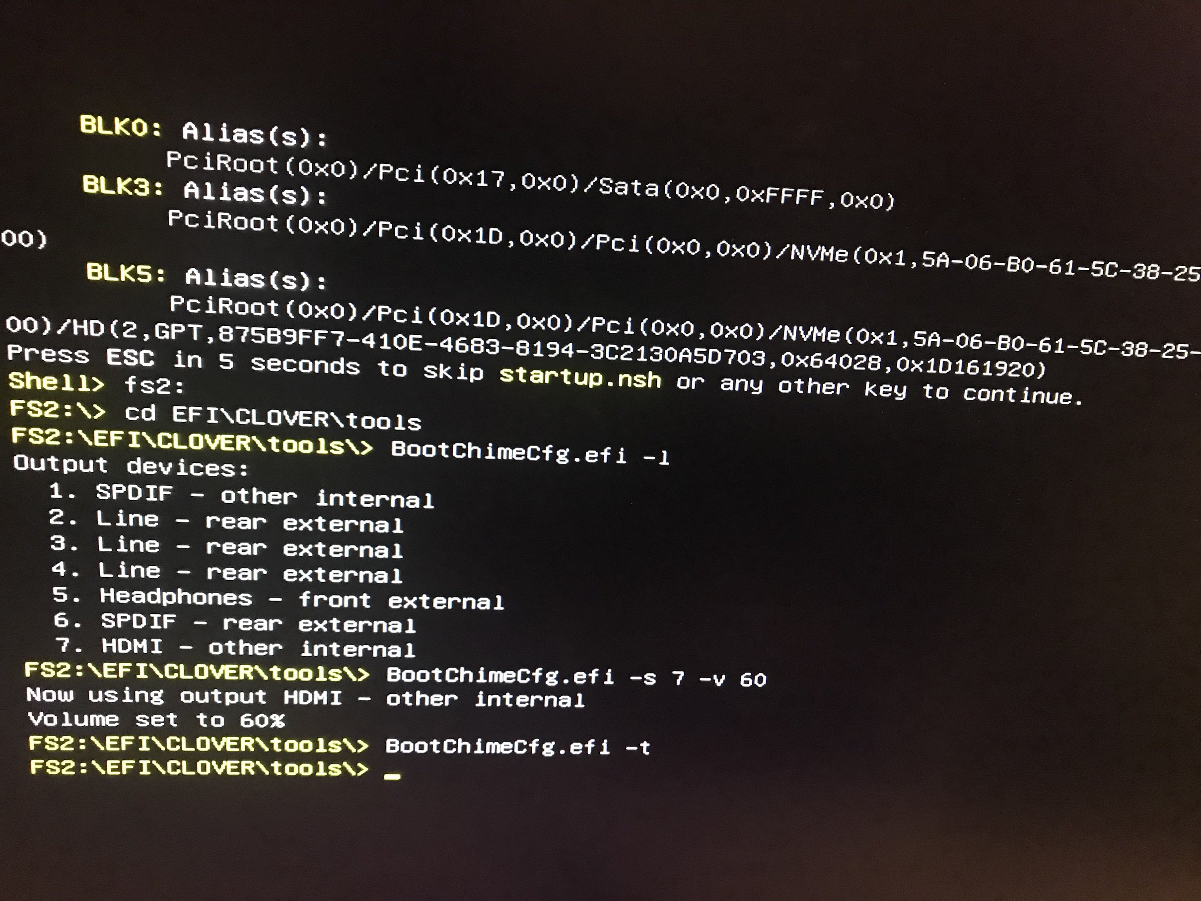

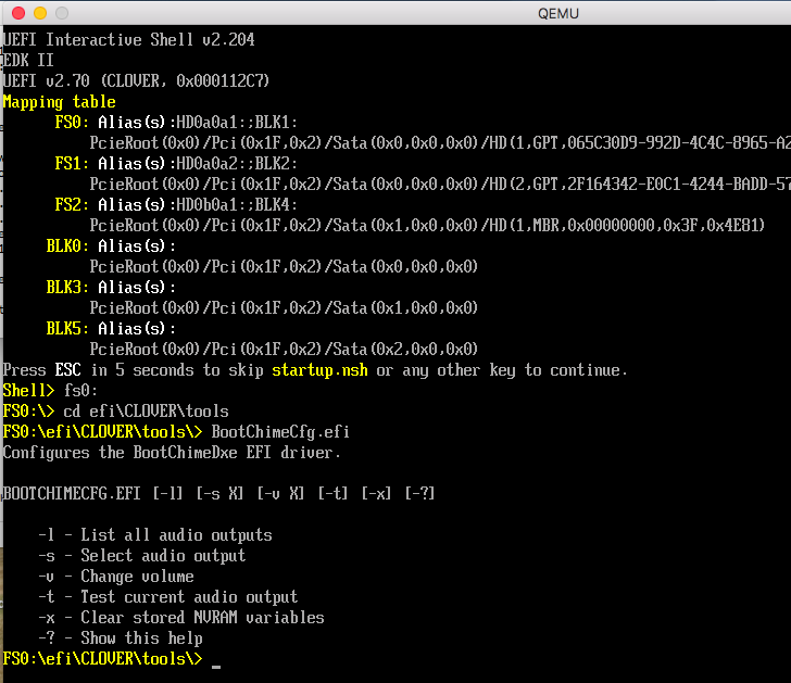

I am unable to build r4833 until i downloaded AudioPkg-master.zip from https://github.com/Goldfish64/AudioPkg and extract it to my edk2 folder and rename it. Is this what you did also?
After using the guide from Slice i cannot get sound to work on my laptop even though while setting it up in clover shell i had audio. Is the issue my conversion?
Mac Startup.wav
