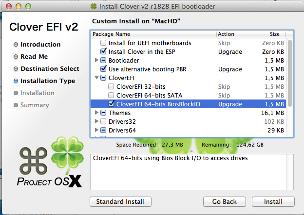

The newer rev. 1794 adds changes that make DVD work properly. I still have a nagging dilemma in which since rev. 1333, I can't boot my RAID0 volumes by USB stick. It only sees other GPT OSX partitions.
I would like to have a setup such that I can elect to boot my RAID0 volumes with either Chameleon or Clover.
Can somebody show me the way?
Did you check option BiosBlockIo?

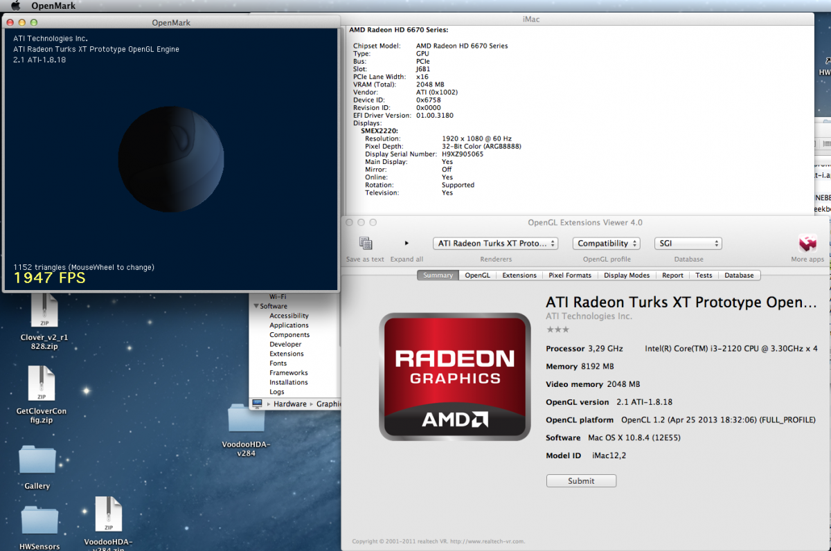

I am working with bin-patched HD6670 by Clover
<key>KernelAndKextPatches</key>
<dict>
 <key>KernelCpu</key>
 <string>No</string>
 <key>ATIConnectorsController</key>
 <string>6000</string>
 <key>ATIConnectorsData</key>
 <string>000400000403000000010000120401050008000004020000000100001102040310000000100000000001000000000002</string>
 <key>ATIConnectorsPatch</key>
 <string>040000000403000000010000100001061000000010000000000100000000000100080000040200000001000012040403</string>
 <key>AsusAICPUPM</key>
 <string>No</string>
 <key>AppleRTC</key>
 <string>Yes</string>
 <key>KextsToPatch</key>
 <array>
   <dict>
   <key>Name</key>
   <string>AppleAHCIPort</string>
   <key>Find</key>
   <data>RXh0ZXJuYWw=</data>
   <key>Replace</key>
   <data>SW50ZXJuYWw=</data>
   </dict>
 </array>
</dict>
"The fact tells" that you are unable to do something right.
Never tell "Clover can't", you must tell "I can't".
Hope you understand.
