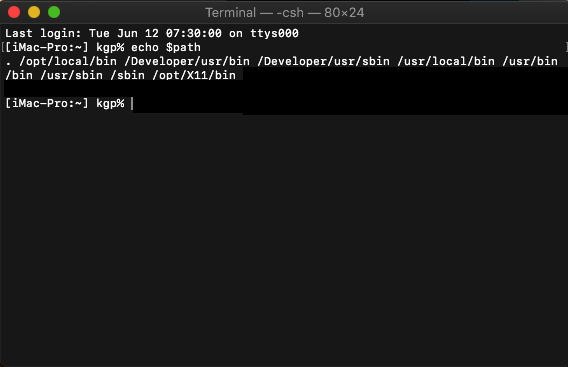

Just to confirm, should nasm be in /opt/local/bin/...on the root directory? Or...in ~/src/opt/local/bin...? It just seems odd that there's already a similar structure in src. It's like it's inviting you to put it there. :))
Anyway, I'm asking because now it's in /opt/local/bin/, as instructed. And..apparently that doesn't work too well, for some reason.
Edited by arsradu
It's a bug in the build process.
ebuild.sh calculates NASM_PREFIX using logic
BootHFS/Makefile just uses "nasm" and takes whatever is in the path
OTOH ebuild.sh also does pathmunge "$TOOLCHAIN_DIR/bin"
So if the nasm in the path is not the same as the one NASM_PREFIX you can end up using wrong nasm to build boot sectors and get this error.

2 minutes ago, Slice said:
I told
May be I forget to say how to set /opt/local/bin to be in priority
:) Yep, that's what I tried initially. But, as you saw above, I got an error. And that apparently was because I was using old nasm.
Now, /opt/local/bin is not present in etc/paths. Should I add it there?
iHack:Clover Slice$ echo $PATH
/opt/local/bin:/opt/local/sbin:/usr/bin:/bin:/usr/sbin:/sbin:/usr/local/bin:/opt/X11/bin
It was needed for other project but I don't know the logic of new ebuild.sh, what is default NASM path.

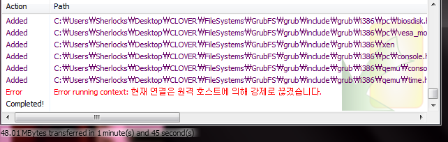

gate way issue happen when getting clover source from svn in windows.
normally, i commit source in windows after download clean clover source to avoid mistake.
but in last 2days, i never download clean source in windows from svn. always shown connection problem(gate way too. it means host disconnect my connection in sf. so i can't access sf site for some times). i just hope sf will back. because now i have a some part to cleanup clover source.

Yeeep, you already had it in $PATH from before. :P  No problem, I added it there now, as well. And made sure it's the right version.
NASM version 2.13.03 compiled on Feb  7 2018
But it couldn't have been that easy, now could it? :)) Now it says there is ' nothing to be done for "all" '.

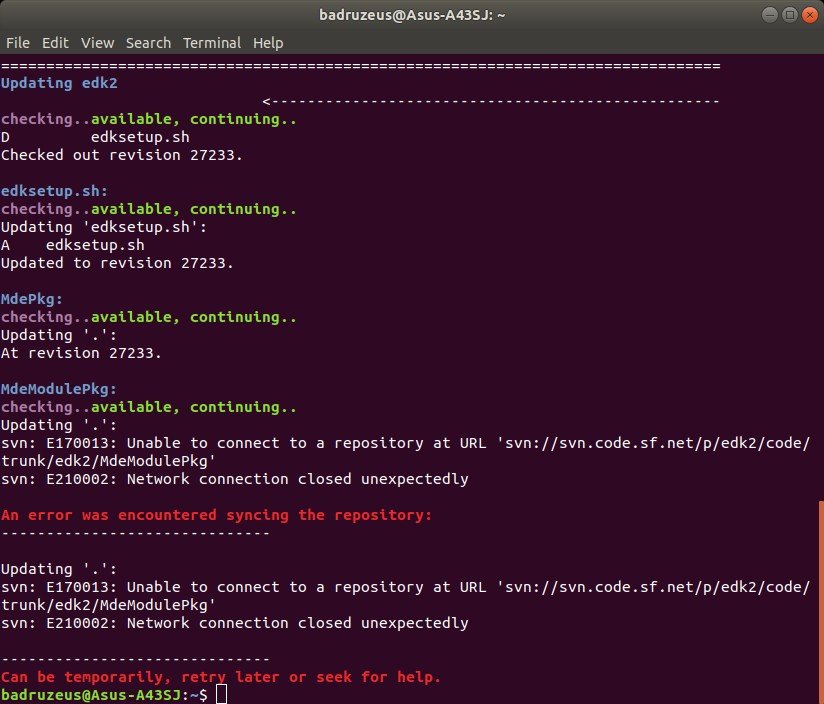

I just run build_clover script under Ubuntu 18.04 and also got issue with network connectivity.. it seems something wrong with the server but I'm not really sure, done with local ~/src rebuilt from scratch this morning under mac, then tonight we see this.

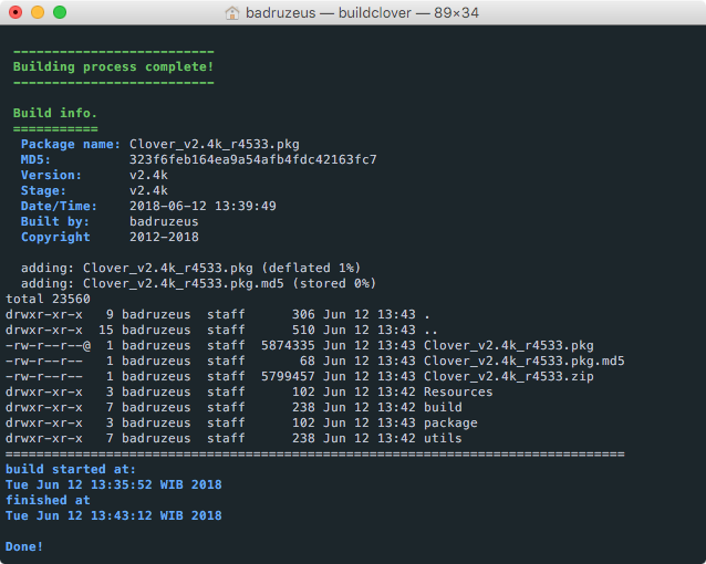

This morning I was able to download and build Clover_v2.4k_r4532 with Build_Clover.command on my X99 system after deleting the "src" directory in my home directory. However, on my X299 system, the clover build failed even after deleting the src directory and rebuilding clover from scratch.
Now , when I try to download and build clover from scratch, I also get server connection errors as already reported by others...

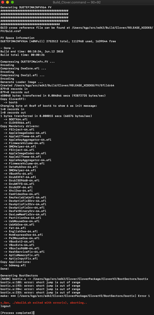

Although now I can do the initial clover download and step 2 without problems. The download is still slow though ..

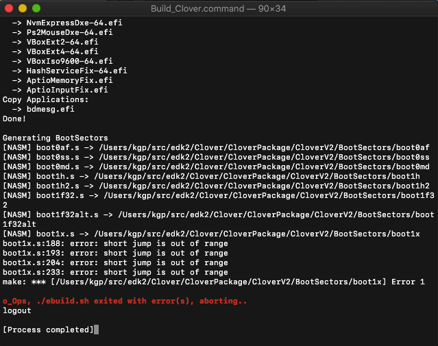

However, when building the existing revision for release (5), I still get the following error on my X299 rig, while (5) works fine on my X99 rig:
I am now left with the NASM issue on X299, mentioned in several posts before?

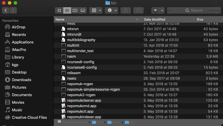

Then read how arsradu solved it.
All this apart from the remaining AptioMemoryFix.efi issue apparently persistent in Clover_v2.4k_r4532.... Can you please compare version of AptioMemoryFix.efi included in Clover_v2.4k_r4522 (working) and  Clover_v2.4k_r4532 (not working).. ?
NASM issue discussed few posts before.
