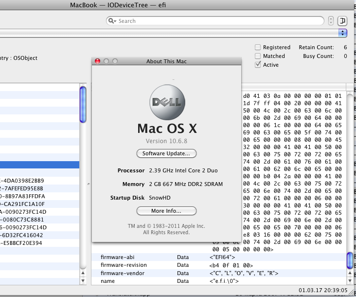

Slice Posted February 27, 2017 Share Posted February 27, 2017 Hi Zenith432, Not related to previous discussion, I found that Clover version > ~3500 can't boot 10.6.8. Always crash at AppleNVRAM. The problem is in boot6 -> RuntimeServices -> GetVariable() and I think the problem began at clang compilation. Before 3471 we compiled by gcc-4.9. The difference is EFI API which is not good supported by clang yet. macOS expected that RS procedures will have EFI API. It uses registers RCX, RDX, R8, R9 for the first four args. While clang compiles to UNIX API. RDI, RSI, RDX, RCX. I don't know why new systems are not crashed but 10.6.8 seems less stable. If I took boot6 3197 and CloverX64.efi rev 4003 all works fine. Link to comment Share on other sites More sharing options...
mhaeuser Posted February 27, 2017 Share Posted February 27, 2017 The difference is EFI API which is not good supported by clang yet. macOS expected that RS procedures will have EFI API. It uses registers RCX, RDX, R8, R9 for the first four args. While clang compiles to UNIX API. RDI, RSI, RDX, RCX. CLANG38 defines "EFIAPI=__attribute__((ms_abi))". Link to comment Share on other sites More sharing options...
Zenith432 Posted February 27, 2017 Share Posted February 27, 2017 XCODE5 target uses "-target x86_64-pc-win32-macho" which has Microsoft Windows64 ABI by default on all functions (no need for __attribute__((ms_abi))). However, the handling of VA_LIST is tricky for this target. In Apple clang ver >= 7.3 or Generic clang ver >= 3.7, using __builtin_ms_va_list works with above target. Prior to these versions of clang there is __builtin_va_list for above target which works in a semi-broken-way. There is also a bug in __builtin_ms_va_list handling for above target in clang. I don't know if this has been fixed, but edk2 code in MdePkg/Base/Include.h works around this bug by always jumping at least sizeof(UINTN) when iterating VA_LIST. CLANG38 target uses "-target x86_64-pc-linux-gnu" which generates different code. It needs __attribute__((ms_abi)) for Windows64 ABI functions, and relies on __builtin_ms_va_list for VA_LIST. I haven't tested what kind of code this generates. Link to comment Share on other sites More sharing options...

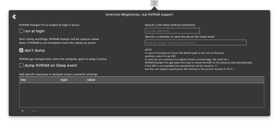

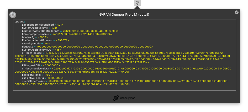

bozma88 Posted February 28, 2017 Share Posted February 28, 2017 Ok, fixed and tested in 10.7.5, plus I've added the possibility of adding custom keys while dumping the nvram: beta1.png You can add what you like with Data, String and Number tags. Like a plist Data tag must contains a valid hex datas, Number means integers (floats/double are converted to max 32 bit int). String can be what you like. If you type invalid characters for Data/Numbers, the app will continue beebing until you fix it. Keys with lenght 0 will not be saved. Actually there's no check for duplicate keys, so in the case, the higer index is what will finish to nvram.plist. This is a new version and the first time will require to reinstall the helper tool, and you have to restart the app manually (later will be sutomatic). Before try this new one uncheck "run at login" from the old one, otherwise you will have two apps loaded.. Hi Micky1979, I tried your app, it tells me that my PC (Dell XPS 13 9360) has real NVRAM. So I tried to delete EmuVariableUEFI driver, /nvram.plist and shutdown/boot rc clover scripts. I also reset the NVRAM, which on this laptop is done by resetting BIOS settings. I have two issues: Backlight is not saved/restored upon reboot and after wake from sleep BT and WIFI are permanently shutdown until next reboot. I placed EmuVariableUEFI back and WIFI+BT issue disappeared. Maybe I don't get the full picture, can you help me understand? Link to comment Share on other sites More sharing options...
Slice Posted February 28, 2017 Share Posted February 28, 2017 Hi Zenith432, Not related to previous discussion, I found that Clover version > ~3500 can't boot 10.6.8. Always crash at AppleNVRAM. The problem is in boot6 -> RuntimeServices -> GetVariable() and I think the problem began at clang compilation. Before 3471 we compiled by gcc-4.9. The difference is EFI API which is not good supported by clang yet. macOS expected that RS procedures will have EFI API. It uses registers RCX, RDX, R8, R9 for the first four args. While clang compiles to UNIX API. RDI, RSI, RDX, RCX. I don't know why new systems are not crashed but 10.6.8 seems less stable. If I took boot6 3197 and CloverX64.efi rev 4003 all works fine. Bad Alarm! Clover 4003 and up works fine. Link to comment Share on other sites More sharing options...
