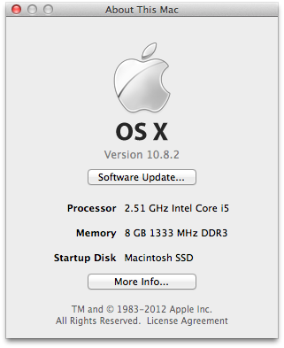

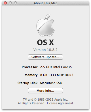

I have just noticed that my sound gets fuzzy after 2-3 seconds and progressing (in fuzziness :)). on newer clover r1063 an up builds. I guess the "bus speed mistake" or "decimal multiplier format" broke something.
update: Yes the CPU speed is not right
Clover r1050 --> post-112035-0-52317200-1359847061_thumb.png Clover r1071 --> post-112035-0-47202800-1359847073_thumb.png
update2: EFI/misc/system.log

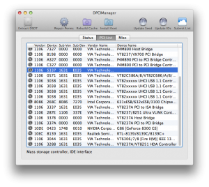

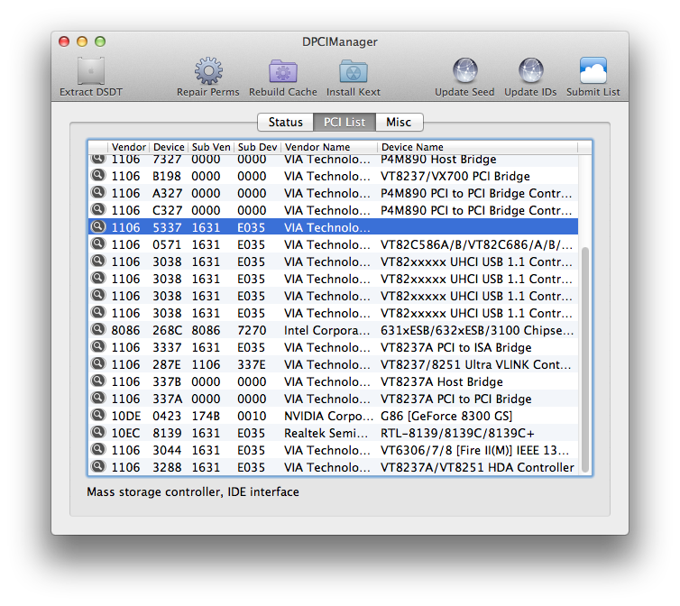

I just tested r1050 on my Packard Bell (non-efi legacy BIOS).
It works fine when I point it to my USB installer stick and much faster than Chameleon once the efi boot has loaded.
I only have one issue:
The VIA SATA controller...
My PATA controller is recognized just fine but I can't say the same for SATA.
It only supports IDE mode (not AHCI)
Are there any efi modules available I could use to get it working?
I noticed it was much better than Chameleon so I want to change to Clover V2 (nice work btw)
Please let me know...

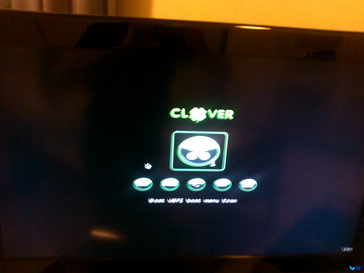

I put the boot7 on the EFI partition and the USB stick.
Reboot, press 7
Now it shows the loading cursor and I have to wait.
Should this take long?
The HDD indicator is full on.
Went to smoke a sigaret.
I'll check in a few minutes... and report back
EDIT: I just checked and it does see my "EFI harddisk" (in the storage manager)
Now lets hope it loads up Clover fine... and that Clover can see the ML partition...
A bit slow atm but acceptable if it works...
EDIT2: no luck... with the USB stick.
It eventually loads up Clover but no succes in showing the SATA HD
Testing now with boot from EFI partition on my HD...
Damn... back in the menu with continue, etc.
No luck...
EDIT3: changed the config once more and booting from USB stick... still no luck.
Gonna post picture and preboot.log in a minute...
Here it is ...

Thus my DVD drives are found however..
My SATA is not found.
Also not in the pci list... :o
Some info on it:
Device ID: 0x5337
Vendor ID: 0x1106
Got a picture also from DPCIManager
EDIT: gonna put an IDE drive in the computer and see what happens when I put os x on it...
preboot.log.zip

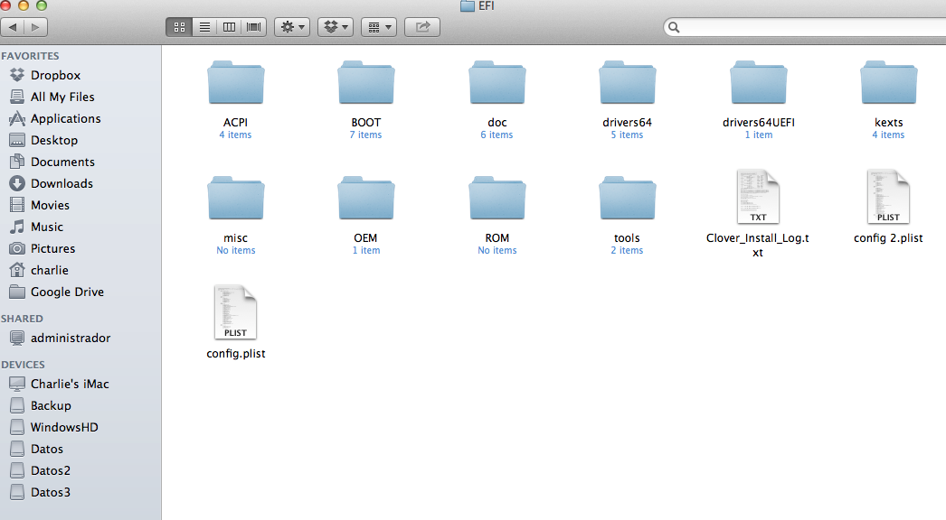

I don't know what happens. I had the boot.log before but it wasn't updating since r980. I deleted it to see if it regenerates again and I did not.
I have systemlog in refit.conf and I can't find a log in /EFI/misc/ nor /.
Clover is installed in the OS X partition of my SSD. My specs are on my signature.
Cheers!
@el_charlie:
For the systemlog to appear, the /EFI/misc folder must be present. It isn't created automatically.
I hope that solves at least this issue.
I do have that folder. It was created automatically because I didn't make it.
See:
Cheers!
Guys, I read that clover supports native resolution. How do I set it to start and boot in 1920x1080?
You'll need to know your VESA modes for your graphics card. If it doesn't support it, you can patch your VBIOS on the fly in config.plist for nvidia cards.
I did this for my GTX 560Ti:
<key>PatchVBiosBytes</key>
		 <dict>
				 <key>0</key>
				 <dict>
						 <key>Find</key>
						 <data>NC0nKJAroL+cj5a5jh8AAAA=</data>
						 <key>Replace</key>
						 <data>Fg7vn4/9AmM7N8/rQADBJAI=</data>
				 </dict>
				 <key>1</key>
				 <dict>
						 <key>Find</key>
						 <data>KAAZACgYCAgF</data>
						 <key>Replace</key>
						 <data>gAc4BPBCEAcF</data>
				 </dict>
				 <key>2</key>
				 <dict>
						 <key>Find</key>
						 <data>gg8DAQAACAQUAAAIFw==</data>
						 <key>Replace</key>
						 <data>TQEDTQEIASDAA///IA==</data>
				 </dict>
				 <key>3</key>
				 <dict>
						 <key>Find</key>
						 <data>QAa6sAQ=</data>
						 <key>Replace</key>
						 <data>gAe6OAQ=</data>
				 </dict>
		 </dict>
That added 1920x1080 in four matrices of the Video Bios. More info at ProjectOSX forums.
If you have an UEFI motherboard, you'll need a driver called CsmVideoDxe-64.efi.
Cheers!
PS: I forgot, the setting of the resolution is in the refit.conf file.
That worked quite nicely. Clover and boot screen are now using the correct resolution.

So, anyone has an idea why I can't get a boot log in EFI/misc????
I do have that folder and no luck. I even have HFSplus.efi in drivers64 folder. I thought Clover couldn't write in the HFS partition so I added that driver.
Cheers!
Open terminal and give rc.local and rc.shutdown.local the right ownership permissions...
sudo chmod 644 /etc/rc.local
sudo chown root:wheel /etc/rc.local
sudo chmod 644 /etc/rc.shutdown.local
sudo chown root:wheel /etc/rc.shutdown.local
and you need to set path for it ( open rc.local with text editor ) where to save the log
It was there the whole time!!!!
It was creating the logs in /Library/logs/CloverEFI!!!!
I edited rc.local and now it creates them in /EFI/misc.
Thank YOU!!!
Now, I only ask for 2 little things: 1. Is there a way to rename the partitions displayed in the GUI? and 2. How can I tweak the RAM speed displayed in System Profiler????. It says 1333 but I have my RAM at 1690 in the BIOS (and it's detected as such in WIndows).
Cheers!
Thank YOU!!!
Cheers!
de nada... :wink2:
1. Clover takes the name of your partition as you named it, AFAIK there's no flag to change that...
2. RAM is autodetected... tbh i have no idea about that
Edit: spelling
de nada... :wink2:
Edit: spelling
Yes, about number 1: It works fine with HFS Partitions. It detects the name fine, but with NTFS volumes it places a dot as a name, for example it says "Boot Windows from ." In Chameleon the volume names were detected fine and I could even rename them, because in my case, I boot windows from the "System reserved" partition and I renamed it within Chameleon to look fine and also hid the other non boot volumes.
About numer 2. There should be a flag to set the RAM speed like the Bus speed in config.plist. I also had to set that because it was detecting the stock speed of my CPU and I have it overclocked.
Cheers!
