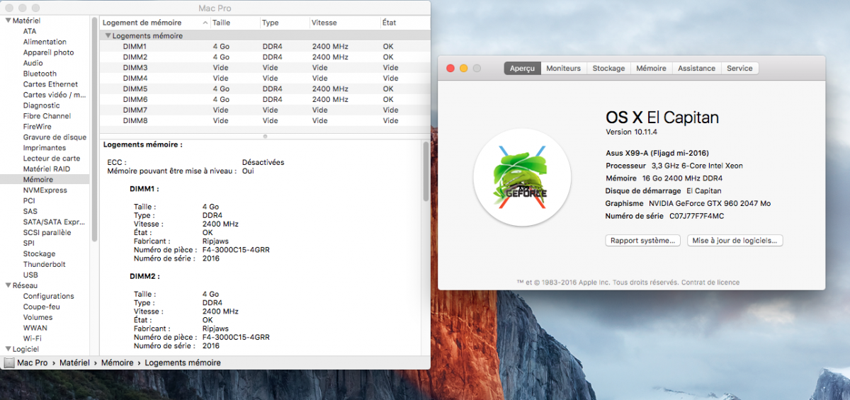

Good evening,
I use Clover 3489.
It does not indicate:
  the memory in DDR4
 the manufacturer

I am surprised
thank you for your explanation

Good evening,
I use Clover 3489.
  the memory in DDR4
 the manufacturer

I am surprised
You shown only a part of boot.log where Clover read data about installed DIMM from SMBIOS, i.e. from DMI written by your BIOS.
Don't wonder this is not full information.
Next step is read SPD to find details. As well read XMP profile.
If none of these method works then you can write all data manually into config.plist.
Hello,
Here is the full log

I am aware of the possibility of returning the information in the config.plist
I asked myself the question because of the next patch 3487 support for DDR4
Thank a lot
