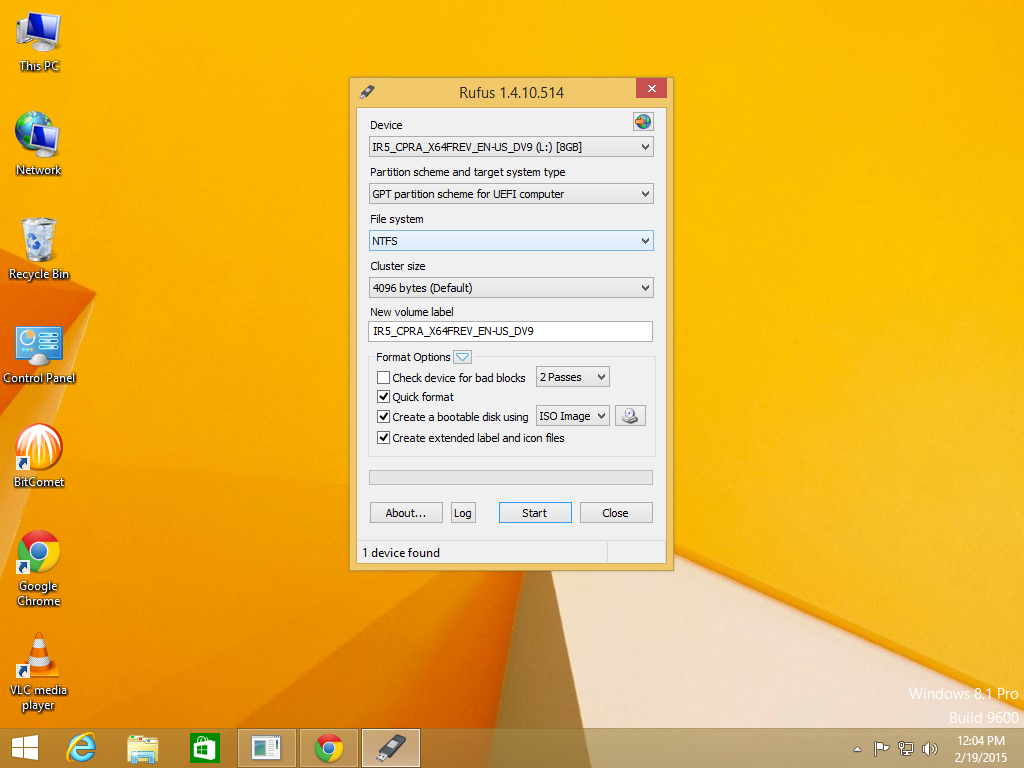

liujianwei Posted February 23, 2015 Share Posted February 23, 2015 for locating bootmgfw.efi open install.wim with 7-zip and navigate to Windows\Boot\EFI\ bootmgfw.efi ... now for this error IMG_20150220_011416.jpg download Rufus and set to GPT for UEFI Computer , FileSystem=NTFS see screenshot Screenshot (1).png now copy bootmgfw.efi to efi\microsoft\boot and rename cdboot.efi to cdboot.BAK try to boot with bootmgfw.efi using Clover EFI , i have successfully installed this .. Good luck The error might be due to the fact that the Windows installer is detecting other drives/windows installations and wants to do a startup repair. When installing Windows, it is good practice to temporarily disconnect all the hard drives except the target hard drive you want to install on eg in your case, if you want to install on disk0, disconnect disk1&2 leaving only disk0 and your UEFI Windows installer plugged in. Re extracting bootmgfw.efi: Use 7-zip in Windows, open install.wim navigate to sources/install.wim/1/Windows/Boot/EFI/bootmgfw.efi and extract bootmgfw.efi. Place in the /efi/microsoft/boot folder of your UEFI Windows USB (& rename cdboot.efi to cdboot.BAK as described in post#6). Some legacy BIOSes won't boot from a pure GPT USB (not a problem for Clover booting of pure GPT hard drive though). If this is the case with your system, you can either remake the USB installer with MBR instead of GPT or boot Clover installed on hard disk 0 to start bootmgfw.efi on the UEFI Windows installer. Seems like my computer is not Microsoft friendly,Windows 7 wake up from sleep,system stuck and slow,change windows 7 hdd to SATA port 1 problem solved,GDisk convert Hybrid MBR to GPT,I cannot convert back,I'm very regret to use Windows 98 ME 2000 XP 7 8 8.1 10 and Xbox 360 Controller and Sidewinder mouse. Link to comment Share on other sites More sharing options...
