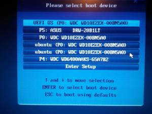

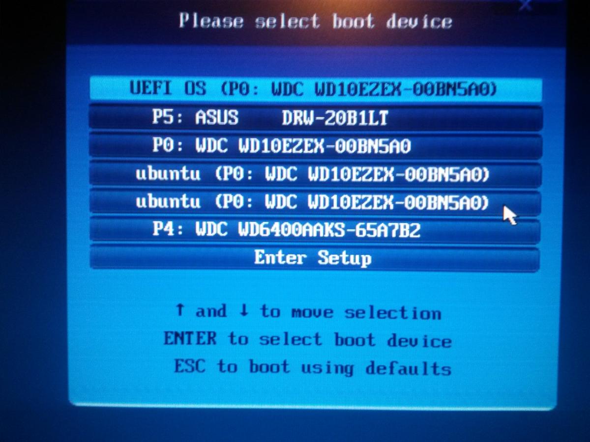

Hey guys
I accidentally installed GRUB2 (during an Ubuntu installation on another drive, /dev/sdb) on my Yosemite drive (/dev/sda), having already Clover as bootloader there (installed in the ESP). So now, in EFI, I also got a /ubuntu folder, which, on the boot drive selection screen in Clover, translates into Ubuntu being one of the items to choose from (the default one).
So...I removed (actually just moved away, as a precaution) the /ubuntu folder from there, and the item disappeared from the drive selection screen in Clover, which I think it's normal, since it falls back to the next bootable drive, which in this case is Mavericks, and Yosemite.
So now it doesn't show up in the drive selection screen anymore. And that's ok, cause I'm trying to get rid of it anyway, since installing it in the first place, was a mistake (or should I say an Ubuntu installation bug.)
Anyway, the thing that still bothers me, and I'm not really sure how to fix, is this: in the boot menu (when pressing F12 on a Gigabyte motherboard), I've still got ubuntu listed (twice, for some reason). How can I safely remove it from there?
Hey guys
I've teste a lots Installer and I have always full Entry on my Z87X-UD5H
 My only  solutions is flashing bios
@arsradu,
Try efibootmgr utility under linux or EasyUEFI under Windows.
Good Luck!
That worked beautifully! THANK YOU!
I used the efibootmgr utility (which needs to be installed separately, but that was not a problem) and folllowed the guide. And even though, at some point, when it said that I need to use a "combination of -b and -B" to delete the ones I don't want, I was kinda like "ook, but how do I know which combination is the right one", I just replaced the item he used in his example (3), assuming that this way he was intending to remove the item 0003, with 0 for my case. And everything was ok. Then I did the same for my second case (which was 000A). So "sudo efibootmgr -b A -B". And that's it. :)
And now I also found out why there were two ubuntu items in my list. They were pointing to different efi files in the /ubuntu folder. ;)
So again, big thank you! That was a lot easier than I thought was going to be.
