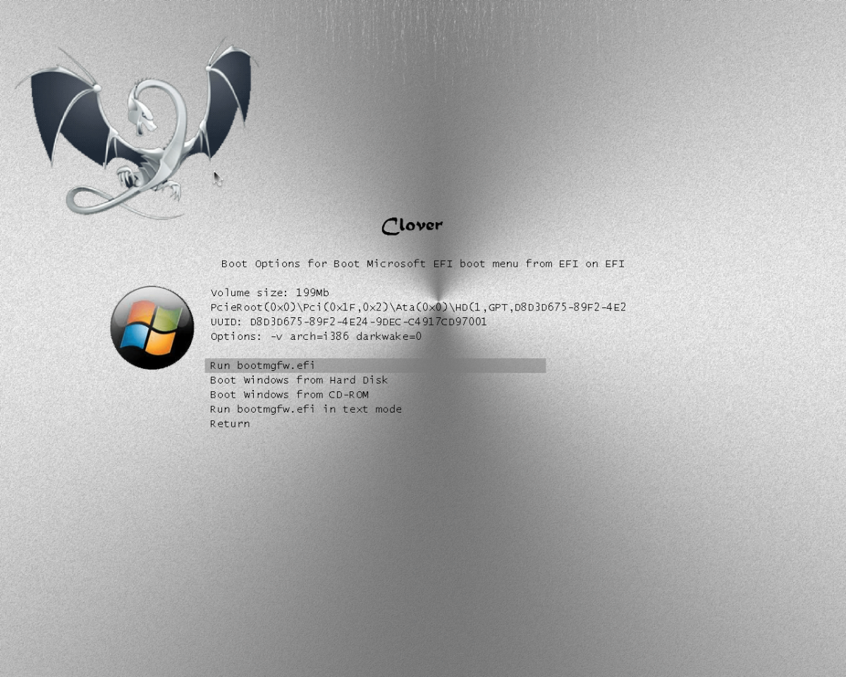

@frankiee - are you using VboxHFS.efi? if so that may be the problem on 2988-2990 (haven't tried later). it wouldn't boot for me.  + adds a bogus windows entry. i replaced with HFSplus.efi and all was fine. i reported a similar problem a few posts back.
Another thing, Clover installer overwrites Windows UEFI bootloader (EFI/Boot/bootx64.efi) when installed to the EFI partition. (I'll assume that this is to maintain compatibility with older firmwares).
Yes, overwrites.
I found that Windows-EFI has two way to boot:
/EFI/boot/bootx64.efi
/EFI/microsoft/boot/bootmgfw.efi
So leave first one for Clover boot by default and second one to choose Windows from Clover GUI

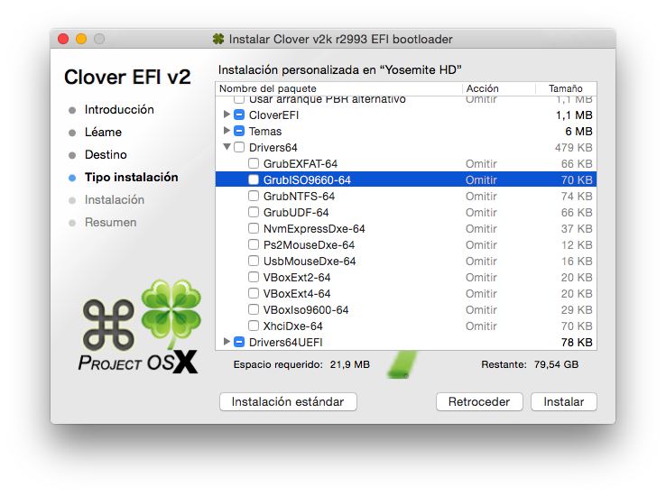

Today i found out that clover does not detect any cd placed on my drive so i changed drive but the same result.First tried two versions of diskwarrior then a 10.6.7 SL and a windows 8 64bit.None of them appeared in the gui.
attachicon.gifboot-r2986-2014-11-02-03.58.07.zip
Since 2986 you need to install the ISO9660 driver for CloverEFI.
