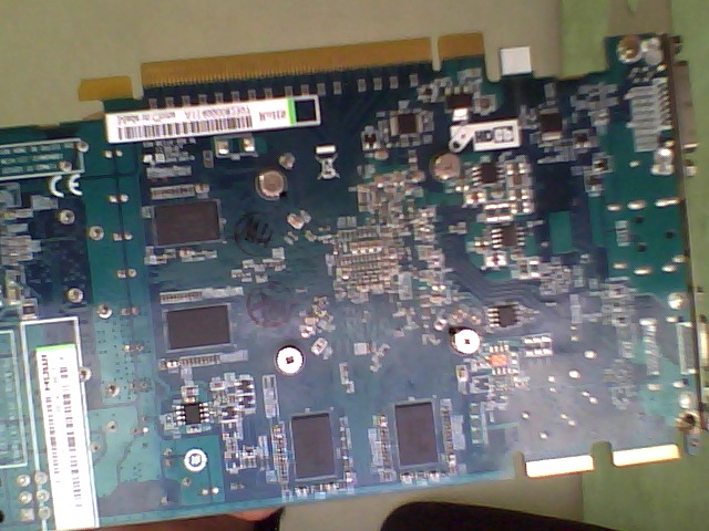

I think it was this one !
Posted Image
#9
Thunderbolt
Thunderbolt
Is that a 6750 or is that your card ?
#10
fantomas1
fantomas1
    InsanelyMacaholic
  • Supervisors
  • 4,344 posts
  • Gender:Male
I typed HD 6750 and it gave me this !
my HD 6770 don't have the chips with vertical pin
edit :
i think it's a Sapphire HD 6770 FLEX - 1 Go
Ah ok. At least its on the back and don't need to remove the fan.

Can you give us a screen of your graphics card's pcb ?
#20
Thunderbolt
Thunderbolt
    InsanelyMac Geek
  • Members
  • PipPipPipPip
  • 244 posts
Will do once I reach home as I am @work
