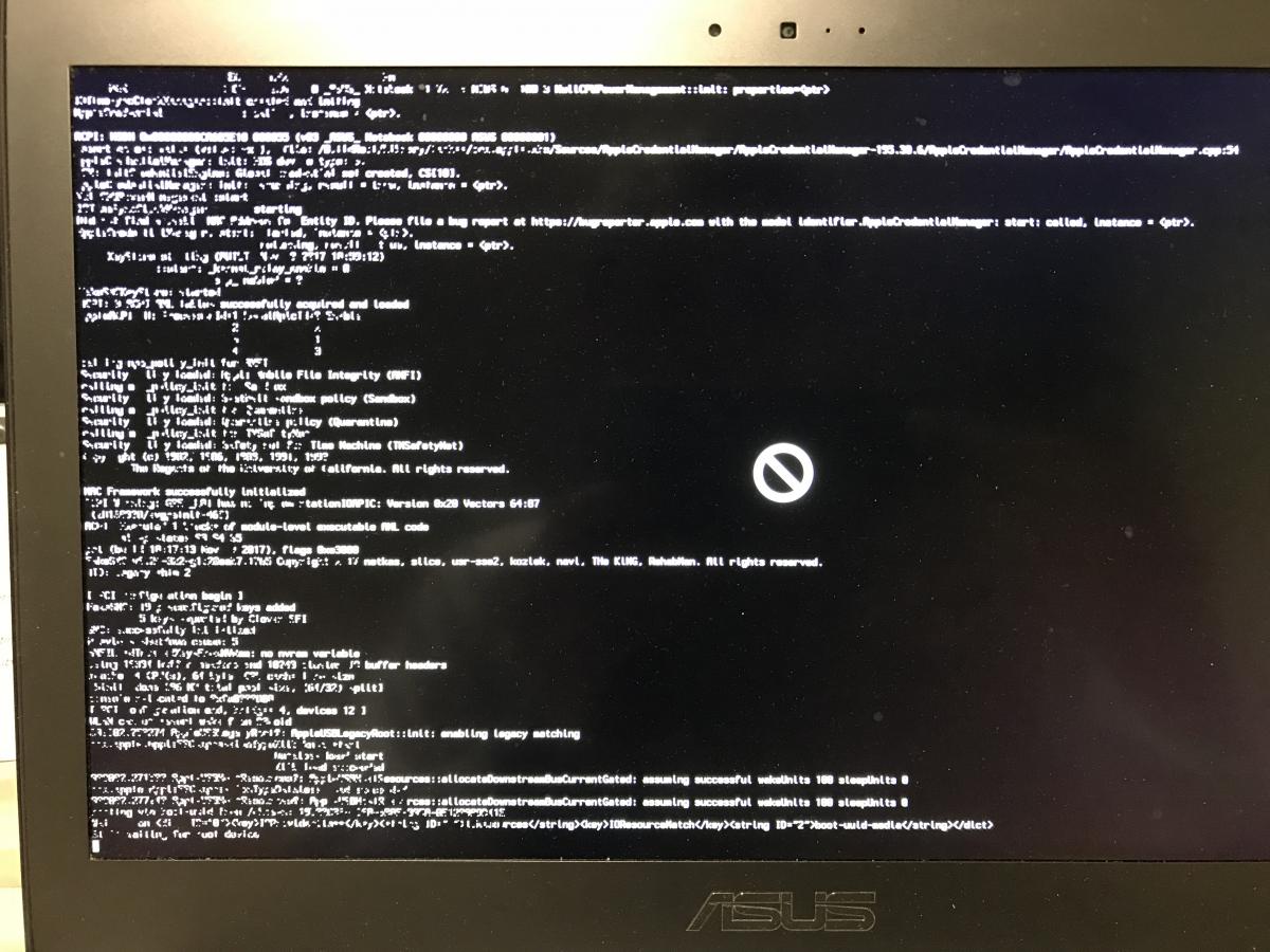

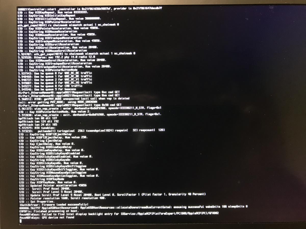

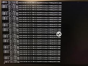

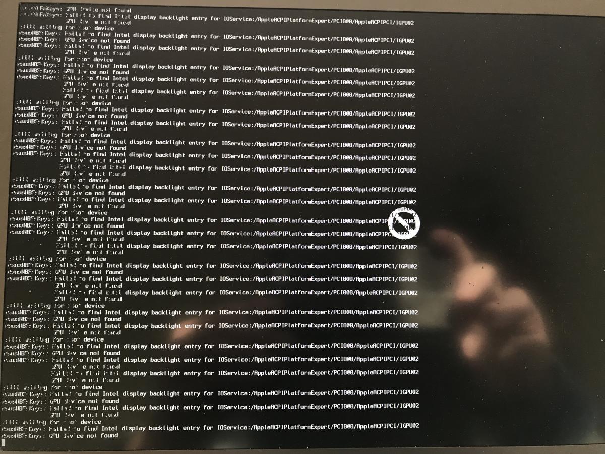

@pavn : I also get the last two lines, not finding the GPU device.
I looked at the the rest of your screenshot. Again. I have the same information and boot continues fine.
You may try to disable EHCI[Edit: XHCI] in Bios and to unable USB2 Legacy only.
You may try to use the clover files I posted & copy the 10.13 kexts to the 10.12 Clover directory for Sierra instead of High Sierra.

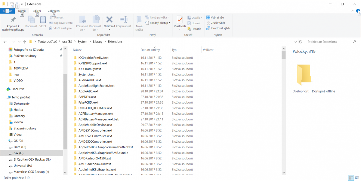

Here is a screenshot to System\Library\Extensions of latest updated/added kexts after update.
Could some of it cause a booting issue? See the attached screenshot.

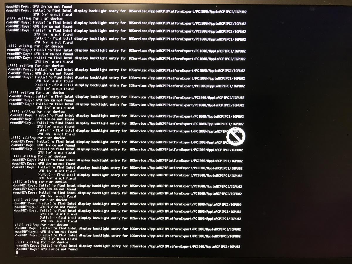

After some time it displays a message: "Still waiting for root device".
PS: How to "disable EHCI and to unable USB2 Legacy only"?
I will try your clover files you posted and copy kexts to 10.12 as you suggested.

@pavn
1. My first recommendation would be to install High Sierra directly with a USB stick.
In my case, I did not install Sierra. I tried to boot high Sierra with a USB stick and it worked right away. I therefore installed High Sierra directly.
2. To disable USB3 :
F2 to get to Bios. Then set XHCI to disabled and USB2 Legacy to Enabled.
Before using SSDT-UIAC-UX31A.aml (in Clover Acpi Patched) I was not able to get USB3 working.
For example, when XHCI was set to auto or enabled, boot would be stuck at USBLegacyRoot0
You may try that at least to boot all the way.
3. AsusNBFnKeys.kext
You may remove this kext from Clover kext Other. You may also remove IOath3kfrmwr.kext if you don't have a Bluetooth device. A least you may get a better understanding of the problem.

Hi Rom1,
Thanks for suggestions.
I created High Sierra USB installer and I am trying to boot, but it seems to have the same booting issue as 10.12.6 Sierra. I am not able to boot it even with your Clover folder. Or it crahes also.
I also tried to remove AsusNBFnKeys.kext from kext directory in Clover. It did not also help to solve booting issue.
I have legacy USB support enabled in BIOS.
I have Asus Zenbook UX32VDA.
