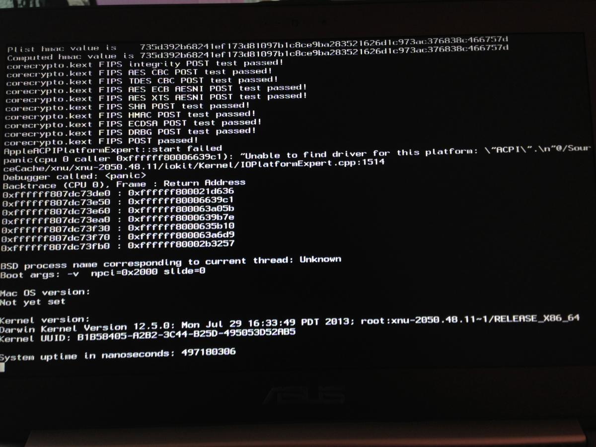

Hello everyone. I have ASUS Zenbook UX31A (late 2012, so new model) with i5-3317U and bios version 218. I have made USB with Clover bootloader and succesfully installed Mac OS X 10.8.5. I dont use any DSDTs and SSDTs because I get error(panic) on boot (see attachemnt). The minimal set of kexts for me to boot is NullCPU, AppleIntelCPUPWM and FakeSCM. I have tried nhart's DSDTs, SSDTs and kexts but I get the same error. Also I have tried DSDTs and SSDTs from other people. Audio, speakphone and FN keys, SpeedStep dont work. Intel HD4000(time to time lags) and shutdown work bad. And not sure USB 3.0 is working.
I have attached my Clover's folder, ioreg and photo of boot console.
Options in BIOS which I changed:
- Legacy USB support Enabled
- XHCI Pre-Boot Mode Disabled
- Fast Boot Enabled
- Launch CSM Disabled
- Secure Boot Control Disabled
What to do? Who can share DSDTs, SSDTs and kexts for BIOS 218? Thank you

Remove the npci=0x2000 bootflag, I will be tweaking my guide to work with just a modified DSDT.

It's ridiculously easy now to create a USB installer. Use myHack and use a patched DSDT.aml.
Most notable thing to do is:
- Disable USB 3.0 in the bios
- Make sure that you aren't use ANY npci=0xXXXX flags.
- Boot with verbose (-v)
Yeah, so I did that but i'm stuck on with an eternal beachball that never goes away.
Can't get further that that no matter what I try..
Any hints are welcome :)

Here are more observations in my attempt to install 10.9 GM.
- Even though my 219 BIOS is patched, removing NullCPUPowerManagement.kext causes KP in AICPUPM.. If I used the AICPUPM from the first page of this thread, the KP goes away. I was under the impression that using patched BIOS prevents KP when using original AICPUPM... Either this is no longer valid with 10.9 or i'm missing something else.
- I literally had to use a cocktail of extensions present in the first post of this thread to get the OS X installer to start up. I then managed to install OS X but I believe i made the mistake of telling MYHACK to use the /Extra folder on the USB key for the HD installation of OS X. Because of this, I can only boot the installed OS X with the -X switch otherwise, it will boot up and I will be stuck with a grey backround screen
68x or anyone who has managed to install 10.9, can you give me a list of extensions that you used to start the installer and then to boot up 10.9 ?
Thx,
Adi
Thx,
Adi
What are you using to patch the BIOS?
Already posted:
The steps are the same for 10.9.
Already posted:
I used PMPatch over here : http://www.insanelymac.com/forum/topic/285444-pmpatch-uefi-patching-utility/
I posted the flashing method earlier. I don't understand how come I still need AICPUPM after having the flashed patched BIOS..
As for the steps, i followed them but I'm not getting very far after that. I can't boot into the OS X installer with -V or with anything for that matter.
I only managed to boot in the installer by using the kexts on the first post of this thread, hence why I think that I must be missing something.. Do you have a list of your current good working and needed kexts for 10.9 ?
Thx for your input,
Adi
