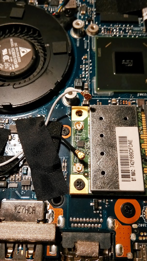

In attachment is picture of my AR5B195 WiFi card and modification.
All works like a sharm!
Also i have use tape, like seen in youtube video.
Great mod, tried and work like a charm. Thanks!

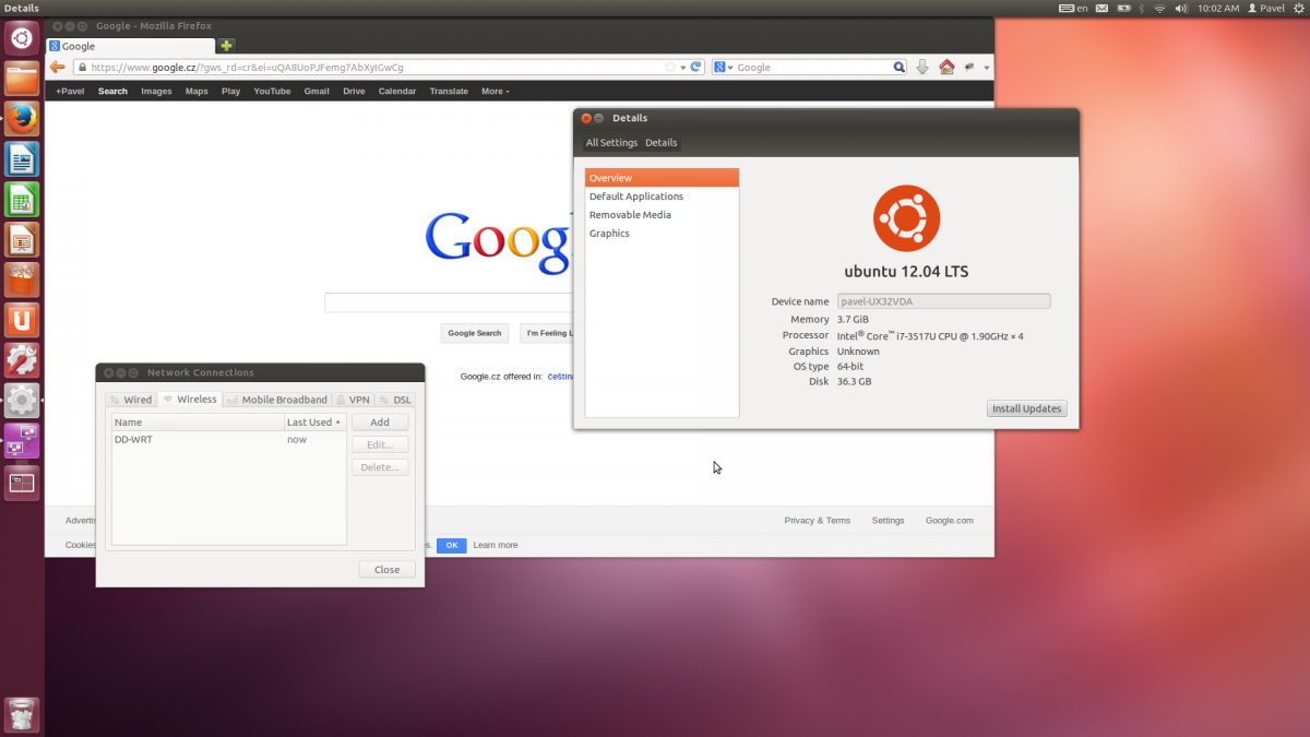

I just tested Zenbook UX32VD in Linux Ubuntu 12.04 LTS. And there seems to be Intel Wifi card working perfectly! I simply surfed Internet. See the attached screenshot. Would not be possible to take the Linux Intel Wifi card driver source codes, if there are available and to port the Intel Wifi card driver to OSX86?
