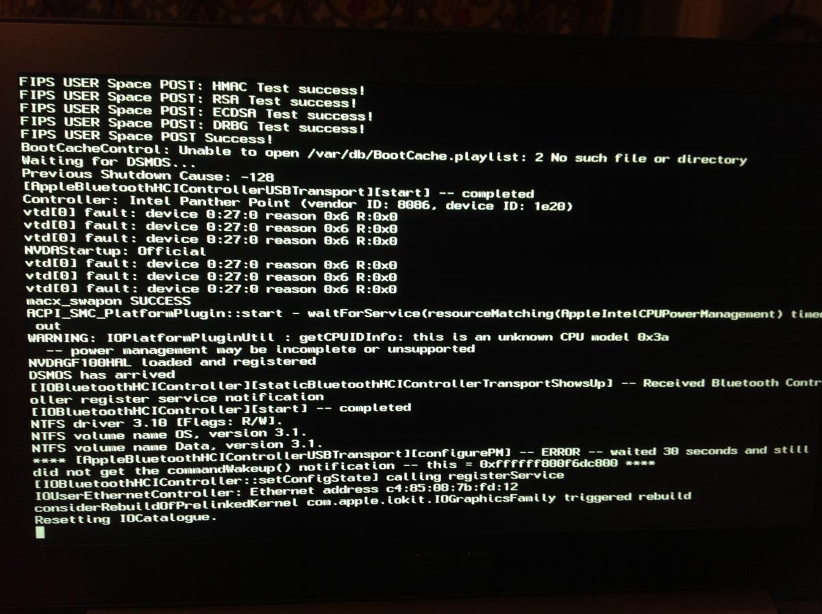

pavn Posted July 13, 2013 Share Posted July 13, 2013 Thanks, let me test now. Will be back soon with results... xhci preboot mode needs to be disabledI was able to get here, now it is waiting again. Will try boot with -x if it will help. xhci preboot mode needs to be disabled Link to comment Share on other sites More sharing options...
eviltweak Posted July 13, 2013 Share Posted July 13, 2013 When I had that issue i turned off xhci and i booted with GraphicsEnabler=No and it booted first try Link to comment Share on other sites More sharing options...
pavn Posted July 13, 2013 Share Posted July 13, 2013 It is waiting here now. With xhci disabled and i marked GraphicsInjector in options menu in clover boot menu, if this is what you mean? When I had that issue i turned off xhci and i booted with GraphicsEnabler=No and it booted first try Link to comment Share on other sites More sharing options...

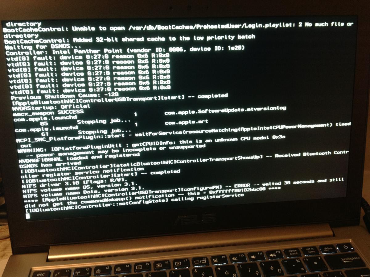

pavn Posted July 14, 2013 Share Posted July 14, 2013 It looks to me that Bluetooth is causing the issue, what is your opinion? I don't know what to tell you, maybe someone else can chime in? I am actually having problems of my own right now. I got my wireless card and installed it and everything went well. I used it for a day or two then i updated f.lux and everything went wrong. f.lux wouldn't boot any longer. My finder then went into a crashing loop and I then deleted flux and all of its contents and it was all good for a day. And I was using my mac today and finder crashed once again and this time i can not open anything. No system preferences nothing. Could it be caused by the wireless card that I installed? That is the only thing that makes sense to me at this point. Link to comment Share on other sites More sharing options...

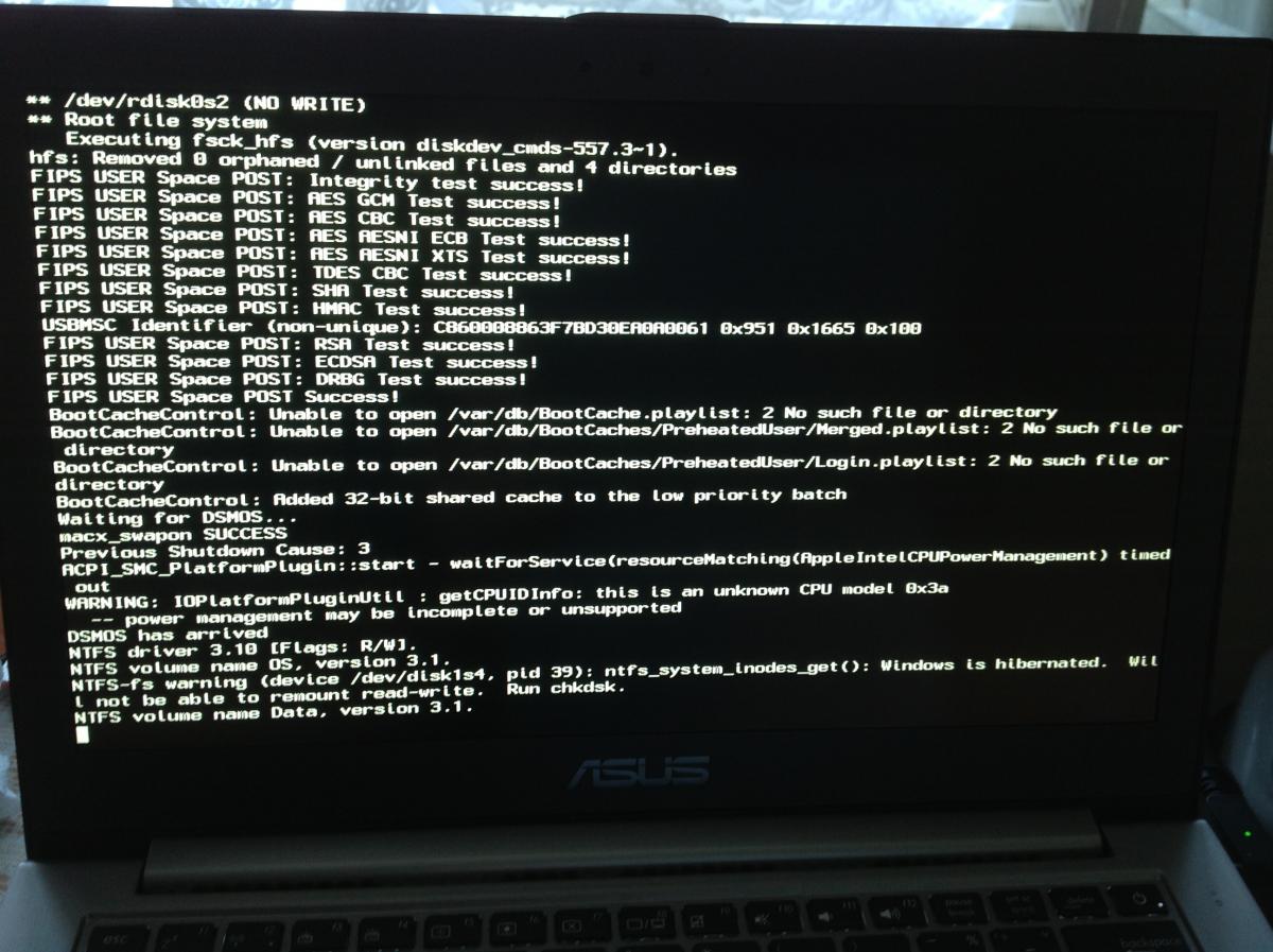

pavn Posted July 16, 2013 Share Posted July 16, 2013 I tried to play with it according on tips from this forum and now Bluetooth issue is not displayed. But still OS X does not boot. See the screenshots. It waits here. Just a note, that it is not frozen, but it does not boot. Keyboard reacts - allows to type something but it is not command line. And if trackpad is touched, then it writes ApplePS2Mouse: Unexpected data from PS/2 controller on screen. Any tip, please? Link to comment Share on other sites More sharing options...
pavn Posted July 17, 2013 Share Posted July 17, 2013 I was able to boot Mac OS X finally. Now trying to tune things... I tried to play with it according on tips from this forum and now Bluetooth issue is not displayed. But still OS X does not boot. See the screenshots. It waits here.Just a note, that it is not frozen, but it does not boot.Keyboard reacts - allows to type something but it is not command line. And if trackpad is touched, then it writes ApplePS2Mouse: Unexpected data from PS/2 controller on screen.Any tip, please? Could you tell me what is this PCI card, please? Link to comment Share on other sites More sharing options...

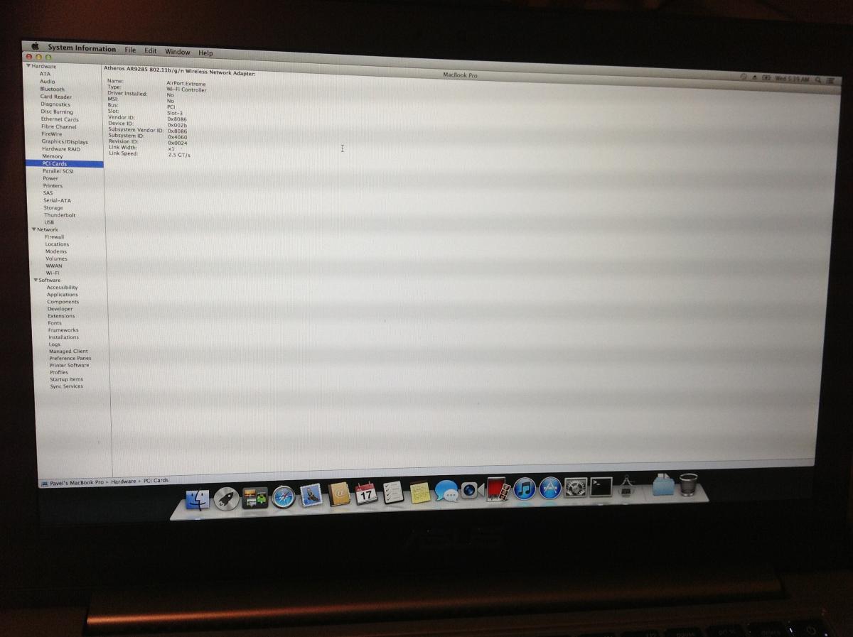

pavn Posted July 17, 2013 Share Posted July 17, 2013 Do you think that my zenbook contains Atheros AR9285 802.11b/g/n Wireless Network Adapter? Or is it reported not correctly? Link to comment Share on other sites More sharing options...
adisor19 Posted July 17, 2013 Share Posted July 17, 2013 Do you think that my zenbook contains Atheros AR9285 802.11b/g/n Wireless Network Adapter? Or is it reported not correctly? You're using a DSDT posted in this thread that is modified for a different wifi card. No, your Zenbook does not have that card. You can buy it off e-bay for 8$. + another 5 $ for internal wifi antennas since the connectors on the integrated antennas on the zenbook are not standard. Adi Link to comment Share on other sites More sharing options...
pavn Posted July 17, 2013 Share Posted July 17, 2013 Aha. Does such card contain also Bluetooth 4.0? You're using a DSDT posted in this thread that is modified for a different wifi card. No, your Zenbook does not have that card. You can buy it off e-bay for 8$. + another 5 $ for internal wifi antennas since the connectors on the integrated antennas on the zenbook are not standard. Adi Link to comment Share on other sites More sharing options...

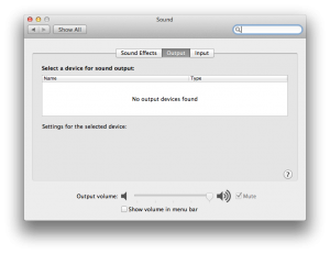

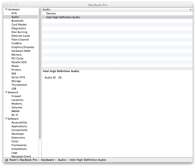

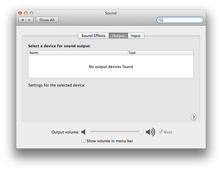

pavn Posted July 17, 2013 Share Posted July 17, 2013 Just trying to get audio to work, it somehow does not work automatically with phelics12 kexts. I see audio here. But I do not see the audio here. Link to comment Share on other sites More sharing options...

adisor19 Posted July 18, 2013 Share Posted July 18, 2013 Aha. Does such card contain also Bluetooth 4.0? No. It supports Bluetooth 3.0 which is more than fine for the time being IMO. Just trying to get audio to work, it somehow does not work automatically with phelics12 kexts. I see audio here. But I do not see the audio here. Look in the thread for 68x kexts. He posted them and the audio works fine. All the extra kexts should always go to S/L/E if you wanna avoid problems. Sleep mode does not work. It goes to black screen than does restart of zenbook. Most likely you're missing the proper SSDT files just like me. Link to comment Share on other sites More sharing options...
