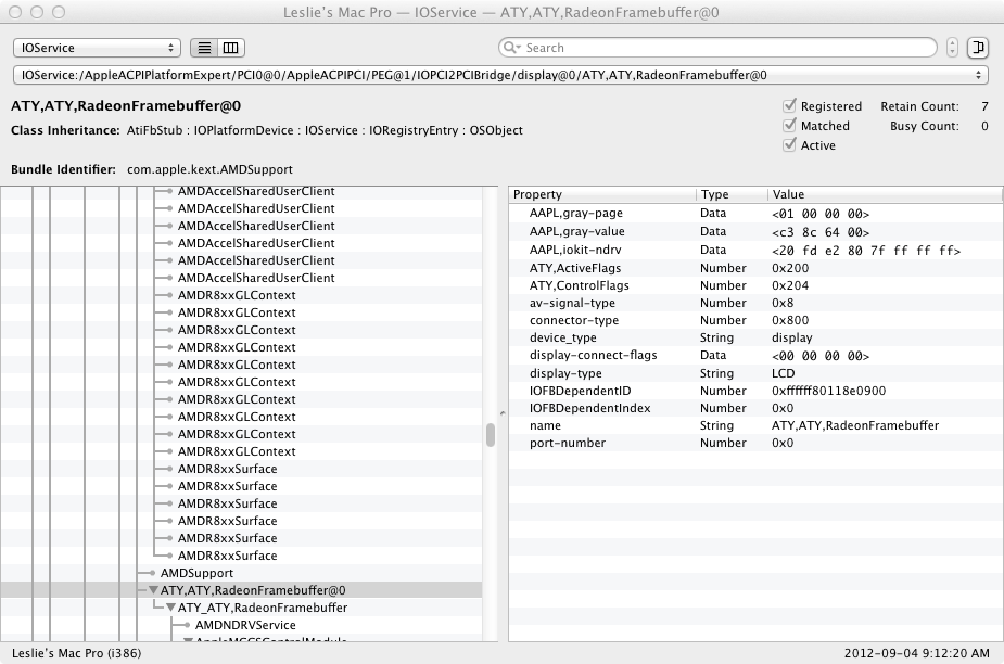

i use an hd5450 hdmi to tv...works fine, using GraphicsEnabler=No (gives me default framebuffer, ATY,RadeonFramebuffer)
Attached File  Tv on HDMI.png   93.95KB   23 downloads Attached File  IOregistry, ATY,RadeonFramebuffer.png   144.05KB   22 downloads
...i'm in the process of editing framebuffer personality, to get a match for my card outputs, as the hdmi outputs differ on my card from apple's...meanwhile this works for now as my sole display...
...the only personalities i see in the 5000 controller that include an hdmi port(stock) are Uakari, Baboon, Vervet and Eulemur

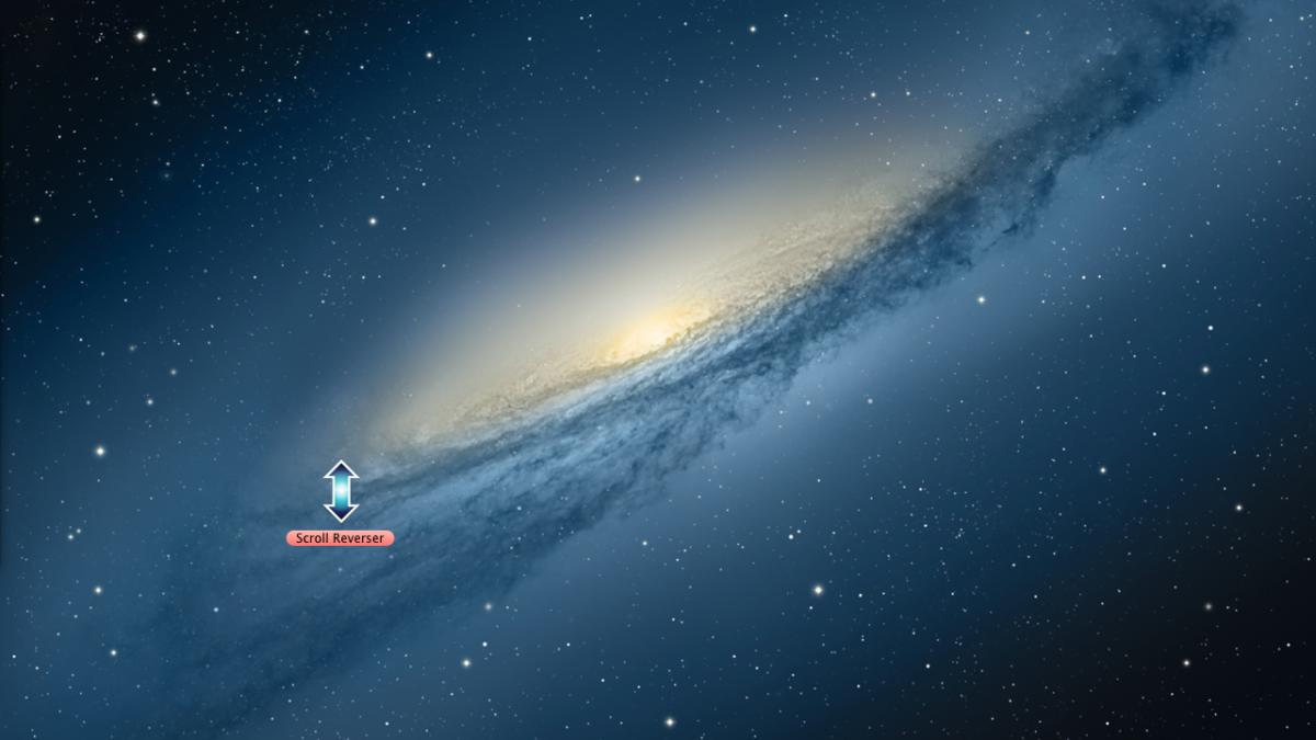

I tried like you said but just desktop background came into my tv. my tv has resolution of 1280 x 720 whereas my laptop has 1366 x 768. I succeed making a folder in a desktop but the folder wouldn't open. It seemed like those icons were stretched beyond the reach of mouse! I tried to change the aspect ration of tv but to no help. I will also try robertx method. let see. btw, have you tried the method you said to me.

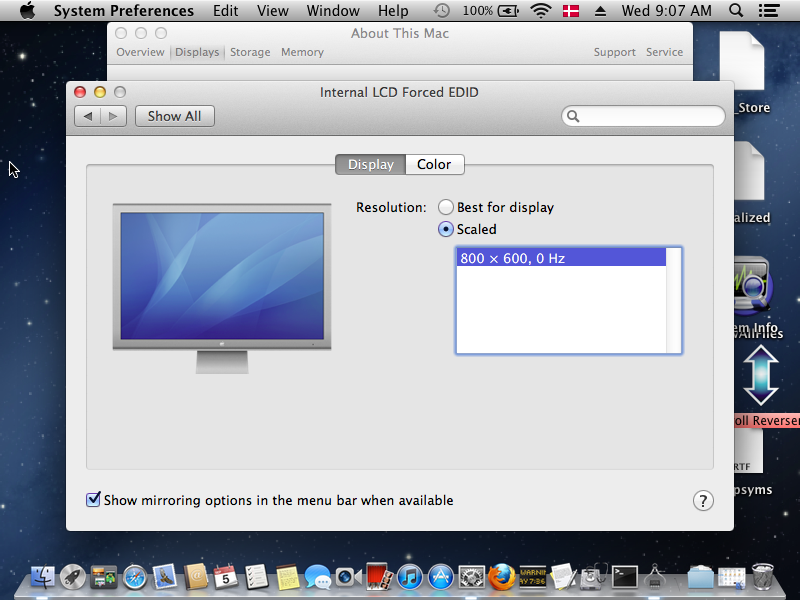

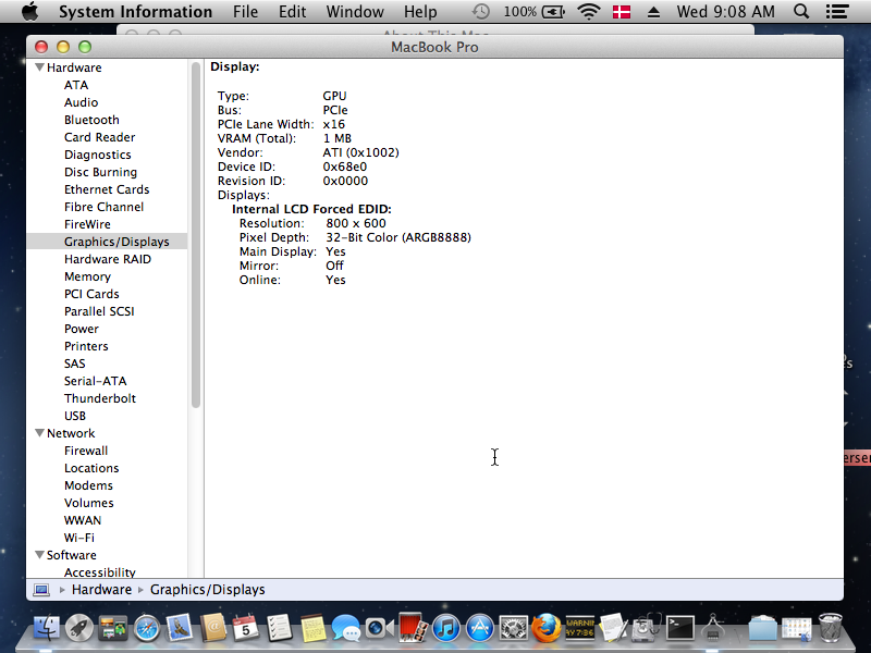

I tried it with GE=No. It successfully worked but the problem was I only got resolution of 800 x 600 with 1 mb of video memory. Apparently, I have Internal LCD forced EDID display otherwise I wont get reolution of 1366 x 768 or my card isnt recognised.

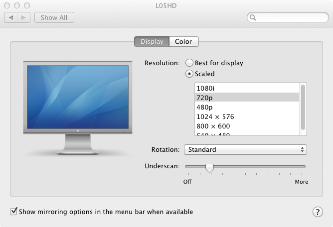

Artur-pt's idea is also working except icons arent visible (using framebuffer Langur). I think the problem is due to my resolution 1366 x 768 whereas my TV has resolution of 1280x720. May be I need to change the resolution of my computer to TV's before using HDMI to connect to TV.
Check the third pic, I mange to boot using AtiConfig=Langur to TV but no menu icons appear in the desktop. However, I managed to move my mouse out of visible desktop area and drag that 'Scroll Reverser' file to visible desktop area. looks like resolution issue.

...i guess my way isn't a go for you...apparently you require the GraphicsEnabler=Yes, as i see in the pics you don't have hardware acceleration(i'm on a desktop box... so no internal monitor to muddy things up...)sorry :angel_not:
