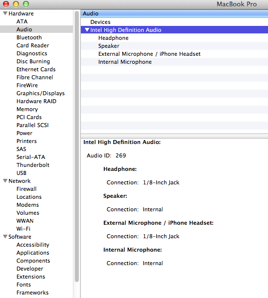

takeawaydave Posted September 5, 2012 Author Share Posted September 5, 2012 Yes thinking the same about buying a card from Ebay.... apparently this card is a BT / Wireless combo so might be harder. Any suggestions / links ? As for sound... I have been checking out this but unsure how to proceed when I need to "correct" the verb data. So far extracted the Pin Complex - any one able to correct or explain what needs correcting so I can proceed ? Extracted pin complex so far: Node 12 : f0 11 11 41 Node 14: f0 11 11 41 Node 15: 1f 10 21 03 Node 17: 20 01 17 90 Node 18: 30 18 a1 03 Node 19: 40 09 a7 90 Node 1a: f0 11 11 41 Node 1b: 10 01 17 90 Node 1d: 1d a2 06 40 Node 1e: f0 11 11 41 Node 14 EAPD : 02 Node 15 EAPD : 02 On the other hand if I can make PinConfiguration changes in DSDT HDEF can someone explain how the above related to that below DSDT HDEF: "PinConfigurations", Buffer (0x2C) { /* 0000 */ 0xF0, 0x11, 0x11, 0x41, 0xF0, 0x11, 0x11, 0x41, /* 0008 */ 0x10, 0x00, 0x13, 0x90, 0x40, 0x40, 0x21, 0x01, /* 0010 */ 0xF0, 0x11, 0x11, 0x41, 0x30, 0x90, 0xA1, 0x01, /* 0018 */ 0x50, 0x00, 0xA3, 0x90, 0xF0, 0x11, 0x11, 0x41, /* 0020 */ 0xF0, 0x11, 0x11, 0x41, 0x60, 0x80, 0x03, 0x40, /* 0028 */ 0x20, 0x00, 0x43, 0x90 } codec_dump.txt Link to comment Share on other sites More sharing options...

iFIRE Posted September 5, 2012 Share Posted September 5, 2012 see if DSDT fixes works for sound, delete your from extra and use this, reboot, if this not work you need put info from your codec.tx for infloplist of the AppleHDA.kext, you cam use TextMate editor SOUNDDSDT.zip post results!!! Link to comment Share on other sites More sharing options...
takeawaydave Posted September 5, 2012 Author Share Posted September 5, 2012 I used the new DSDT.aml and the provided AppleHDA v. 2.3 from yesterday but no banana ! What exactly is the edit required in Info.plist ? EDIT: Attached is screenshot from System INfo. Link to comment Share on other sites More sharing options...
iFIRE Posted September 5, 2012 Share Posted September 5, 2012 go for the post what you put the link here above ad download all files, and change layout28.xml and zlib.pl from folder resources AppleHDA, Backup your Link to comment Share on other sites More sharing options...

takeawaydave Posted September 9, 2012 Author Share Posted September 9, 2012 SOUND IS WORKING....That was a long slog. Working kext attached. Status: 1. Graphics working fine using HD4000 2. Sound good 3. Wireless Asus USB-N10 on order. Any one advice on getting AR9462 Wireless / BT combo going ? 4. Battery indicator working fine. 5. Ethernet RTL8111/8168B working however in order to get a connection cable must be attached from start up otherwise connection is not established ok. 6. Sleep working 7. Airdrop working AppleHDA.kext.zip 1 Link to comment Share on other sites More sharing options...
