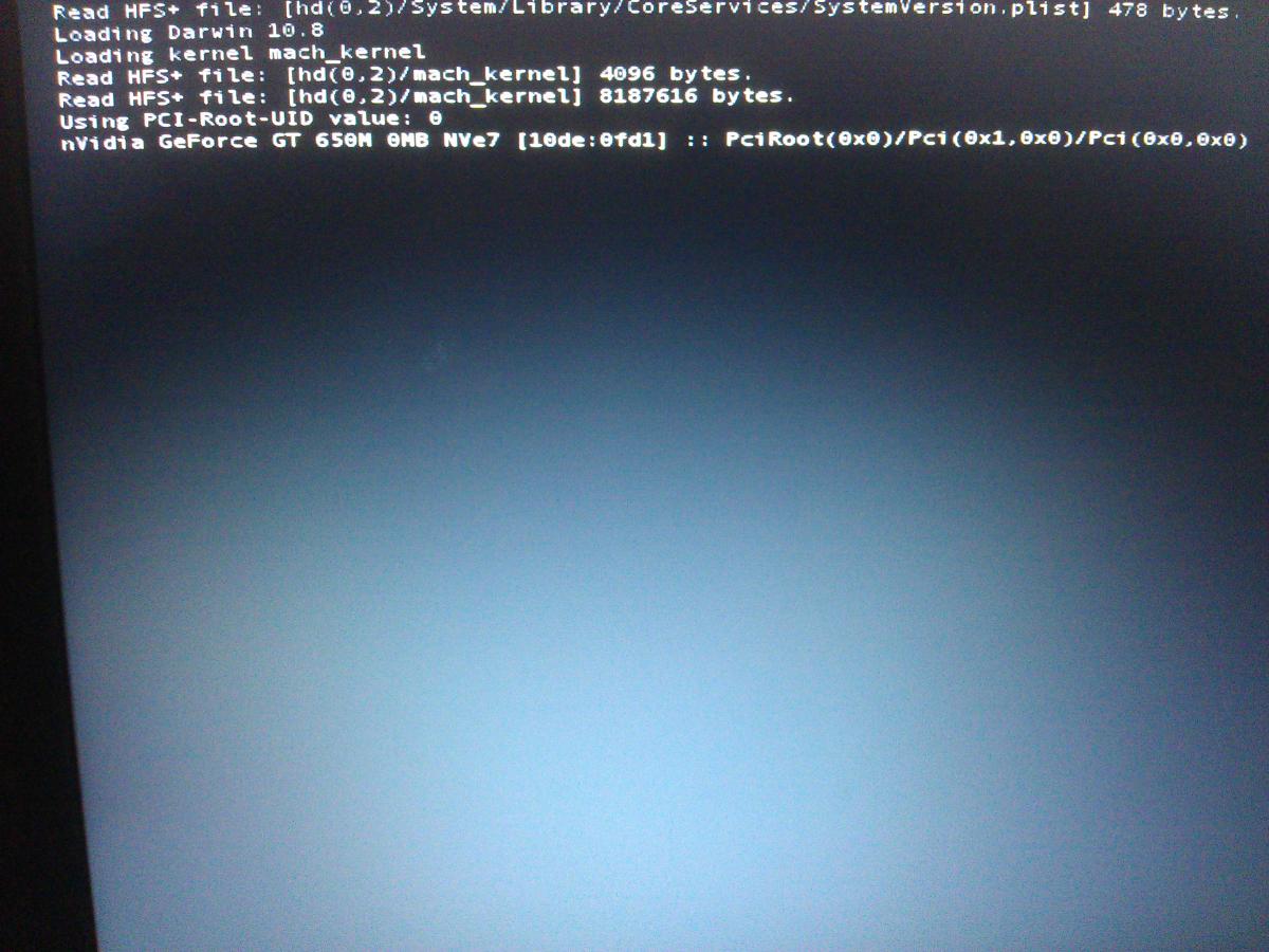

takeawaydave Posted August 30, 2012 Author Share Posted August 30, 2012 OK I have: Installed kexts from /E/E to /S/L/E using kext wizard and then repaired perms and rebooted. Still NO BANANA same error as before when booting using: -f -v GraphicsEnabler=No PCIRootUID=0 npci=0x3000 (tried this twice) Link to comment Share on other sites More sharing options...

iFIRE Posted August 30, 2012 Share Posted August 30, 2012 ok,try this boot flag: -v GraphicsEnabler=Yes npci=0x3000 busratio=23 Link to comment Share on other sites More sharing options...
takeawaydave Posted August 30, 2012 Author Share Posted August 30, 2012 no luck with those options. Link to comment Share on other sites More sharing options...
iFIRE Posted August 30, 2012 Share Posted August 30, 2012 ok, you have two GPU, HD 4000 AND nVidia GeForce GT 650M 2048MB THIS ONE i don't no if have support for ML, but HD 4000 have support and work, for now backup all kexts NVidia and delete from S/L/E , I go see one topic for this GPU. Edit: copy paste this cod ein terminal app and output in your desktop, put this a folder zip and poste here for me edit this perl -e 'open(CMD, "ioreg -lw0 \| grep DSDT|") or die; while(<CMD>) { chomp; if($_ =~ /\"DSDT\.?\d?\"=<([^>]*)>/) { $buff = $1; open(PIP, "|xxd -r -p > ~/Desktop/dsdt.aml") or die; print PIP "$1"; } }' EDIT: USE THIS: -v PciRootUID=0 GraphicsEnabler=No busratio=23 npci=0x3000 here the topic: http://www.insanelym...l=&fromsearch=1 Link to comment Share on other sites More sharing options...

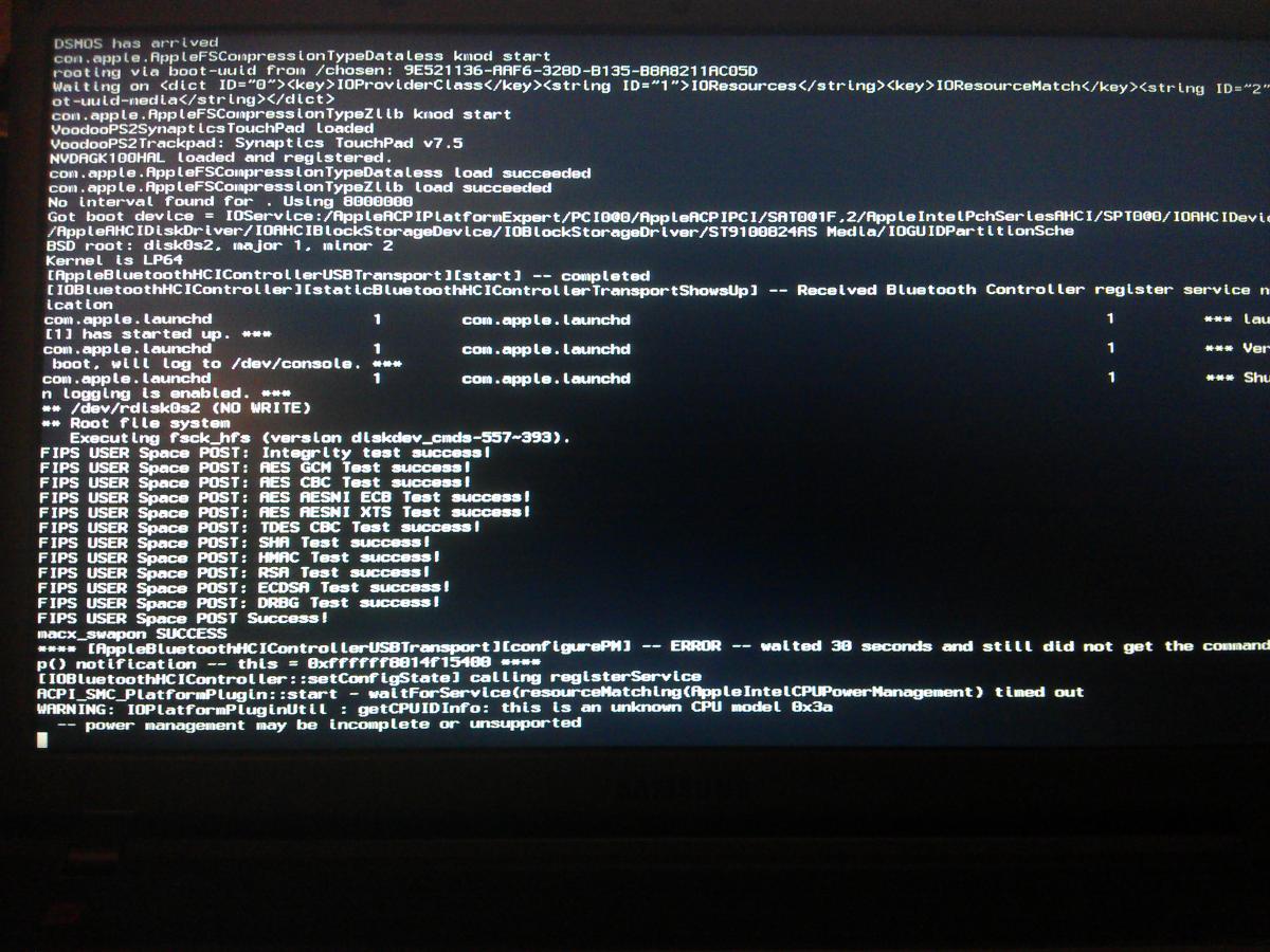

takeawaydave Posted August 31, 2012 Author Share Posted August 31, 2012 if u are referring to <key>HD4000PlatformId</key> <string>9</string> I put this in to org.chameleon.Boot.Plist... now I have a blank screen.... something almost worked... how do i get the right ig-platform-id ? trial and error approach at the moment... Link to comment Share on other sites More sharing options...
iFIRE Posted August 31, 2012 Share Posted August 31, 2012 <key>HD4000PlatformId</key> <string>0</string> Link to comment Share on other sites More sharing options...
takeawaydave Posted August 31, 2012 Author Share Posted August 31, 2012 yes tried this already, actually tried 9 and 0 and 5 (0 and 9 gave blank screen). 1 gave an error /SourceCache/AppleGraphicsControl/APpleGraphicsControl-3.2.6/src/ApplePolicyControl/src/GFxPoliyControl.cpp:831 Assertion Failed Link to comment Share on other sites More sharing options...

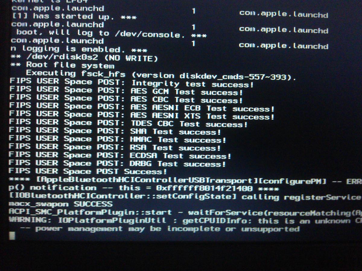

takeawaydave Posted August 31, 2012 Author Share Posted August 31, 2012 16 GB RAM on Motherboard. No options to set VGA RAM in bios... "3" thats the magic number. Managed to boot in safe mode still.... -f -x -v GraphicsENabler=No PCIRootUID=0 npci=0x3000 Link to comment Share on other sites More sharing options...
iFIRE Posted August 31, 2012 Share Posted August 31, 2012 try this and make a fstring for your graphics, this work for a lot people You have to use gfxutil (google for it) to get device path, command is either: ./gfxutil -f display or maybe ./gfxutil -f GFX0 (if you also have dedicated graphics installed) or maybe ./gfxutil -f IGPU (if you also have dedicated graphics installed) Copy this device path or save it somewhere then you need a .plist with injections (here is mine: https://rapidshare.c...xutil.plist.zip ). Paste in your device path and set AAPL,ig-platform-id. Then gfxutil again to get string ./gfxutil -i xml -o hex ./gfxutil.plist ./string.hex Test your DSDT.zip But I dont understand whit -x is safe mode and not load all kexts, but if it wok :thumbsup_anim: Link to comment Share on other sites More sharing options...

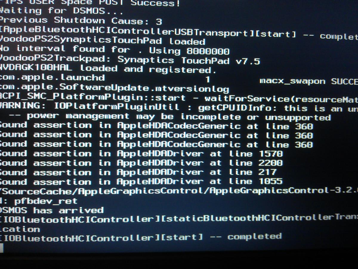

takeawaydave Posted August 31, 2012 Author Share Posted August 31, 2012 i'll leave the gfxutil for the graphics for the meantime.... since its working now.... how do i test the dsdt ? Tried the following. Pointed org.chameleon.Boot.plist at the DSDT.aml and rebooted. Similar errors but I believe some about "Sound Assertion...." against AppleHDA. See screenshot. This is without -x boot. Link to comment Share on other sites More sharing options...
iFIRE Posted September 1, 2012 Share Posted September 1, 2012 backup and delete your Applehda, now see in win your codec Audio ALC..... DSDT.aml copy and paste in Extra folder. Link to comment Share on other sites More sharing options...
takeawaydave Posted September 3, 2012 Author Share Posted September 3, 2012 finally getting round to spend some further time on this.... audio codec is ALC269vc.. apparently voodooHDA works against this since its the most common sound codec. giving it a go as well as the AppleHDA edit as shown here Link to comment Share on other sites More sharing options...
