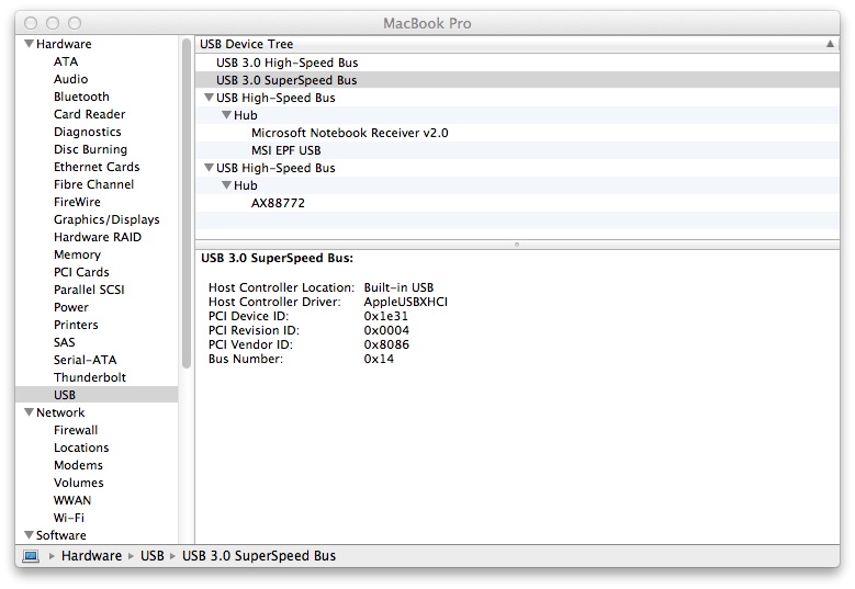

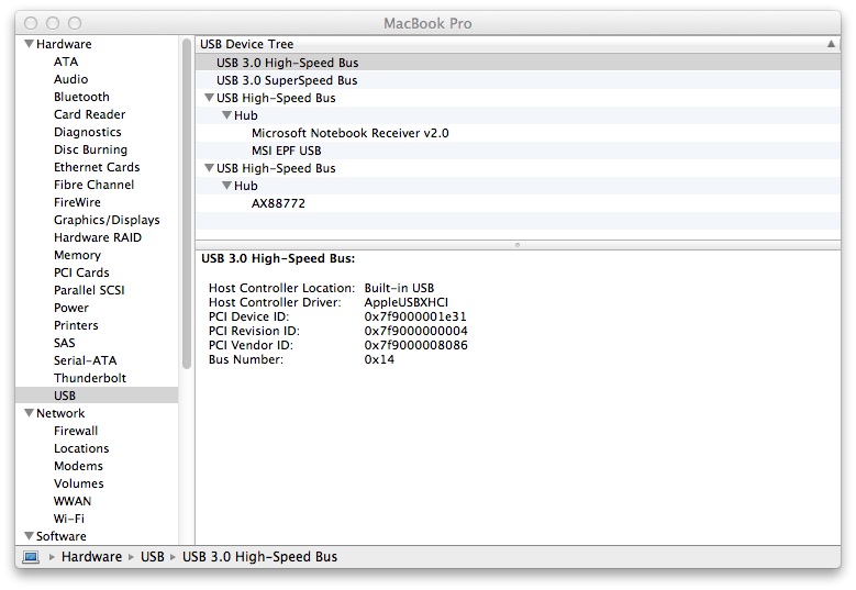

I have an MSI GT70 0ND-202US laptop with 3 x USB 3.0 ports and 2 x USB 2.0 ports, but every time I plug something into one of the USB 3.0 ports (USB 2.0 or USB 3.0), it freezes my computer and I'm forced to restart. USB 2.0 works fine on my two USB 2.0 ports. My USB 3.0 ports are using Intel's HM77 Chipset so the native USB 3.0 kexts are loading and System Information shows AppleUSBXHCI as the loaded driver for both the USB 3.0 High-Speed Bus and the USB 3.0 SuperSpeed Bus. Is there some sort of DSDT patch that I can apply to make these ports work?

How did you find your device ID for the USB 3.0 controller? Also, did you put it in IOKitPersonalities->AppleUSBXHCI->IOPCIClassMatch ? It tried running lspci, but didn't seem to find the correct ID that way. I have 1e31, 1e2d, and 1e26 from lspci in OS X. According to System Information, 1e31 is the USB 3.0 controller and 1e2d and 1e26 are the USB 2.0 controllers. System Information shows that it recognizes the USB 3.0 controller, but I'm not sure why it freezes when I plug something in (USB 3.0 or 2.0). I haven't injected ids yet though.
