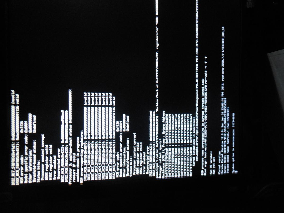

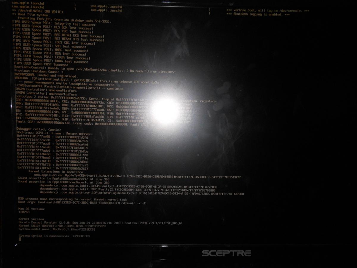

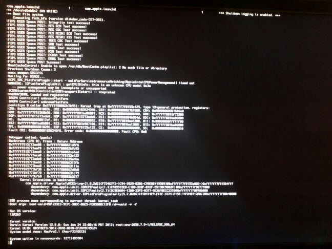

I just got this MB, updated with patched bios, configured the BIOS correctly (AHCI, HPET, disabled ASMedia SATA3, etc), installed ML on my SSD, made a DSDT and some kexts (latest fakesmc + monitoring, Realtek kext). The only problem I'm having is that if I put a PCIe GPU in I get a KP. Tried both with my 9800GT and a 6870. I also tried with GE=Y and GE=No + Device properties for 9800GT + HD 4000. Always the same KP. Tried ncpi=0x2000 & ncpi=0x3000 with no luck. I just can't get it to boot.

It looks like you need to install nullcpupowermanagment kext....
but I have a patched BIOS that should take care of that! http://bios.zmac.net...30_modified.zip (from http://www.tonymacx8...-thread-34.html )
Also, I played with my DSDT a little more, I think the previous one was trash, with the new one this is what I get
(edit: forgot to attach image to large)

I get the same kp i'd say

Boot with -v -s and then when you can type then type this code one line at a time to delete AppleTyMCEDriver.kext,
mount /
rm -rf /System/Library/Extensions/AppleTyMCEDriver.kext
sudo rm -rf /System/Library/Caches/*
schutdown -r now

That kext is for Triple Chanel Memory. If you do not have Triple Chanel Memory it can cause a KP.
