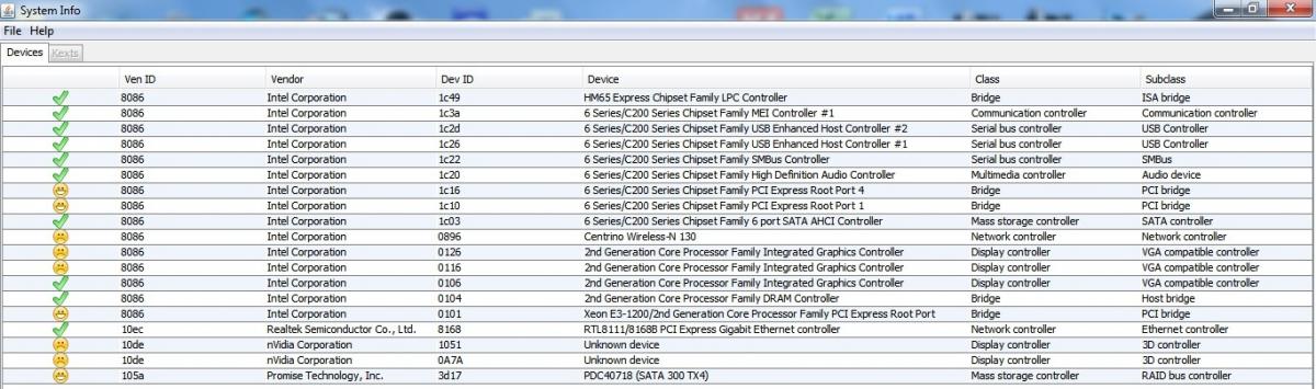

as for the ids for my network you can see this image witch got all of them :
Attached File  System Info.jpg   99.71KB   8 downloads

for ethernet, looks like your using lynx2mac's driver, try this instead. Here is link to entire github page
