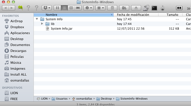

#13
iFIRE
iFIRE
    InsanelyMac Deity
  • Moderators
  • 2,438 posts
  • Gender:Male
  • Location:Bcn-Spain
you have this app???
Attached File  Captura de pantalla 2012-08-07 a la(s) 17.45.40.png   80.92K   40 downloads
if not download
Attached File  Captura de pantalla 2012-08-07 a la(s) 17.50.57.png   24.45K   8 downloads

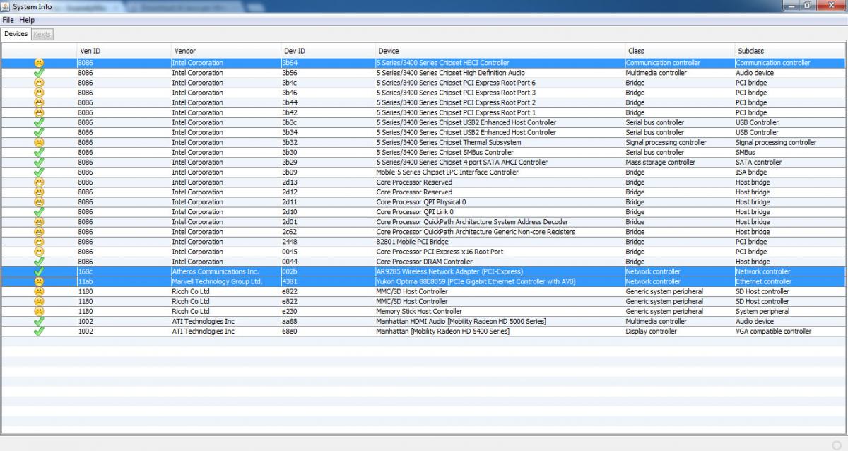

#16
MrTraverso
MrTraverso
    InsanelyMac Protégé
  • Members
  • PipPip
  • 63 posts
  • Gender:Male
  • Location:Rome
This is the screenshot
#17
iFIRE
iFIRE
    InsanelyMac Deity
  • Moderators
  • 2,438 posts
  • Gender:Male
ok, your graphics is HD 5470 Mobile, and you have Sata AHCI 4 Ports, the problem is the kexts of the Graphic Card, you have delete this or no boot, go for your USBInstaller and
