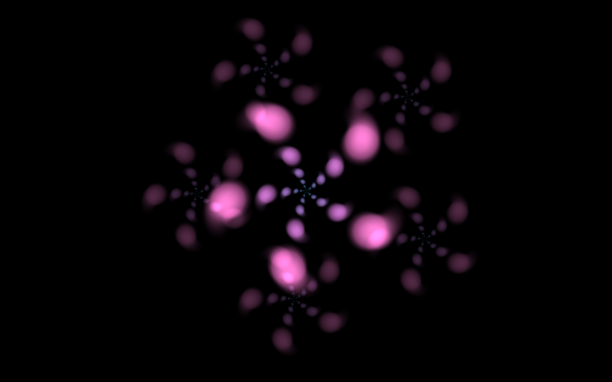

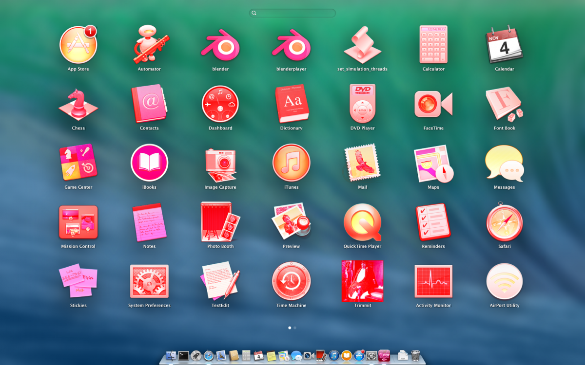

If I boot with AtiConfig=null and my Graphics show as AMD HD 6xxx - Then I get the pink icons, pink screenshots but less artifacts on boot.
Booting with AtiConfig=Bulrushes (uses my HDMI port with a HDMI to VGA converter) I get none of the above problems, more artifacts on boot but they go away as the desktop "zooms onto the screen"

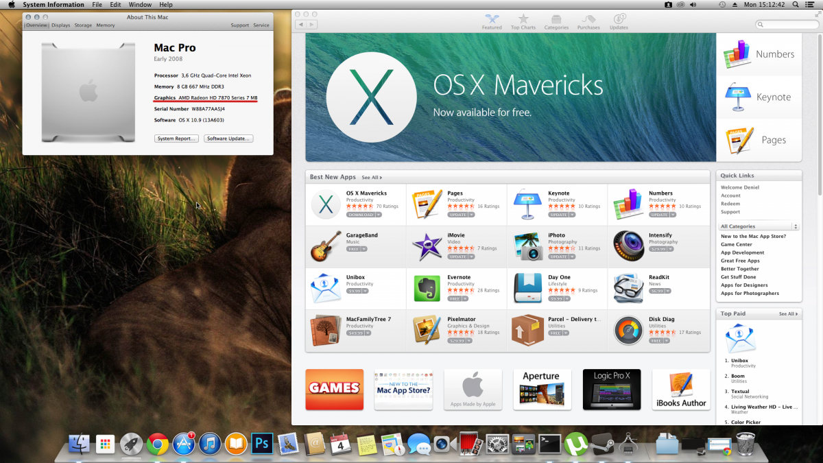

Hi, when i use GraphicsEnabler=Yes afther booting my screen go dark gray whit mouse, i can move mouse but can't do anything eles. . .is this frame buffer maybe solution?
OK Guys. . .i think i am on right track. . .
In Clover i have select InjectATIRom and VBIOS in fake ID i have put 7970 (even if i have 7870) and that resolved my stuck on dark gray screen. . .there is no artifacts any more. . .but the problem is that is showing that my gpu have only 7MB of ram.. .
Any ideas?

I am using hamashi for FBName, but in this whey i do not have any artifact's only problem is this 7MB of GDDR Ram (i have 2GB) if that would be fxed we would have 100% working hackintosh whit GE. . .
i hope you have it as Hamachi*  :P  You can try other FB names too

Well got "Shell" screensaver going.. but now Launchpad is pink again! (wasn't before libGPUSup patched).
It took some time 20 or so seconds first; next 5 times faster and faster.
shell screensvr
pink launchpad
Edit: on Radeon hd 5770
shell screensvr
pink launchpad
