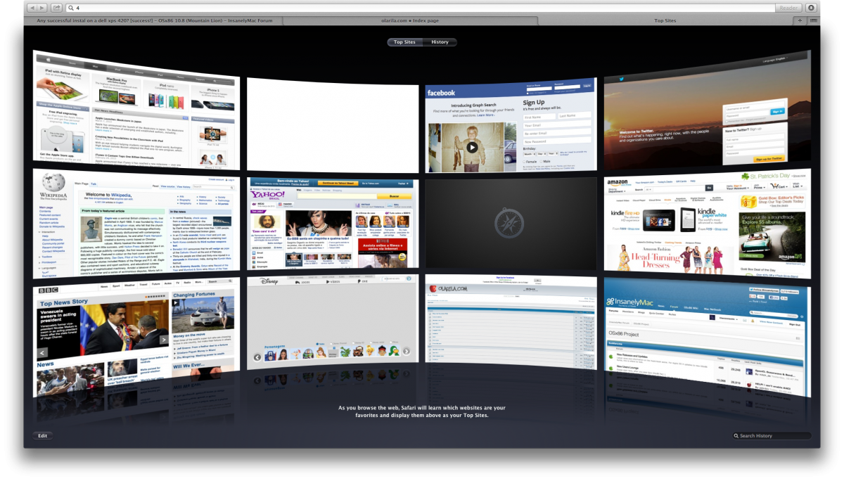

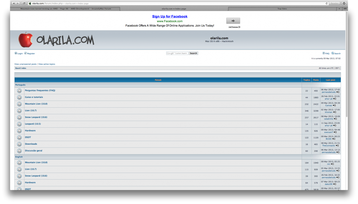

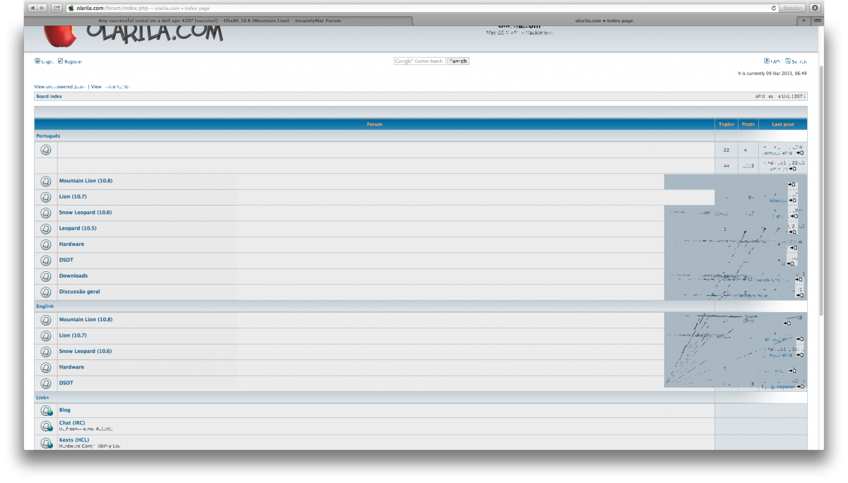

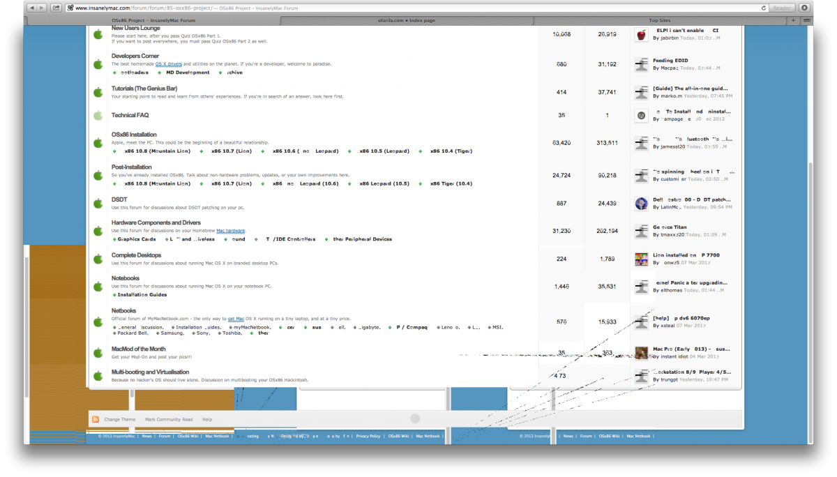

As i go deeper with the tests, i do find some graphics issues, up to now only with Safari, but i must say they're rather mild. Nothing even close to render the app unusable, as can be confirmed in the pictures below:
But one interesting thing i discovered is that the glitches seem to adjust themselves if you give them time enough, as in the picture bellow, the same page as the last picture above after be left open for a dozen minutes:
All in all, the biggest issue i encountered was an extreme, unbearable lagginess of the system, derived of the fact it was running from a live USB stick plugged in a plain 2.0 port.

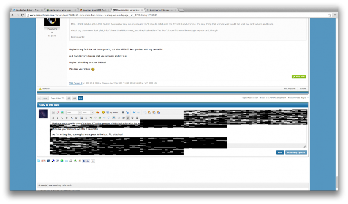

UPDATE 5: More minor glitches with Chrome. This time, when i was replying to our friend Toleda at Voldemort's castle, i noticed that sometimes black rectangles appeared covering parts of the post i was writing when i moved the mouse. This seems to disappear when i left the mouse alone. These glitches were somewhat more intense than the ones i experienced before (see UPDATE 4, post #1748).

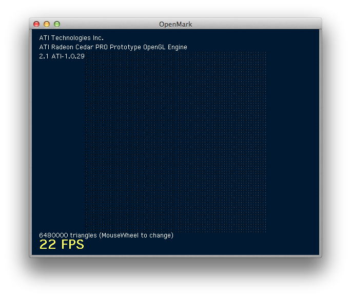

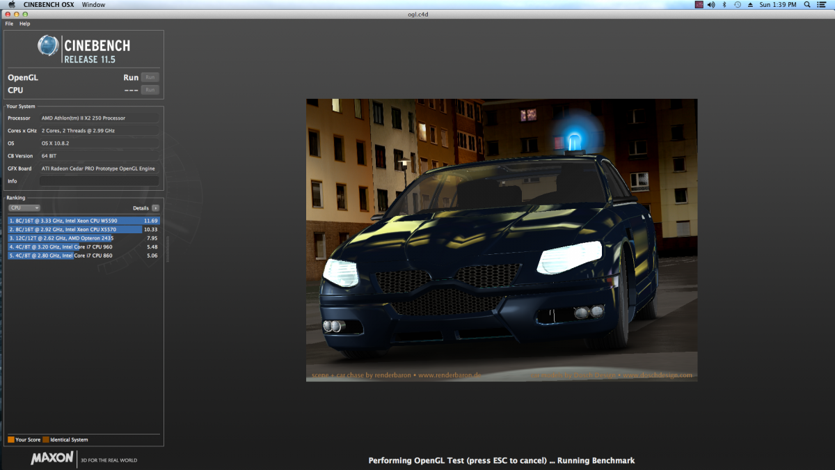

All of them with the FPS rate expected from this rather low-profile discrete card. The only ones to present any glitches were Bioshock (some flickering in the dark scenarios, almost imperceptible) and Crazy Monster Truck (perceptible flickering when changing lanes, but not to the point of really impair playability). So i can safely say that the HD5450 is approved for OSX gaming on an AMD machine, as long as you respect the limitations of the card, which are valid for all systems.
Next, to the benchmarks :)

Kiko, how are you?
Man, i think patching the AMD Radeon Accelerator only is not enough: you'll have to patch also the ATI5000.kext. For me, the only thing that worked was to add the id of my card to both said kexts.
About org.chameleon.Boot.plist, i don't have UseAtiRom=Yes, just GraphicsEnabler=Yes. Don't know if it would be enough to your card, though.
Best regards!
Kiko, how are you?
Best regards!
Maybe it's my fault for not having said it, but also ATI5000.kext patched with my deviceID !
so I found it very strange that you will work and my not.
Maybe I should try another SMBios?
PS: clear your inbox! :P
Perhaps your card is one of the few ATIs that present nVidia behavior with the kernel, meaning it won't work. :(
If it's so, you'll have to wait for a kernel fix.
As i'm writing this, some glitches appear in the box. Pic attached! Screen Shot 2013-03-10 at 1.47.43 PM.png
Best regards!
