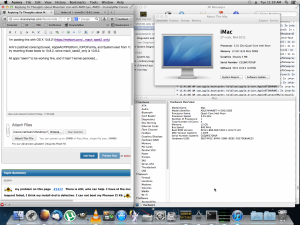

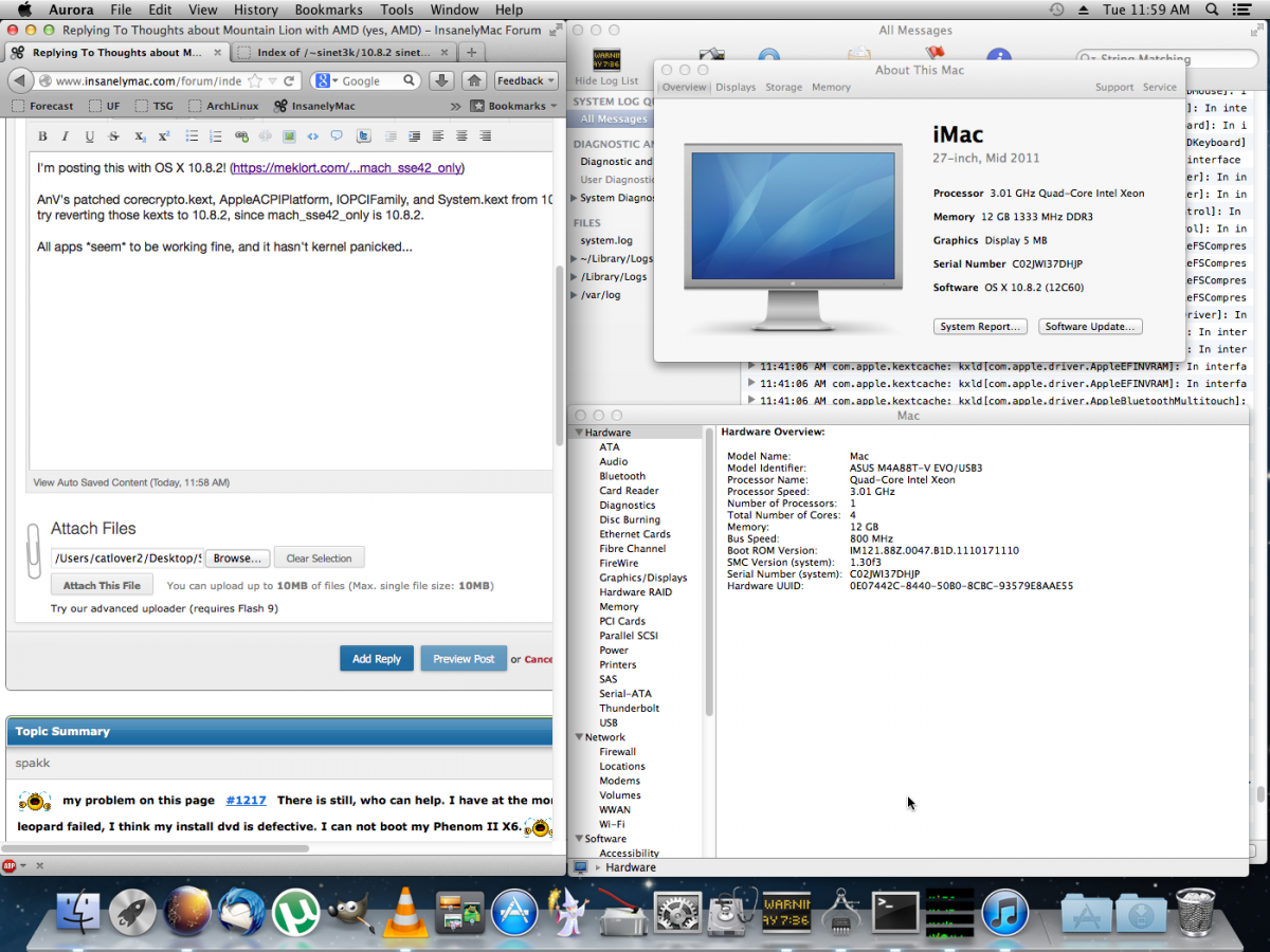

I'm posting this with OS X 10.8.2! (https://meklort.com/...mach_sse42_only)
AnV's patched corecrypto.kext, AppleACPIPlatform, IOPCIFamily, and System.kext from 10.8.0. Now I'll try reverting those kexts to 10.8.2, since mach_sse42_only is 10.8.2.
All apps *seem* to be working fine, and it hasn't kernel panicked...
EDIT: I reverted AppleACPIPlatform, IOPCIFamily, and System.kext to their vanilla 10.8.2 versions, no problems!

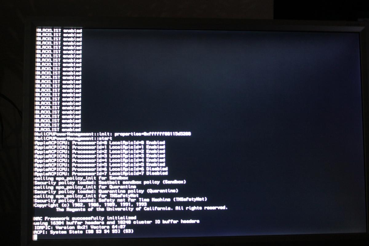

Hi Sinetek, as discussed, here the test with your kernel without FaleSMC +nullpower and without decrypter
kernel: mach_ssse3_only -v -f see Pic

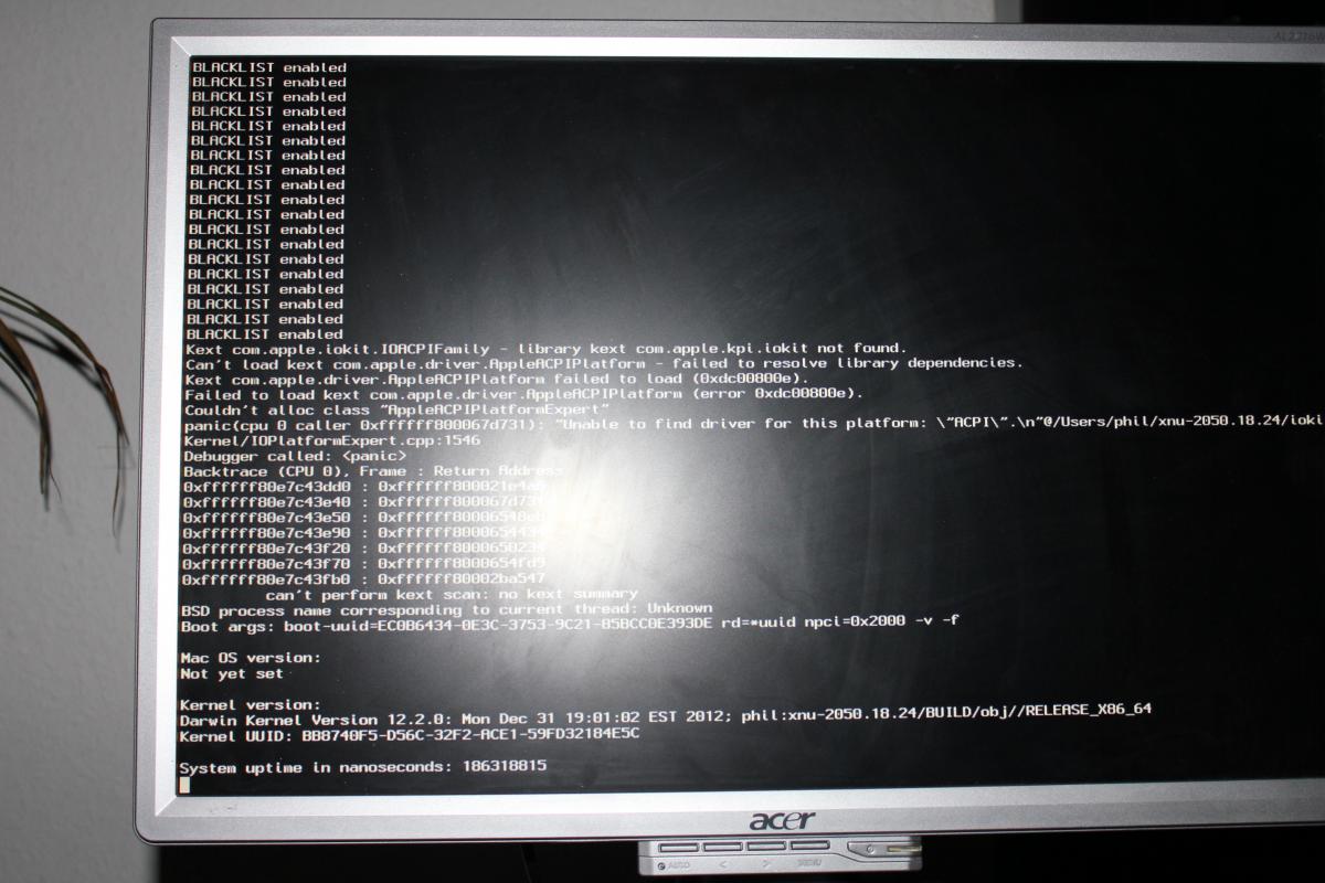

Hi sinetek,
booting with mach_sse3_all_kdecrypt -v -f with system.kext and decrypt.diff
same problem as yesterday

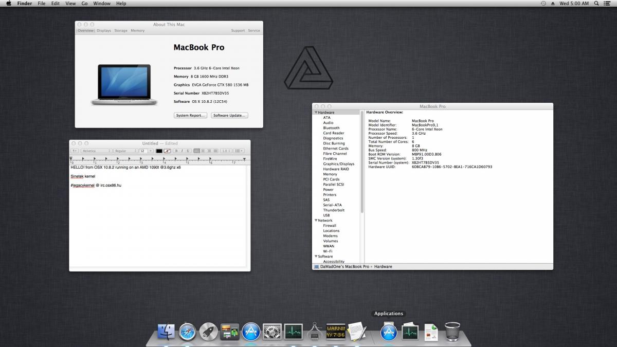

mach_sse42_only arch=x86_64 busratio=18 -v
EDIT: hello from osx
