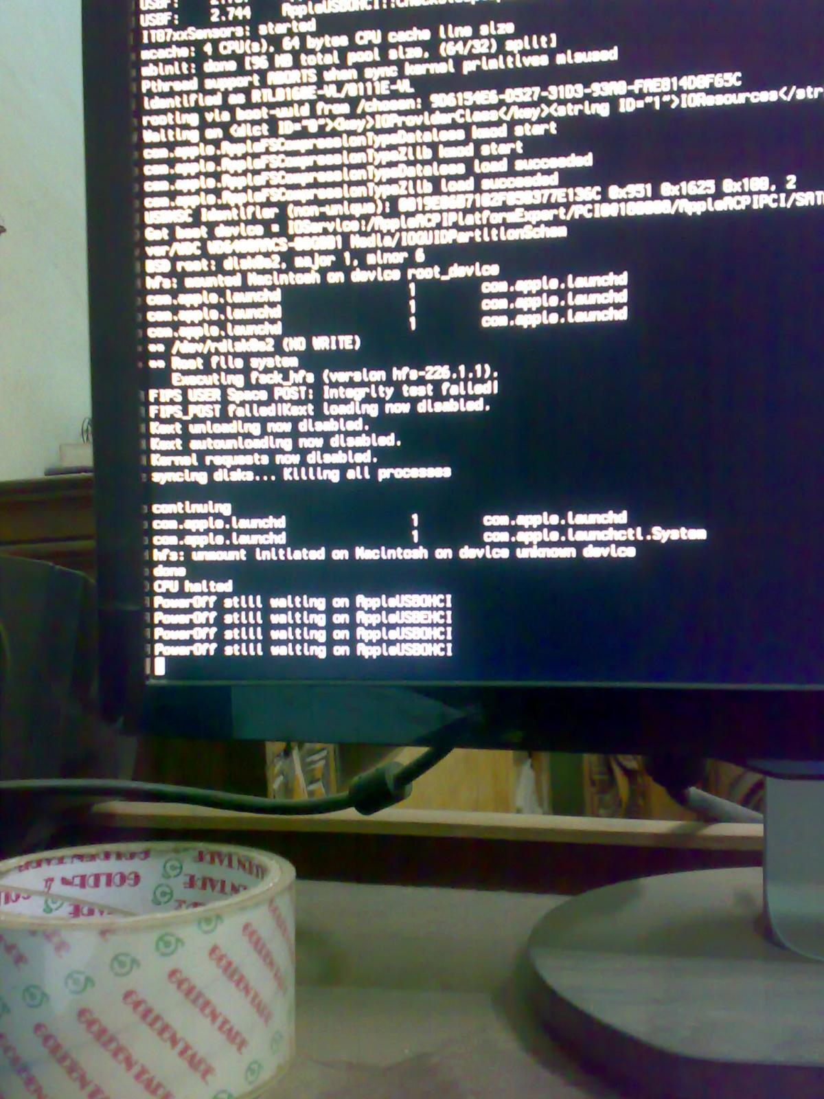

I don't mean to be an annoying knat, but can anyone tell me why all I'm getting is a black/blank screen whenever I try to boot with these kernels? If they just don't work with FX processors yet, then let me know so I can stop beating my head against the wall, thanks.
try to boot with cpus=1 and with -x
cpu=1? :(  i boot on cpu=4 ;)  busratio=20 (is no good??)
@Gils => avec quel flag on peu booter avec le kernel AMD sur core2duo? genre arch=i386?
J'ai un portable hp probook 4710s avec un core2duo T6570 et une ATI mobility HD4330 qui ne veux pas booter sur 10.8 ou 10.9 mais nickel sur 10.7... Grrrrrr ca m'enrage!!!! lol
Merci d'avance en esperant ne pas poluer le topic avec ce message... :blush:
Edit: opps translate...
@ Gils => with what little flag on boot with the kernel on AMD core2duo? arch = i386 kind?
I have a laptop hp probook 4710s with Core2Duo T6570 and ATI Mobility HD4330 does not want to boot from 10.8 or 10.9 to 10.7 but nickel ... Grrrrrr ca infuriates me! lol
Thank you in advance, hoping not poluer the topic with this message ... :blush:
Edited by Skunk.34
Nope, still nothing but black. Could it be a graphics problem? I looked in S/L/E and I don't see any NVIDIA kexts. I tried both GraphicsEnabler=Yes & GraphicsEnabler=No.
install the nvidia graphics driver, and edit the vendor-id and device-id
video memory=0 ;)  :(
s_hit, same as mountain lion B)
gils83 - Are your screens on Core 2 Duo or AMD machine? What is your flags?
I tried to use all the flags (with and without, a lot of combinations :D) and almost always stops at "hfs: USB mounted on device root_device".
So we need to wait for new kernel from Sinetek or I am doing something wrong? :D
On my Dell XPS 1330 with Intel Core 2 Duo T8100 kernel works good, but only with selected flags and if I miss one of those, the installer will not run.
Those flags: -MEROMLAND, keepsyms=1, -v, -f, arch=x86_64, USBBusFix=Yes, (Graphics Enabler= Yes/No - not tested).
I join a question. I get KP on corecrypto.kext. Replacing kext of 10.8 patched by AnV
always stops at "hfs: USB mounted on deviceroot_device"
flags -MEROMLAND keepsyms=1 amdtlbfix do not help.
