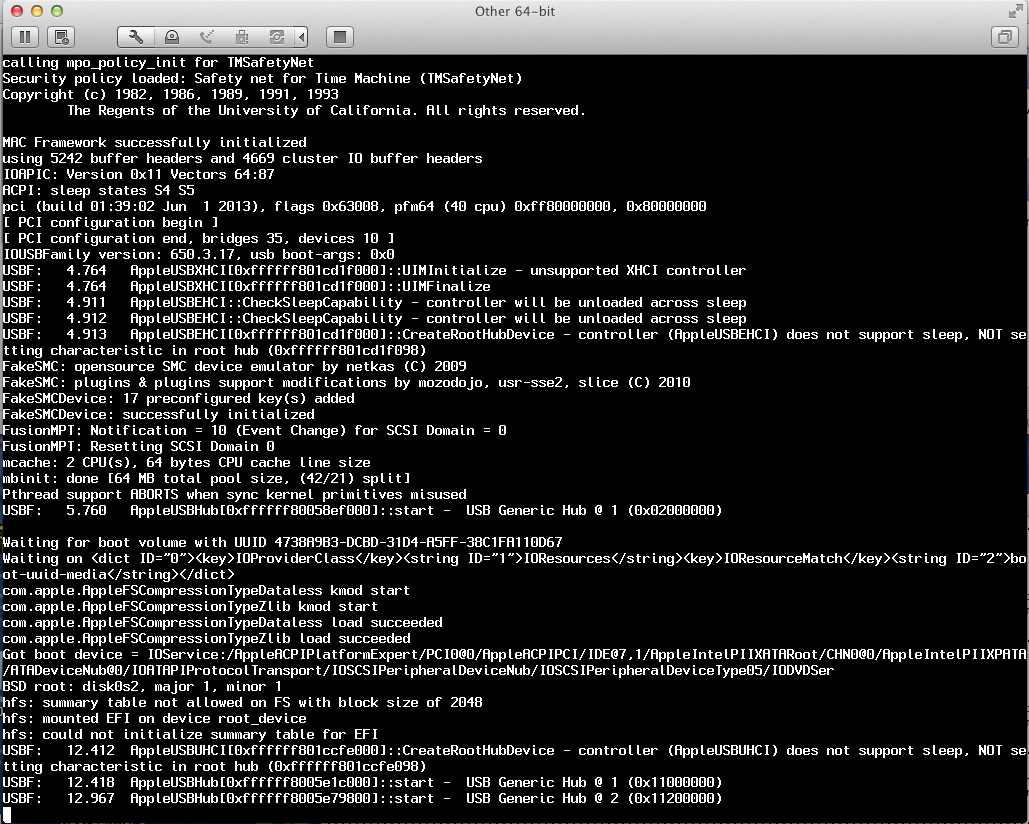

second test: only with boot flag:-nossse3 gray screen (in the background load the kexts) shortly thereafter for a fraction of a second to see the gray apple, then restart
I have tried almost everything, unfortunately no success, no kernel panic message. the system re-starts only.

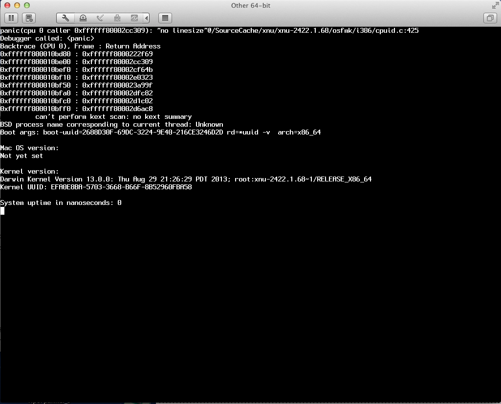

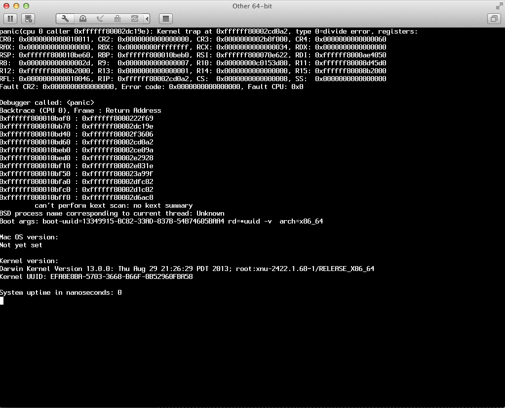

@bronya   да))  no sources.. so difficult. it bombs in cpu_thread_alloc.
maybe AMD crashes sooner??? MSR's.......
NO . it is cpuid.
it is cpu number in cupid_set_info .
you see :
for  intel :
cpuid_fn(0, cpuid_result);
info_p->cpuid_cores_per_package
= bitfield32(reg[eax], 3126) + 1;
for amd :
cpuid_fn(0x80000008, cpuid_result);
= (ecx & 0xff) + 1;
I checked - don't working single user .
@bronya   weird, it's the first i hear of that.   CPUID function 0 is valid on AMD
:D
amd don't support "cupid function" 0 for "cpu number" ))))  support only 0x80000008 )
