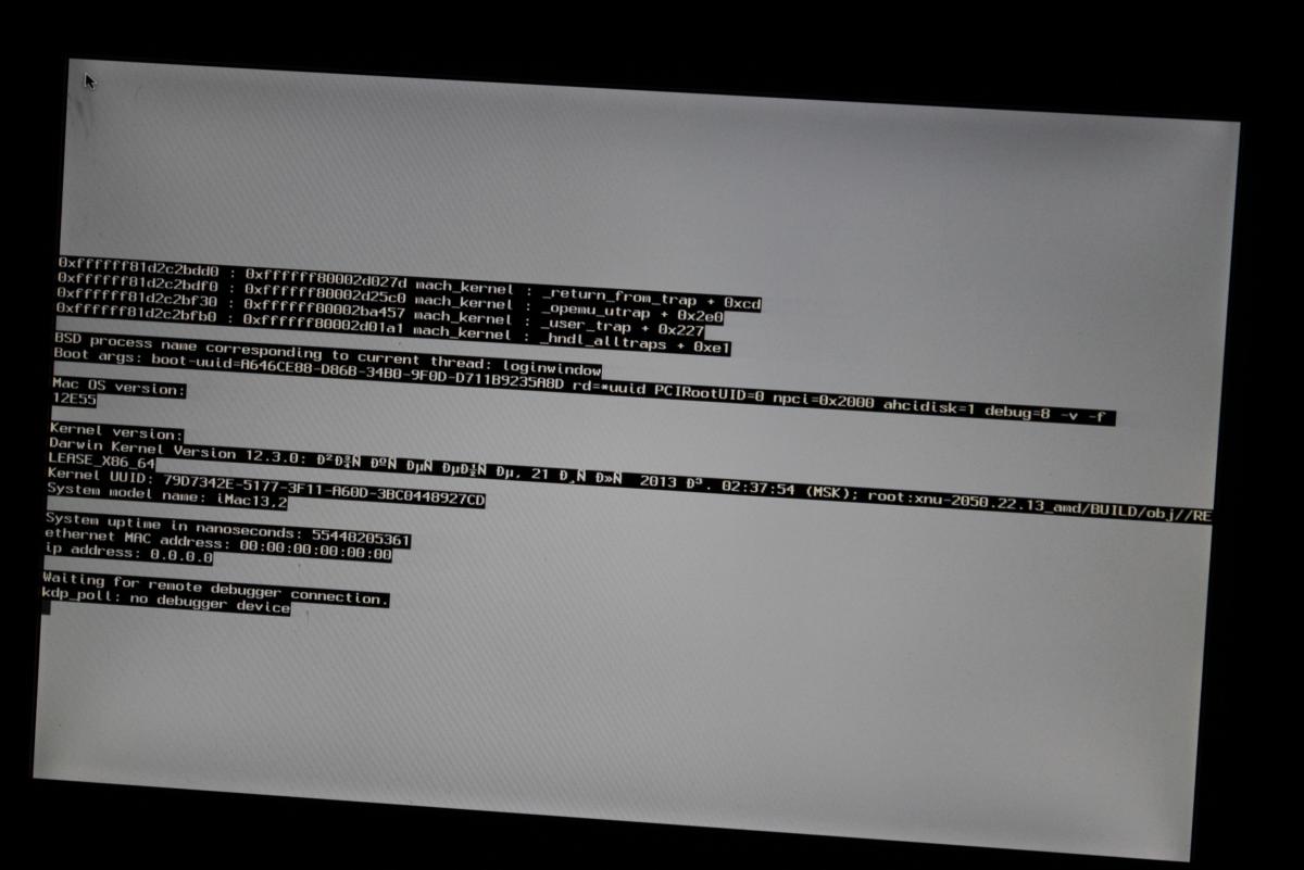

emulator sysenter64 for AMD ?? :worried_anim:
on voit bien bien le décrochage vidéo "image verte" se qui veut dire que "syscall" est trop lent en 64 bit mais fonctionne très bien en 32 bit ou sysenter 32 car il est fonctionnel pour AMD . :)
we can see well the video stall "green image" is meaning that "syscall" is too slow in 64 bit but works fine in 32-bit or 32 sysenter as it is functional for AMD. :)

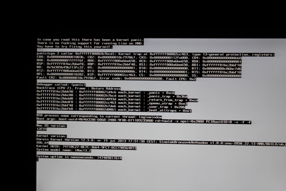

So which registers get changed for syscall on AMD?
We could make sysenter->syscall and sysexit->sysret work in the opemu to test
EDIT: Gonna look up the differences in the instruction set manuals from Intel and AMD.
I found some info.
As you can see, using the int 0x80 API is relatively simple. The number of the syscall goes to the eax register, while all the parameters needed for the syscall go into respectively ebx, ecx, edx, esi, edi, and ebp. System call numbers can be obtained by reading the file /usr/include/asm/unistd_32.h. Prototypes and descriptions of the functions are available in the 2nd section of the manual, so in this case write(2). Since the kernel is allowed to destroy practically any of the registers, I put all the GPRs on the clobber list.
In this case, the number of the system call is still passed in the register rax, but the registers used to hold the arguments have severely changed, since now they should be used in the following order : rdi, rsi, rdx, r10, r8 and r9. The kernel is allowed to destroy content of registers rcx and r11 (they're used for saving some of the other registers by SYSCALL).
and:
http://www.cs.auckland.ac.nz/compsci215s2c/lectures/robert/2012/lecture14.pdf
Changes in progress...
I think this bit of code does it...:
                asm __volatile__ ("movq %rbp, %r9\n"
                                  "movq %rdi, %r8\n"
                                  "movq %rsi, %r10\n"
                                  "movq %rcx, %rsi\n"
                                  "movq %rbx, %rdi\n"
                                  "syscall");
I think this bit of code does SYSEXIT using SYSRET:
        asm __volatile__ ("sysret");
EDIT: Correction: SYSCALL does not mess with the stack pointer and so.
It only puts the return address in %rcx.
It restores the stack pointer from %rcx on execution of sysret.
Ok... I created a kernel to test.
The easiest way to check if it works is by running a 32-bit app...
hello Andy ,
Thank you for your analysis and your work, I do not hide my ignorance though I know the outline as many member on this forum but if AMD is not compatible sysenter64 only syscall64 and 32, I wanted whether it is directly related to graphics drivers? and what protocol the drivers you used them? or is it simply based at the CPU and have a direct link with the graphics drivers? In fact, what I gene is "kernelNV" Nvidia have its own kernel? unlike ATI?
Sysenter and sysexit don't work in 64bit mode
Syscall and sysret do...

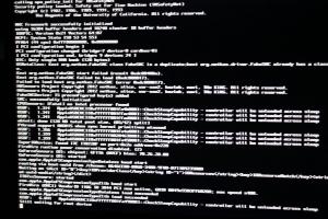

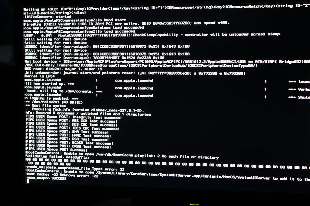

system booting here:
Last login: Fri Jul 19 14:38:18 on console
ccs-iMac:~ cc$ sudo dmesg
Password:

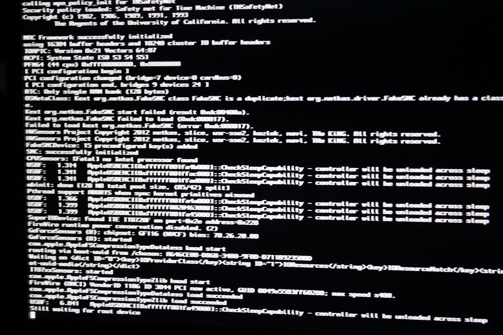

no linesizertclock_init: Taking bus ratio path 3 (AMD Phenom)
rtclock_init: Phenom MSR 0xc0010071 returned: 0x8000012400240e
TSC: Verification of clock speed not available in x86_64.
TSC: Frequency = 3000.187320MHz, FSB frequency = 200.12488MHz, bus ratio = 15
Darwin Kernel Version 12.3.0: vr 19 jul 2013 13:46:54 CEST; SinetekBronzovkAnVoodoo v1.0.0:xnu-2050.22.13-AMD/BUILD/obj/RELEASE_X86_64
vm_page_bootstrap: 695545 free pages and 353031 wired pages
kext submap [0xffffff7f80809000 - 0xffffff8000000000], kernel text [0xffffff8000200000 - 0xffffff8000809000]
zone leak detection enabled
standard timeslicing quantum is 10000 us
standard background quantum is 2500 us
mig_table_max_displ = 74
SAFE BOOT DETECTED - only valid OSBundleRequired kexts will be loaded.
corecrypto kext started!
Running kernel space in FIPS MODE
Plist hmac value is 735d392b68241ef173d81097b1c8ce9ba283521626d1c973ac376838c466757d
Computed hmac value is 735d392b68241ef173d81097b1c8ce9ba283521626d1c973ac376838c466757d
corecrypto.kext FIPS integrity POST test passed!
corecrypto.kext FIPS AES CBC POST test passed!
corecrypto.kext FIPS TDES CBC POST test passed!
corecrypto.kext FIPS SHA POST test passed!
corecrypto.kext FIPS HMAC POST test passed!
corecrypto.kext FIPS ECDSA POST test passed!
corecrypto.kext FIPS DRBG POST test passed!
corecrypto.kext FIPS POST passed!
warning: skipping personalities in blacklisted kext com.apple.driver.AppleEFIRuntime
warning: skipping personalities in blacklisted kext com.apple.driver.AppleIntelCPUPowerManagement
NullCPUPowerManagement::init: properties=0xffffff80083cac00
NullCPUPowerManagement::start
AppleACPICPU: ProcessorId=0 LocalApicId=0 Enabled
AppleACPICPU: ProcessorId=1 LocalApicId=1 Enabled
AppleACPICPU: ProcessorId=2 LocalApicId=2 Disabled
AppleACPICPU: ProcessorId=3 LocalApicId=3 Disabled
calling mpo_policy_init for Sandbox
Security policy loaded: Seatbelt sandbox policy (Sandbox)
calling mpo_policy_init for Quarantine
Security policy loaded: Quarantine policy (Quarantine)
calling mpo_policy_init for TMSafetyNet
Security policy loaded: Safety net for Time Machine (TMSafetyNet)
Copyright © 1982, 1986, 1989, 1991, 1993
The Regents of the University of California. All rights reserved.
MAC Framework successfully initialized
using 16384 buffer headers and 10240 cluster IO buffer headers
IOAPIC: Version 0x21 Vectors 64:87
ACPI: System State [s0 S4 S5]
PFM64 (44 cpu) 0xfff80000000, 0x80000000
[ PCI configuration begin ]
PCI configuration changed (bridge=4 device=1 cardbus=0)
[ PCI configuration end, bridges 6 devices 21 ]
USBF: 1.387 AppleUSBEHCI[0xffffff800857c000]::CheckSleepCapability - controller will be unloaded across sleep
USBF: 1.389 AppleUSBEHCI[0xffffff8008578000]::CheckSleepCapability - controller will be unloaded across sleep
USBF: 1.442 AppleUSBOHCI[0xffffff8008f30000]::CheckSleepCapability - controller will be unloaded across sleep
USBF: 1.452 AppleUSBOHCI[0xffffff800857d000]::CheckSleepCapability - controller will be unloaded across sleep
USBF: 1.453 AppleUSBOHCI[0xffffff800857d000]::InitializeOperationalRegisters Non-NULL hcDoneHead: 0xafff1eb0
USBF: 1.454 AppleUSBOHCI[0xffffff800857e000]::CheckSleepCapability - controller will be unloaded across sleep
USBF: 1.455 AppleUSBOHCI[0xffffff800857e000]::InitializeOperationalRegisters Non-NULL hcDoneHead: 0xafff1e00
USBF: 1.483 AppleUSBOHCI[0xffffff800856a000]::CheckSleepCapability - controller will be unloaded across sleep
FireWire runtime power conservation disabled. (2)
FireWire (OHCI) TI ID 823f PCI now active, GUID 7856341278563412; max speed s800.
USBF: 6.853 AppleUSBOHCI[0xffffff8008577000]::CheckSleepCapability - controller will be unloaded across sleep
ERROR: FireWire unable to determine security-mode; defaulting to full-secure.
mbinit: done [64 MB total pool size, (42/21) split]
Pthread support ABORTS when sync kernel primitives misused
com.apple.AppleFSCompressionTypeDataless kmod start
rooting via boot-uuid from /chosen: 6AC566AB-6447-3CC0-917A-88ECD2133AA0
Waiting on IOProviderClassIOResourcesIOResourceMatchboot-uuid-media
com.apple.AppleFSCompressionTypeZlib kmod start
com.apple.AppleFSCompressionTypeDataless load succeeded
com.apple.AppleFSCompressionTypeZlib load succeeded
Got boot device = IOService:/AppleACPIPlatformExpert/PCI0@0/AppleACPIPCI/SATA@11/AppleAHCI/PRID@0/IOAHCIDevice@0/AppleAHCIDiskDriver/IOAHCIBlockStorageDevice/IOBlockStorageDriver/ST3320613AS Media/IOGUIDPartitionScheme/test123@3
BSD root: disk0s3, major 1, minor 5
jnl: unknown-dev: replay_journal: from: 6636544 to: 6621696 (joffset 0x94000)
jnl: unknown-dev: journal replay done.
Kernel is LP64
hfs: Removed 1 orphaned / unlinked files and 12 directories
macx_swapon SUCCESS
Previous Shutdown Cause: 3
NVDAStartup: Official
ACPI_SMC_PlatformPlugin::start - waitForService(resourceMatching(AppleIntelCPUPowerManagement) timed out
WARNING: IOPlatformPluginUtil : getCPUIDInfo unknown CPU family: family 0x10, model 0x2
-- power management may be incomplete or unsupported
NVDAGF100HAL loaded and registered
[iOBluetoothHCIController][start] -- completed
Password:
Kernel is LP64
macx_swapon SUCCESS

kern.ostype = Darwin
kern.osrelease = 12.3.0
kern.osrevision = 199506
kern.version = Darwin Kernel Version 12.3.0: vr 19 jul 2013 17:51:50 CEST; SinetekBronzovkAnVoodoo v1.0.0:xnu-2050.22.13-AMD/BUILD/obj/RELEASE_X86_64

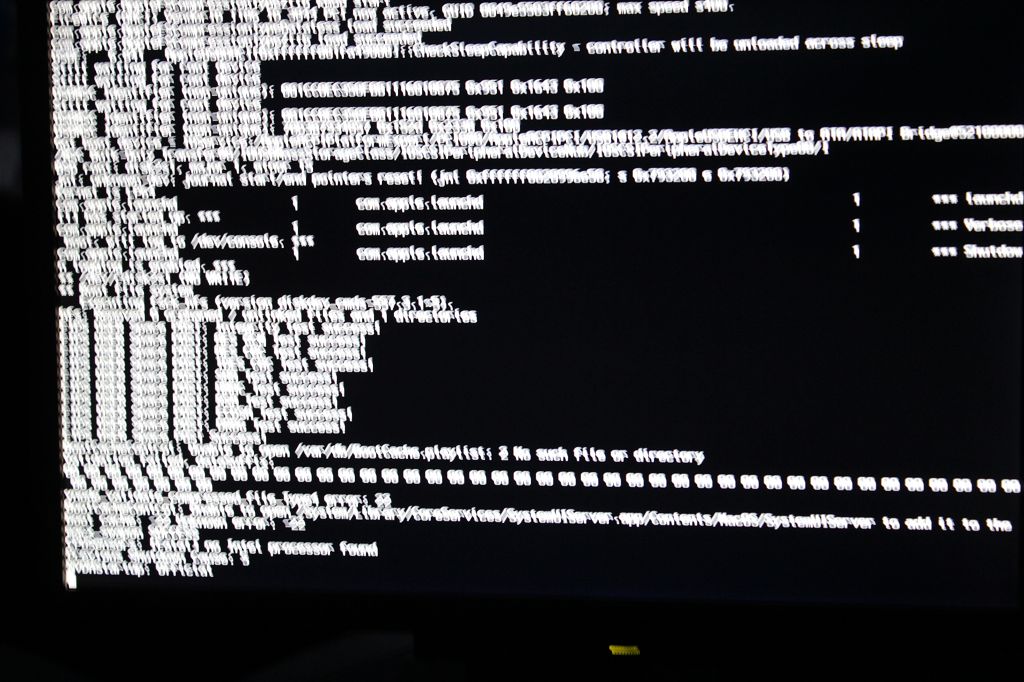

incorrect freqs. and cache size
32-bit code works (tested with xee)
64-bit code (nvidia..) still failing

Just looking for any kind of answer now for the graphics. Is this related in any way Andy as to why we are getting artefacts on ATI,
Jul 19 19:20:50 shaneees-imac.home WindowServer[90]: GLCompositor: GL renderer id 0x01021b04, GL mask 0x00000007, texture units 8, texture max 16384, viewport max {16384, 16384}, extensions FPRG|NPOT|GLSL|FLOAT
donc après bug TLB et problème sysenter/syscall , on revient sur les pilotes graphiques x86_64 non compatible AMD . 2 coups pour rien . :(
Merci Andy d'avoir levé le doute . :)
So after TLB bug and issue sysenter / syscall, we return to the graphics driver is not compatible AMD x86_64. 2 hits for nothing. :(
Thank you Andy have raised doubts. :)
C'est dommage. Probablement le code dans le pilote graphique.
Too bad. It's probably the code in the graphics driver.

Ok, I made a new kernel.
It does not map to SYSCALL/SYSRET, instead it uses the enhanced current SYSENTER emulator.
I also added SYSEXIT (restore stack and instruction pointer and execute at instruction pointer).
Please test and give me feedback...
If 32-Bit apps work right, the new SYSENTER emu works great.

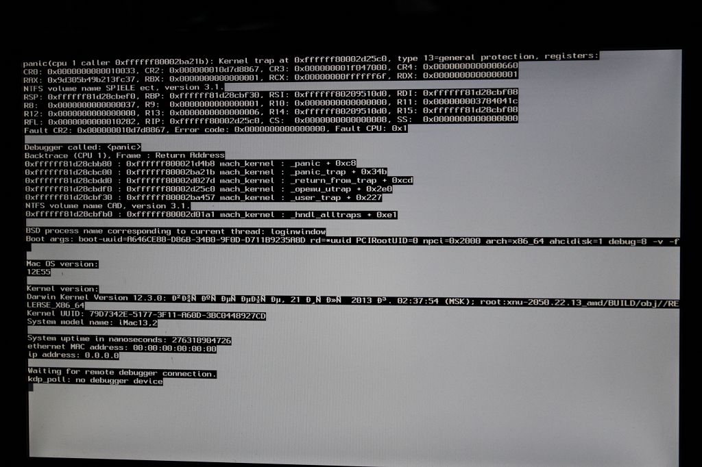

are the last two kernels to Mountain Lion 10.8.4 compatible? :whistle:
first I tested Mountain Lion 10.8.4 with the first Andy's amd_kernel and it boots, and a short time later, a KP. now I know first of all that my system is ready to test next test- kernel. Now I will test the last two kernel of Andy and Bronya than I will report :whistle:
last Andys amd_kernel / SinetekBronzovkAnVoodoo_RC8.diff
boot flag: npci=0x2000 PCIRootUID=0 -v -f -F, such a bother, it boots and when the white screen comes then comes the panic opemu_utrap, unfortunately, I have no possibility to make at the moment  a photo :whistle:
Edit:
next Test with bronyas kernel, kernel boots up very quickly but also with KP,
if I want to test something, then make a few suggestions

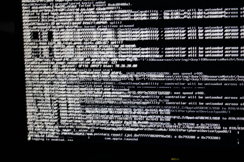

test with last bronya kernel
FakeSMC GPUSupport does indeed bitching, but whatever :whistle:
This installation is on an external USB-IDE HDD
next Test with bronyas Kernel: boot flag: arch=i386  than ML reboot

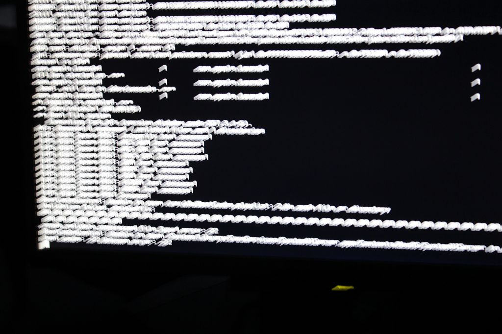

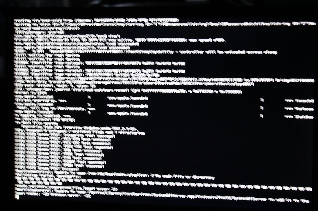

I have put all possible boot flag , always the same KP! with andys+bronya kernel ( -x , -s etc)
