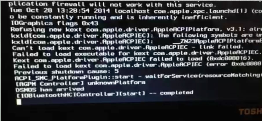

jhkoenig Posted November 3, 2014 Share Posted November 3, 2014 First, thanks for this community. An amazing amount of knowledge and interaction. So I am a frustrated installer. All this wonderful code, lots of successful users, yet I am not able to make this work. Here's my situation. My Toshiba Satelite L675-S7018 has an i3-350M processor, 8GB of memory and Toshiba's 'cinematic' 16x9 display (1600x900 resolution that's great for movies, not so great for writing code) delivered via Intel HD Graphics. I have tried 10.9 and 10.10. I have tried every installation protocol mentioned on this site (and some on sites we don't mention). In every case, the result is the same. The boot process announces "DSMOS has arrived", then "[iOBluetoothHCIController][start] -- completed" and then the laptop reboots just as the Apple logo screen flashes by. I can only report these verbose results because I videotape the boot process. By naked eye the screen flashes by too quickly to read the last few lines. It seems like a graphics problem but I can't figure out what's wrong. I have deleted the video kexts, tried every combination of boot flags I can think of. I've nearly worn our a USB stick from too many reformats. Any ideas on what else I can try? Thanks for all the hard work! --John Here's a picture just before the apple logo flash and reboot: Link to comment Share on other sites More sharing options...

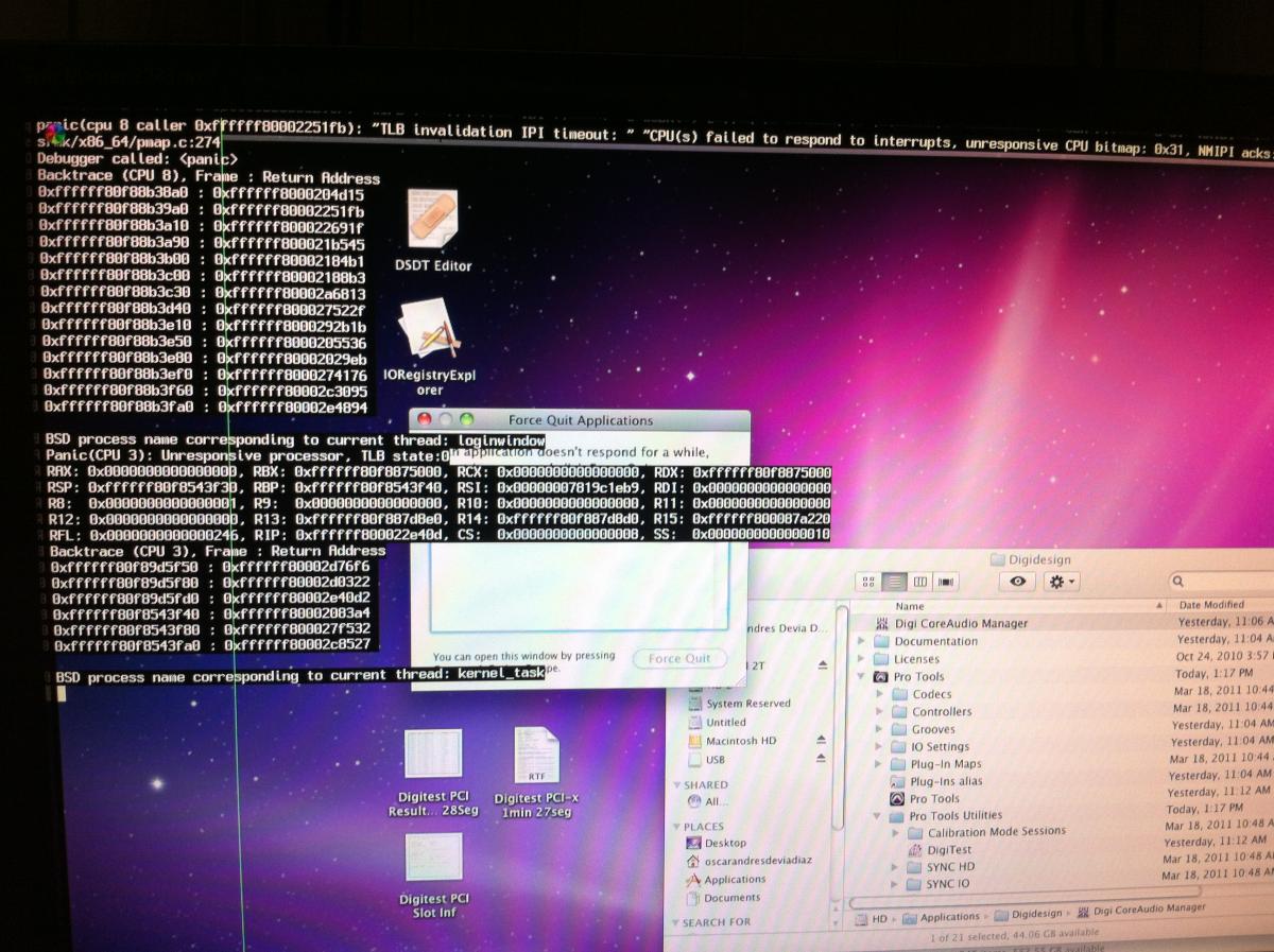

Oscar Devia Posted March 14, 2015 Share Posted March 14, 2015 Someone might enable the pci-x ports on the x8sax? I've installed a full snow leopard on my x8sax with full power management, hpet, smbus, ethernet (all vanilla) but I can't enable the pci-x ports So if anyone can help me, I really appreciate it!! This is the kernel panic Oscar Link to comment Share on other sites More sharing options...
