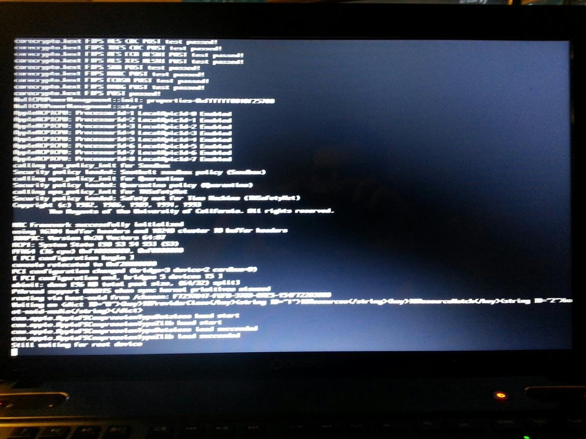

For some reason i can run ML on VMware with this machine but I cant install for the life of me.
I followed this Tut Pretty Well. I am going to try and Start from the beginning. Maybe I missed something.
For some reason I am getting stuck at Still waiting for device. (picture attached)

Because a hackintosh isn't a real mac? It's a different process. Also chameleon won't mount .dmg's so we have to do it ourself.
Basesystem.dmg is the recovery environment we use to install OS X, InstallESD contains the packages required to do so.
Try booting with: npci=0x2000 -v -x -f
If it still gives "still waiting for..." check your HDD isn't plugged into 6GB/s SATA. If you have different coloured SATA ports, try it in the different colours.
Failing that post a screenshot here if it still hangs.
P.S. -x is safe mode, -s is single user mode
