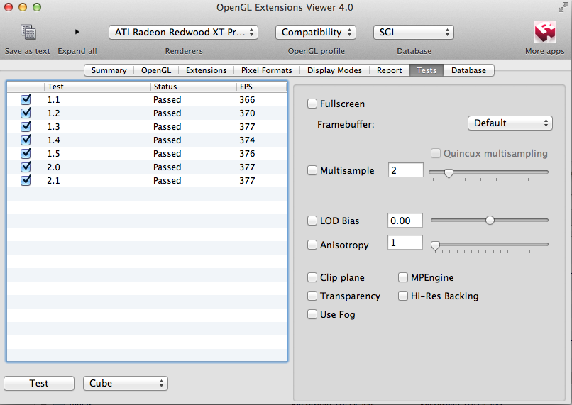

3. I installed OpenGL Extensions Viewer what do with it or is just a plugin/driver?

openglextensionsviewer is to u run the tests
and post shot from the result
good hack
Hello,

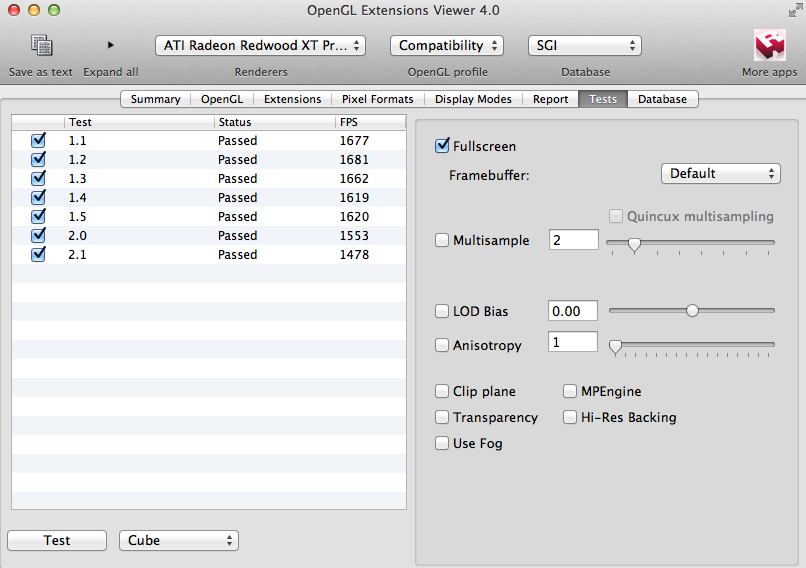

In OpenGL Extension Viewer it passes all the tests see picture and attached is the output report.txt
Is all fine?

about the ati is not good
do the test in full screen.. i know that ati is not the best one... but is very poor .. the test...

Here is the test in fullscreen:
hello
that is better.. anyway i don't know the real values for that card.. or similar.. but is better...

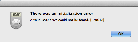

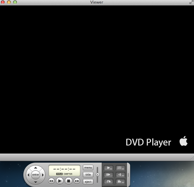

Yes man im 1-2 months hakingtosh, im not a shamed about it, and i learned and keep learning :)
I open the app i get error see pic, But I can eject or close and the drive is recognized see second pic.
Didnt know it was an app i thought you mean my drive when u said dvd player :D im intrested ofc!
hello
u graphics is not good .. typical error if u graphics is not well enable...
google about that error...
and u will see possible solutions.. is well know...
good hack

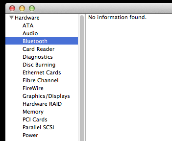

Hello Arthur!
I just freshed installed my mac with the pandora box app, all working perfect!
Only my bluetooth is not recognized i dont know why, in the past installs, it worked out of the box, straight at first boot, what do you think happend or i have to do?
My mainboard specifications says: Bluetooth V2.1+EDR / ASUS BT GO! Utility also in windows i use this wireless driver that has also the bluetooth driver:Atheros AR301x/AR9462/QCA9565 Bluetooth 3.0 + HS/Bluetooth 4.0 + HS Adapter 8.0.0.226
I see bellow the os is seeing it, but not configured dont understand :|
USB:
45]
Vendor-Specific Device:
45] Product ID: 0x3000
45] Vendor ID: 0x0cf3 (Atheros Communications, Inc.)
45] Version: 2.00
45] Speed: Up to 12 Mb/sec
45] Location ID: 0x1d170000 / 5
45] Current Available (mA): 500
45] Current Required (mA): Unknown (Device has not been configured)
LE: I find out is usb related, because if the usb ports work bluetooth works also, should i check in Chameleon Wizard UsbFix=Yes for all options or only 1 option like i guess hci require?
Thx!
