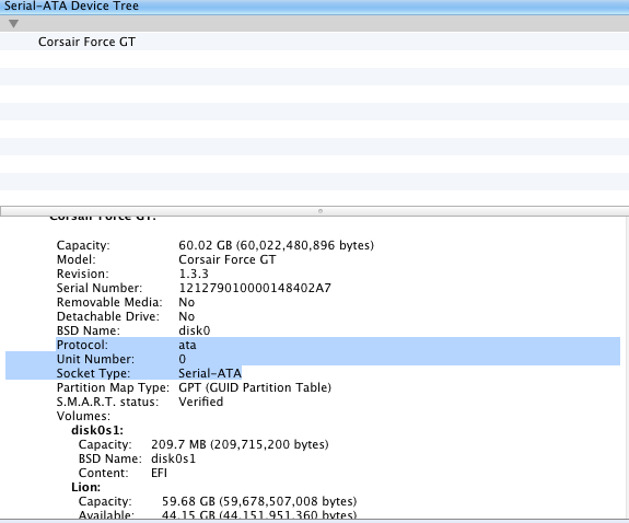

curt290 Posted July 16, 2012 Share Posted July 16, 2012 Hello guys!!! I wonder if anybody can help me with my corsair force gt sata 3 ssd... I installed mac os X lion 10.7.2 with iatkos dvd on corsair ssd , everything works fine but the ssd is not recognized as solid state on mac!!! There for i cannot enable trim on ssd. i tried trimm enabler but nothing happened. Does anyone know how to make mac recognize corsair as ssd? See the picture below.. Please help me. Link to comment Share on other sites More sharing options...
eep357 Posted July 16, 2012 Share Posted July 16, 2012 Dosen't look like a SSD problem but a sata controller problem. In the upper half of that window,that very top line above the name of your drive with the arrow pointing down, should have the name of the controller like "Intel ICH10 AHCI" or whatever you have Link to comment Share on other sites More sharing options...
curt290 Posted July 16, 2012 Author Share Posted July 16, 2012 Thanks for the quick reply man....i did searched bios and enable sata controller!! That did the work , now corsair is recognized as ssd and tromm is on. Thanks.. :thumbsup_anim: 1 Link to comment Share on other sites More sharing options...
