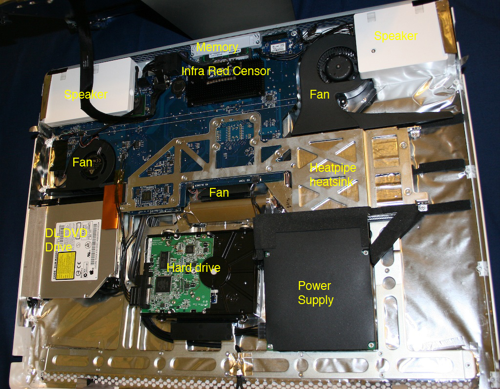

Computers are my hobby and my job. I have been in the field for over twenty years and it's amazing to watch the changes first hand. As for why I have so many Mac and Pc's? I use computers like I use shoes, When they get a little old or something I like that's newer comes out I pass my old ones down to friends and family members, and buy the latest. I do beta test for Microsoft and I am in the Apple developer pool.
Here is a basic breakdown of where things are in the 24 incher.

First of all, sorry for my bad english. Thank you very much for your great pictures, help to me a lot. Have you ever tried a raptor hd? I´ve got one and I like to try on my 24". 74Gb and 10000rpm. Thank you very much!
If i read your (Caslon) post on Page 1 correctly, you said a ATI MXM card booted into windows on a iMac 24". This in itself confirms to me that the iMac 24" is video card upgradable in theory. Whats missing is the drivers or firmware for the different cards to work. but the fact that the socket is MXM Type II and has conformed to the industry standard (vs apple's own socket) is huge. Now, as new cards come out (7950) they should be available on the apple store as a factory upgrade MUCH quicker then before (hopefully). And also, this allows users of existing iMac 24" cards to upgrade their imacs to the newer MXM cards. Lets say in 6 months , someone wants to put a MXM 7950 into their imac replacing their 7300 GT, this IS possible as long as apple is currectly supporting the 7950 (i.e. selling it as a factory upgrade for a new imac) and the user has upgraded its OS X to the latest build and persumably has all the newest drivers. however, Apple probably won't sell the upgrade, he'll have to buy the 7950 from a third party or get a laptop pull.
So, it might not let current users upgrade to the latest and greatest, but it allows users to upgrade down the road to a more powerful video card as long as apple supports it and hence, extending the life of their computer by a year or two before spending another 2k on a completely new system.
I have tried the 7600 card as well with no luck, not even windows. It needs to have an apple firmware or some hardware part to function. The physical design of the slot area does not permit a type III card at all. There are componants in the way that will not let the iMac be put back together. I had to modify and not put all the way back together to get the ATI card working. So as far as store bought video upgrades go, they don't work. If it were a driver issue, the screen would come on and I would get a kernel panic. The screen did not even power up. This tells me that it is the card. The 7600 card I had and the apple card I have are physically different too. There are more parts on the Apple video board than the Dell card. Anyway, if Apple can make it hard they will. They want you to pay 5 times the real value of most upgrades. I'm not saying that it wont be possible in the near future. I'm sure someone will figure out how to make them work, or someone will make compatible cards aftermarket. We will have to wait and see.
If it's serial ATA, it will work. You will hear it because it's louder. Also the hard drive cooling fan will most likely run alot more increasing your noise level.

Caslon, thanks for posting all the pics and for all your insight. I was just wondering, in your opinion would it be possible to cram a second hard drive (master/slave configuration) ? There certainly seems to be plenty of room in there and I would think the proper cable would do the trick.
That would not be possible. There is only one Serial ATA connector available. The ATA connector for the dvd drive is a ribbon type and there seems to be support for only one device. The room is there and maybe we will see dual drives in latter models.
