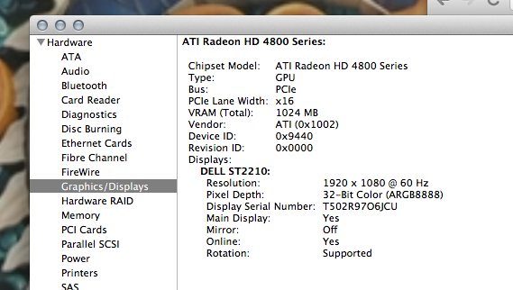

I am currently using Sapphire 4870 (standard clock, using GraphicsEnabler, I think this is the product link) and I think it is quite noisy to my liking (found this by comparing the noise between the display card exhaust and the cpu exhaust).
Thinking of getting a Sapphire ATI Radeon HD 6870 900MHZ 1GB 4.2GHZ HDMI 2xDVI DisplayPort PCI-E Video Card (Mft. Part #: 11179-09-20G)
Do you guys think this will solve the noise issue I have?
Here is the current card data from System Information
Attached File  Screen Shot 2012-09-04 at 11.54.21 PM.png   95.76K   141 downloads

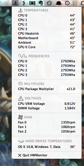

The sensors information using the tools developed by Slice (I have fakesmc and all the related kexts from his projectosx), it is not under heavy load, no graphics heavy program was running when the screenshot was taken, only there was cpu spike, normally it is around 1596MHz.
Attached File  Screen Shot 2012-09-04 at 11.47.23 PM.png   168.5K   130 downloads
