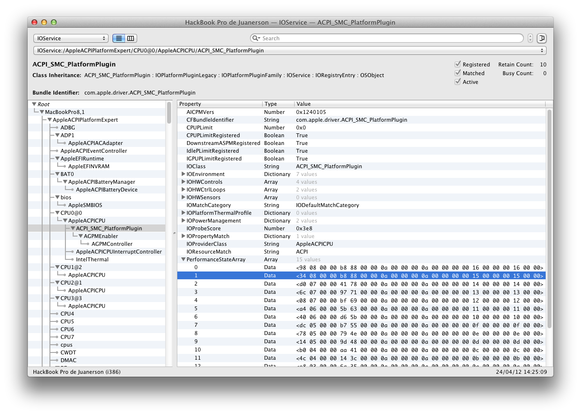

Thank You very much! That trick by Revogirl applied to my SSDT table solved all my problems with PStates - native SpeedStep. Now is working beautiful, and all multipliers are working from the corrected SSDT table.
Just I added the only one (in my case) missed P-State. In the capture marked blue:
The P-State 2100 Mhz (taking values from 2200 Mhz), added the "Apple power management software" expected = 15. Previously, the factory SSDT table was jumping from 14 to 16. Easy, but a very very effective fix found... Of course BIG THANKS, AND ALL CREDITS TO Revogirl. Cheers.
