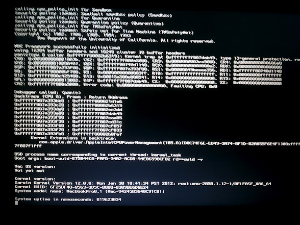

Tried to get Mountain Lion working on my hp probook 4530s.  I have a fully working lion install trying to install mountain lion I cannot get to the installer.  I tried reading through these forums and saw i needed Fakesmc.kext in the installer.  Going to try above guide tomorrow unless someone can help me out.  I am seeing i need nullcpupowermanagement.kext to avoid the intelpowermanagement kp.  but what about the other kernel panic?

Installer was bad. Followed USB tutorial couple posts down.  Installed added Fakesmc and nullcpu.  booted with UseKernelCache=no and voila...
