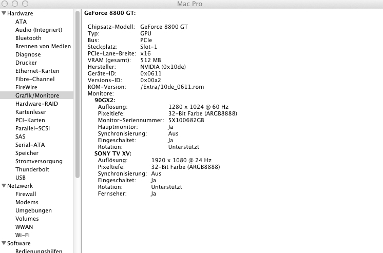

my 8800gt works fine in dp1 and dp2 with chameleon r1820
try this in your boot.plist
<key>GraphicsEnabler</key>
<string>Yes</string>
<key>UseNvidiaROM</key>
<key>VBIOS</key>
and place the attached rom in your extra folder and replace the "dev-id" you have!!!
sorry for my bad english :-)

this is my plist:
PropertyList-1.0.dtd">
<plist version="1.0">
<dict>
<key>Boot Banner</key>
<string>No</string>
<key>DSDT</key>
<string>/dsdt.aml</string>
<key>Graphics Mode</key>
<string>1280x1024x32@75</string>
<key>Kernel</key>
<string>mach_kernel</string>
<key>Legacy Logo</key>
<key>Quiet Boot</key>
<key>Rescan</key>
<key>VBIOS</key>
</dict>
</plist>
rename the romfile! see my systemprofiler...

all be god dammed it alctuly worked lol However I had to change my Smbois to a MacBook Pro 5,1 but I can live with that and the Fan's on the card a Quite Now!
Thanks!
