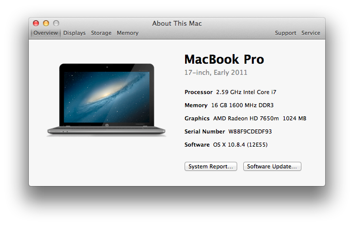

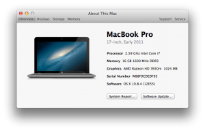

I was in this thread several months ago (thanks to Trucker and Freeuser)  but couldn't get my LVDS working.
Now I finally made it wanted to share.
My laptop :
HP EliteBook 8570p (2013) i7 3720QM, AMD Radeon HD 7570M(Thames, Device ID 0x6841), No HD4000 (Factory disabled by HP, No bios option)
I was able to make my 7570M run with LVDS with Clover's DualLink=1 option. (Freeuser recommended this long time ago but didn't get a chance to play with Clover that moment)

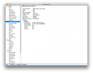

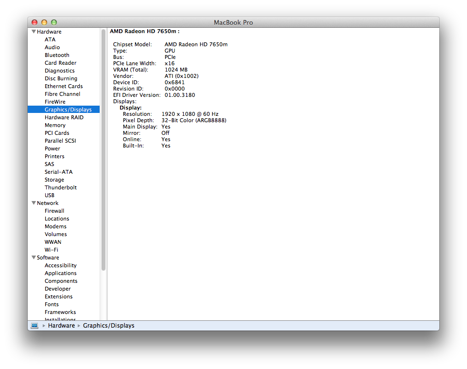

Now with this tweaks, full QE/CI is working nicely on LVDS with sleep/wake up (had to use HotPlugID from 00 to make sleep work)
FYI, DualLink with 0 gave me blank screen.
Thanks all!

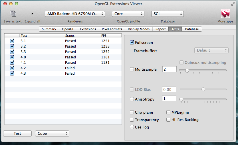

does someoene have OpenGL Extensions Viewer from apple to share,
can t download from applestore, free software....
OpenGL Extensions Viewer.zip
