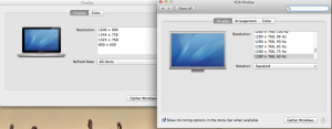

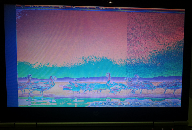

So here I am. I managed to install Mountain Lion (10.8.3) on my HP EliteBook 8460p and I am using Chimera (v1.11.1 r1394) as my boot loader. My laptop came with a AMD Radeon HD 6470M as the only Graphics card (No integrated graphics). It has a Display Port and a VGA port in addition to the LVDS.
Now the problem is, VGA and Display Ports are working flawlessly without any modding to the stock kexts, but not the LVDS. Here is a pic which shows the LVDS's current situation. It is like half of the desktop is spanned across the complete screen.

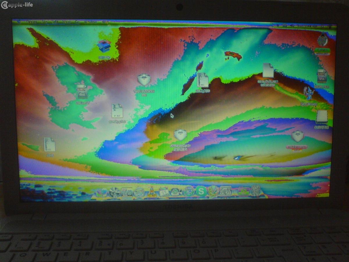

srinu9, I have very similar problem with my 7670M! Check it out:
It can be partially solved by using different encoder values (01/02/03 instead of 00 in my case). However, then I have reduced color depth (I don't know if it's 16, 20, or 24 bit, but it's not 32bit for sure).

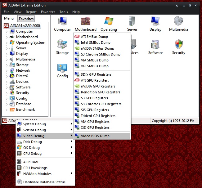

I used trial version of AIDA64 in windows. . There will be a small icon at the bottom left corner in AIDA64 Window and there will be a sub option to dump video bios when you click that icon. .. it worked like a charm for me where every other tools failed. ..

Hey, I managed to solve gradients problem on my 7670M by using EDID from other notebook! So theoretically this should also solve gradients for 6650M!
Here's EDID I used:
00 ff ff ff ff ff ff 00 06 af 2c 12 00 00 00 00 00 16 01 04 90 1d 10 78 02 19 c5 a0 58 52 95 26 0d 50 54 00 00 00 01 01 01 01 01 01 01 01 01 01 01 01 01 01 01 01 26 1b 56 64 50 00 16 30 30 20 36 00 25 a4 10 00 00 18 00 00 00 0f 00 00 00 00 00 00 00 00 00 00 00 00 00 20 00 00 00 fe 00 41 55 4f 0a 20 20 20 20 20 20 20 20 20 00 00 00 fe 00 42 31 33 33 58 54 46 30 31 2e 32 20 0a 00 25
But it worked only using DSDT injection for graphics card (CustomEDID in Clover does not work!).
Tauio111, judging by EDID, you have exactly the same screen as me. And the problem is with screen, not with video card. I think you can make it work using the same method as me.

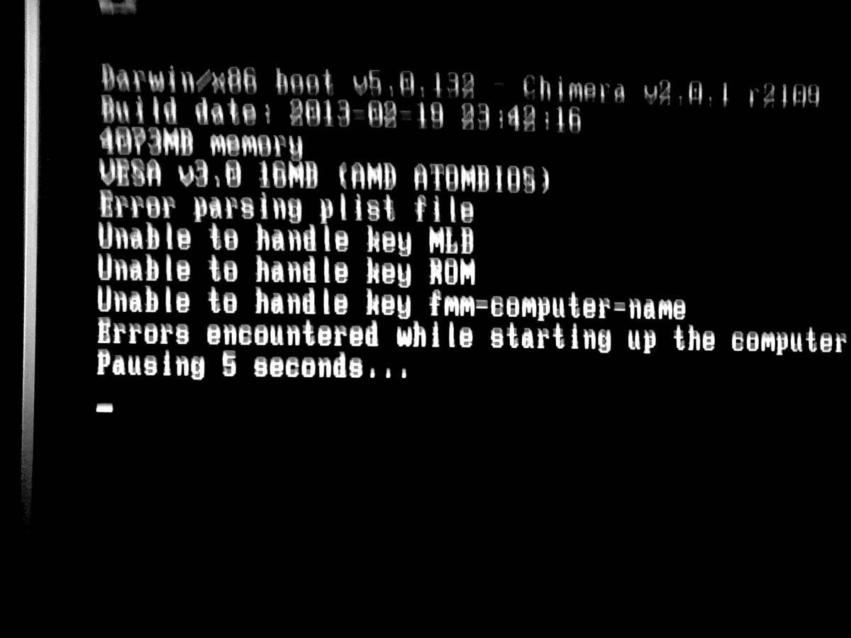

Using the string I get a few errors in startup - you can see the image I attached.

Looks like your EDID is not injected at all.. And I think this is LVDS EDID, not VGA. Thus LVDS is black. Did you do the dump with my strings? If not, then do it with one of the strings.
Is notebooks monitor shown in "About this Mac" window when you are injecting one of the strings?
Also you don't have GraphicsEnabler in your Chameleon config, did you disable it in bootloader?

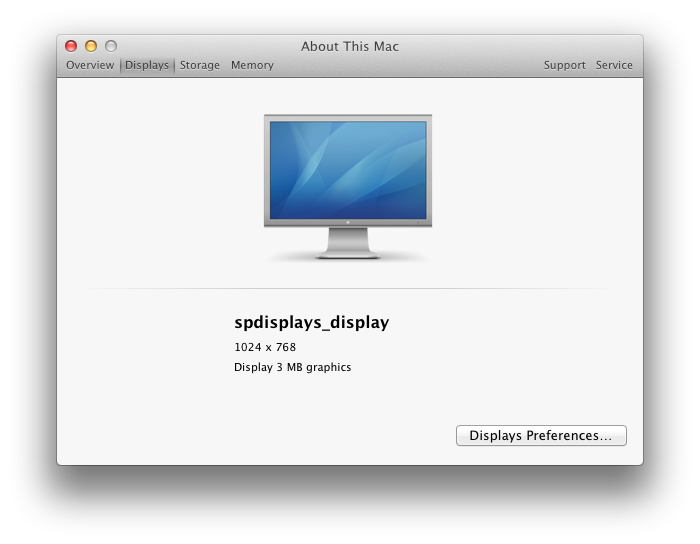

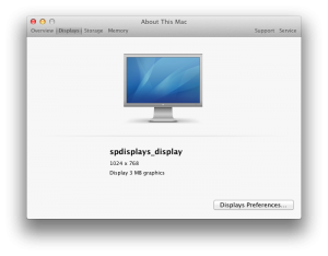

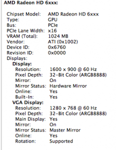

Look at picture attatched

Was that screen taken with string injection? Judging by it, video card is not enabled as if there was no device-properties string at all. I also patched ATI6000Controller from 10.8.3 for your video bios. This one is 100% correct.
