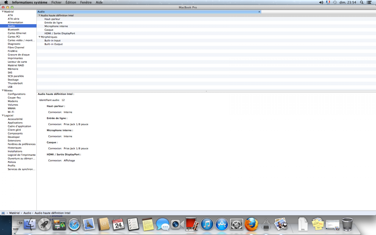

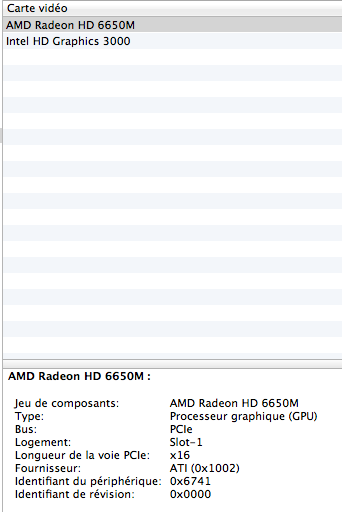

hi,
i modified the posted applehda to my config, 7750g dual graphics,
for my laptop hd3000 and ati6650m , speaker ,headphone nodes are 20;12;2-----33;12;2
if i use smbios from macbook pro 8.2 , i have both graphics in ioreg with Dsdt but ati with no framebuffer , agpm is loaded
kernel[0]: [AGPM Controller] build GPUDict by Vendor1002Device6741
mux_initialize: Couldn't find any matches
AppleHDA.kext.zip
