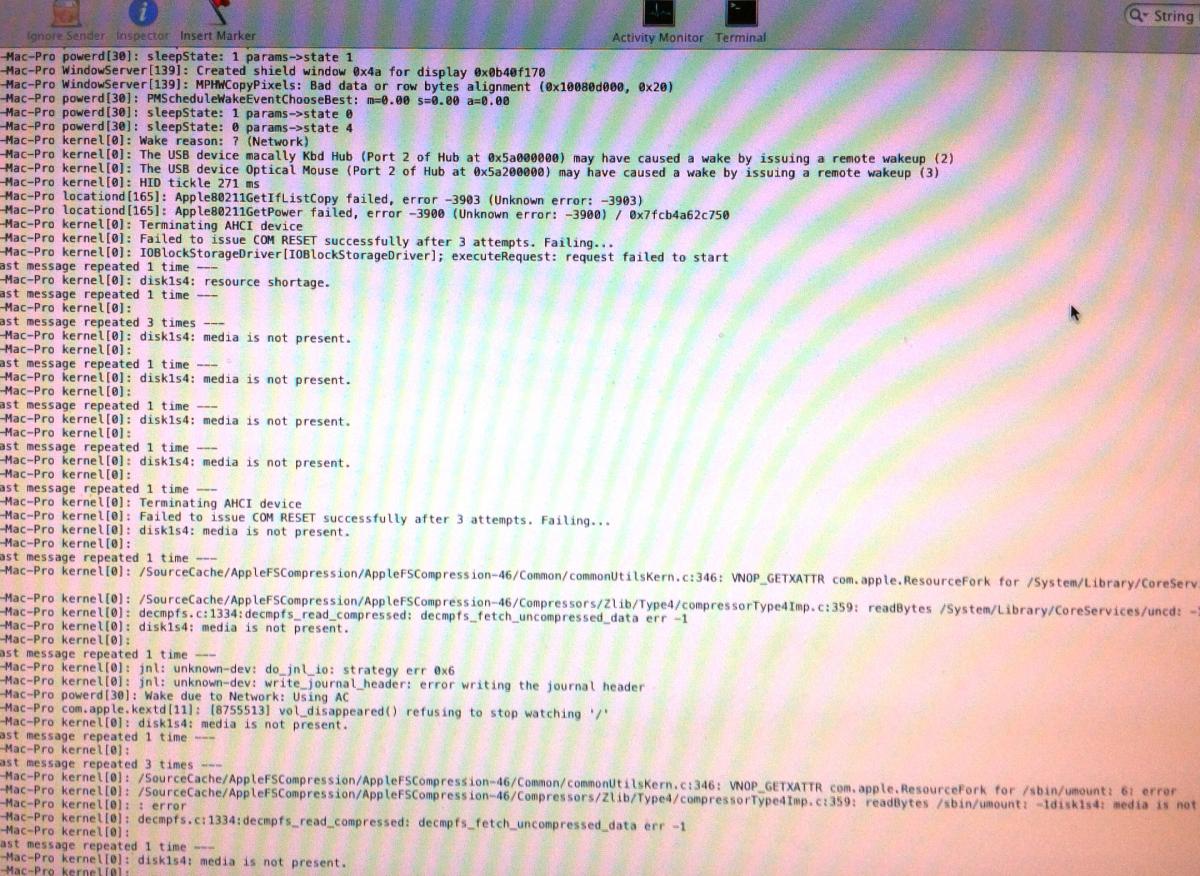

it's not cmos reset, it's just that our HDD is ejected without doing anything =(
commputeur go to sleep, i wake it up, 5 mn after my donnee's HDD is ejected
I see the same thing..
Entering sleep with the Terminal window open, then waking and typing in to the Terminal shows there's no more system available...
typing sudo -s returns:
Permission denied
whoami returns:
Operation not permitted
ls -al / returns:
Here's what I see in the system log in console. Note: You need to have it running before sleeping as after waking from sleep the drives are lost and the logs will no longer be written to.
Attached File  Console-System-Log.jpg   928.83KB   110 downloads
The same symptoms happen regardless of bootloader, Chameleon, RevoBoot, XPC, Clover.
If this doesn't happen for everybody then it's got to be something on my machine.. possibly something in my ACPI tables? Need to check DSDT. But something had changed with Mountain Lion as this issue doesn't appear in 10.7.3.

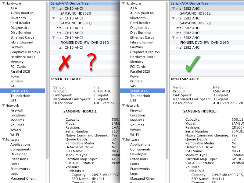

UPDATE:
Well after a few unsuccessful hit and miss attempts at patching IOAHCIFamily, I thought I'd try a different approach.
And now it seems my issue has something to do with ICH10 as changing the device-id of my SATA to that of ESB2 stops 10.8 DP1 losing my disks after a sleep/wake cycle.
Attached File  ICH10-Issue.jpg   109.07KB   250 downloads
With this, at least for now I am now back to using the AppleAHCIPort.kext v2.4.0 and IOAHCIFamily.kext v2.2.0 from 10.8 DP1.
But I want to use my native ICH10.
00:1f.2 SATA controller [0106]: Intel Corporation 82801JI (ICH10 Family) SATA AHCI Controller [8086:3a22]
So what can be the problem with this? hmmm...

Hi efimac
NOTE: This is only for testing and not something I'd recommend as a permanent fix.
I used an old trick to change the device-id - You can find read about it here: http://www.insanelym...dpost&p=1253758
It's just another step towards trying to pinpoint, or at least to help with trying to understand why I experience loss of drives after a sleep/wake cycle. I now know at least that it's something to do with using my native ICH10 with 10.8 DP1's AppleAHCIPort.kext and IOAHCIFamily.kext.

I've changed it and your tip works. Thanks again. So what is the advantage of ICH10 against ESB2

Perhaps this explains why the drive ejects during sleep during the former and not the latter.
Maybe there's something to that scorcho. Though if it were by design, would it make sense for Apple to change their OS to eject all external drives when the system goes to sleep? Anyhow - this has to be a bug or an issue here on my system as the system drive becomes ejected too!
Earlier this morning I did run a test without using an orange icon fix and although the System Information/Serial-ATA/Intel ICH10/HDD status for Removable Media changed from No to Yes - it didn't make any difference with regard to the drives disappearing after wake from sleep. When I get more time at my machine I'll look further in to it.
