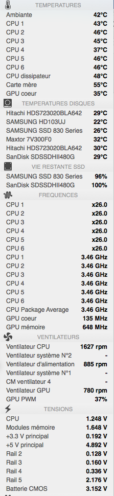

@ROBASEFR Posted March 25, 2017 Share Posted March 25, 2017 Hi, I'm after a bit of help getting fans and voltages reading correctly. I'm using a Gigabyte EX58-UD5 which has an ITE it8720f SMC IC, shown top left in this photo: 82948_2245_draft.jpg This is what I'm starting with: Screen Shot 2017-01-14 at 00.42.50.png I'm using FakeSMC v6.23.1417 with CPUSensors, GPUSensors and LPCSensors Fans: What I would like is to move and rename the labels shown: GPU Fan @ ~ 4500rpm should be 'Water Pump', this is on the CPU FAN header CPU Fan @ ~ 1750rpm is my 'Rear Case Fans' connected to SYS FAN 2 (2 fans on a Y cable to PWM header) System Power Fan 2 @ ~ 1337rpm is my 'Upper Case Fan' connected to SYS FAN 1 Power Fan @ ~ 1348 rpm is my 'Lower Case Fan' connected to PWR FAN (correct) I don't have a GPU fan as I'm water cooled Voltages: GPU Core (correct) CPU Core (correct) Memory Modules (correct) Main 3.3V - Completely wrong Main 5V (correct) Power Supply 2-5 - no idea what these should be CMOS Battery (correct) Here are my voltages and fan speeds shown in BIOS: IMG_0034.jpg Any help would be appreciated Hello, I'm using FakeSMC.kext v 6.24.1421 ; HWSensors.app with LPC,GPU,CPU and ACPI Sensors kext (Plugins ) I did some editing and created a specific Platformprofil ( inside LPCSensors.kext//Info.plist/IOKitPersonalities/ITE IT87xMonitor/Platformprofil/Gigabyte/ ) for my GA-EX58-UD5 MOBO You'll find hereby my complete FakeSMC.kext (wich I put in EFI/C/K/10.12) Image what I see with HWSensors.app (6.24.1421) FakeSMC.kext.zip Perhaps this can help ! To do Fan name editing, you can do this in the the EX58-UD5 profil /Info.plist.... and the same in IT8720F dictionary Good luck 1 Link to comment Share on other sites More sharing options...

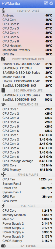

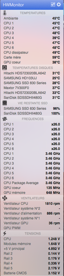

@ROBASEFR Posted April 10, 2017 Share Posted April 10, 2017 There are some little but nice improvements with the latest HWsensors 6.25.1426 compared to 6.24.1421(even with an old X58 mobo...) 6.24.1421 6.25.1426 Link to comment Share on other sites More sharing options...
