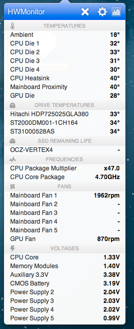

1. Why don't I have GPU or any other fan showing other than CPU?
2. Why does only one CPU core show up in Frequencies? I saw a few posts before me a guy had more than 1 core showing.
I wan't my HWMonitor to show GPU Fan speeds and CPU/GPU Freqs like this:
3. My CPU is at 3.8GHz(Turbo) but HWMonitor only reports 3.5GHz same with iStat Menus. MsrDumper shows 3.8GHz though.
4. Why doesn't frequencies for my GPU or RAM show up?
5. Why does 5 mainboard fans show up? Is it detecting all fan sensors I have on the board or something? I only have my CPU fan connected. Shouldnt that be named "CPU FAN"?
Can I rename it somehow?
1- Your graphics card is probably not supported, I'm not sure. Check your console log to see what the Radeon plugin says. (RadeonSensors (pci1@0): found ATI Radeon 0x68b8)
2- For newer cpus it shows a single frequency and multiplier probably because those cannot be independent so it's redundant.
3- Are you overclocking your cpu by turbo states? If you set them to 38-37-36-35 then you probably won't see the cpu reaching 38 frequently because it's for single core use only. The most used will probably be 35 and sometimes 36 or 37.
4- Not supported for the Radeon plugin yet, still hoping...
5- Yes it detects all the fan sensors and lists them, you may deactivate them by turning the little eye off in the Preferences-Menubar. I'm not sure how to rename the sensors but I guess it's in the info.plist in the LPCSensors kext.
