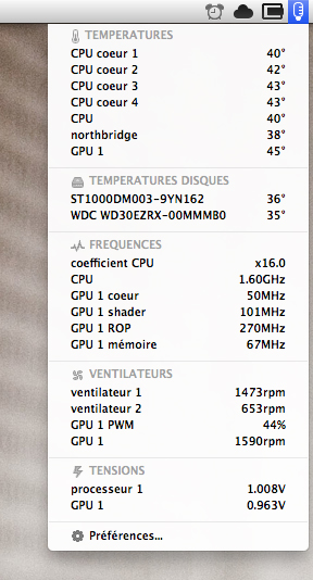

But i have a monitoring GPU (see attached)
I have noticed a difference with the GPU memory ; before in GStates 1 and 2 = 135 MHz and now 67 MHz reported.
Hope this help.
Thank you for reports. I've found couple of bugs in i2c module so it always reports no devices found.
Anyway seems Fermi and Kepler cards has no (supported) integrated monitoring devices. What I need after the next revision is reports from GT/X2xx, gf9xxx cards owners.

Hi,
rev. downloaded 15 minutes ago :
Aug 18 17:15:06 localhost kernel[0]: NouveauSensors: [card0] [Debug] memory mapped successfully
Aug 18 17:15:06 localhost kernel[0]: NouveauSensors: [card0] [Debug] identifying the chipset
Aug 18 17:15:06 localhost kernel[0]: NouveauSensors: [card0] [Debug] BOOT0  : 0x0c8000a1
Aug 18 17:15:06 localhost kernel[0]: NouveauSensors: [card0] chipset: GF110 (NVC8) family: NVC0
Aug 18 17:15:06 localhost kernel[0]: NouveauSensors: [card0] [Debug] crystal freq: 27000KHz
Aug 18 17:15:06 localhost kernel[0]: NouveauSensors: [card0] [Debug] trying to shadow bios
Aug 18 17:15:06 localhost kernel[0]: NouveauSensors: [card0] [Debug] shadowing bios from PRAMIN
Aug 18 17:15:06 localhost kernel[0]: NouveauSensors: [card0] [Debug] VBIOS appears to be valid
Aug 18 17:15:06 localhost kernel[0]: NouveauSensors: [card0] VBIOS successfully read from PRAMIN
Aug 18 17:15:06 localhost kernel[0]: NouveauSensors: [card0] [Debug] parsing BIOS
Aug 18 17:15:06 localhost kernel[0]: NouveauSensors: [card0] VBIOS BIT signature found
Aug 18 17:15:06 localhost kernel[0]: NouveauSensors: [card0] VBIOS version 70.10.20.00
Aug 18 17:15:06 localhost kernel[0]: NouveauSensors: [card0] [Debug] initializing monitoring driver
Aug 18 17:15:06 localhost kernel[0]: NouveauSensors: [card0] [Debug] parsing i2c dcb table
Aug 18 17:15:06 localhost kernel[0]: NouveauSensors: [card0] [Debug] adding i2c port nouveau-5-0-e138-e138-0
Aug 18 17:15:06 localhost kernel[0]: NouveauSensors: [card0] [Debug] adding i2c port nouveau-5-1-e150-e150-1
Aug 18 17:15:06 localhost kernel[0]: NouveauSensors: [card0] [Debug] adding i2c port nouveau-5-3-e180-e180-2
Aug 18 17:15:06 localhost kernel[0]: NouveauSensors: [card0] [Debug] adding i2c port nouveau-5-5-e274-e274-5
Aug 18 17:15:06 localhost kernel[0]: NouveauSensors: [card0] [Debug] adding i2c port nouveau-5-6-e764-e764-6
Aug 18 17:15:06 localhost kernel[0]: NouveauSensors: [card0] [Debug] adding i2c port nouveau-5-7-e780-e780-7
Aug 18 17:15:06 localhost kernel[0]: NouveauSensors: [card0] [Debug] adding i2c port nouveau-5-8-e79c-e79c-8
Aug 18 17:15:06 localhost kernel[0]: NouveauSensors: [card0] [Debug] adding i2c port nouveau-5-9-e7b8-e7b8-9
Aug 18 17:15:06 localhost kernel[0]: NouveauSensors: [card0] [Debug] adding i2c port nouveau-6-0-0-0-10
Aug 18 17:15:06 localhost kernel[0]: NouveauSensors: [card0] [Debug] adding i2c port nouveau-6-1-1-1-11
Aug 18 17:15:06 localhost kernel[0]: NouveauSensors: [card0] [Debug] adding i2c port nouveau-6-2-2-2-12
Aug 18 17:15:06 localhost kernel[0]: NouveauSensors: [card0] [Debug] adding i2c port nouveau-6-3-3-3-13
Aug 18 17:15:06 localhost kernel[0]: NouveauSensors: [card0] [Debug] probing I2C busses...
Aug 18 17:15:06 localhost kernel[0]: NouveauSensors: [card0] [Debug] bus: 1 device: 4c
Aug 18 17:15:06 localhost kernel[0]: NouveauSensors: [card0] [Debug] bus: 1 device: 4a
Aug 18 17:15:06 localhost kernel[0]: NouveauSensors: [card0] [Debug] bus: 1 device: 49
Aug 18 17:15:06 localhost kernel[0]: NouveauSensors: [card0] [Debug] bus: 1 device: 48
Aug 18 17:15:06 localhost kernel[0]: NouveauSensors: [card0] [Debug] bus: 1 device: 46
Aug 18 17:15:06 localhost kernel[0]: NouveauSensors: [card0] [Debug] bus: 1 device: 30
Aug 18 17:15:06 localhost kernel[0]: NouveauSensors: [card0] [Debug] registering temperature sensors...
Aug 18 17:15:06 localhost kernel[0]: NouveauSensors: [card0] [Debug] registering clocks sensors...
Aug 18 17:15:06 localhost kernel[0]: NouveauSensors: [card0] [Debug] registering PWM sensors...
Aug 18 17:15:06 localhost kernel[0]: NouveauSensors: [card0] [Debug] registering voltage sensors...
Aug 18 17:15:06 localhost kernel[0]: NouveauSensors: [card0] started
