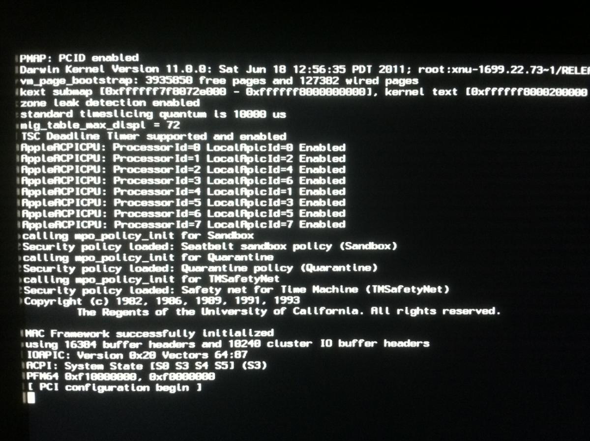

Gringo Vermelho Posted January 17, 2012 Share Posted January 17, 2012 That's great, it means that Chameleon was installed correctly. That was easy right? So far you have only installed the boot loader itself, now you can configure it so that it works the way you want it to. The extra folder and its contents are decided and is placed there by you. You're the boss now. It stops at the Apple logo because you're missing some kernel extensions and configuration settings. Type -v at the boot prompt to see where you are getting stuck. Take a photo while you're at it and attach it here so I can see what's happening. Download the default Chameleon theme from my guide - unzip it and place the "default" folder in /Extra/Themes - if you don't like it you can replace it later, but let's go with the default theme for now. Place the attached org.chameleon.Boot.plist in /Extra - you can edit the Graphics Mode string (I set 1024x768) first, so that it matches your display's native resolution. org.chameleon.Boot.plist.zip. In the theme folder, find theme.plist, open it and set the theme resolution there to your display's native res as well. Note, it's in two places, there's one towards the end as well. Find and download the latest fakesmc.kext from the following link. This kernel extension is required in order for OS X to work on a PC. http://www.projectos...p?showforum=165 - find the main driver topic and download fakesmc 3.1.0 from the link in post #5. Also grab this kext for your ethernet: http://lnx2mac.blogs...osx-driver.html You'll need to fix permissions and ownership on these two via Terminal after dropping them in /System/Library/Extensions, otherwise OS X will reject them. Drag them to System/Library/Extensions, click away any error dialogs that appear, and run Terminal.app. Now enter (exactly as written, mind the capital R) sudo -s (enter your password, don't worry it's supposed to be invisible) chown -R root:wheel /System/Library/Extensions chmod -R go=u-w /System/Library/Extensions exit And reboot. Let's see how far you get. Once you're at the Chameleon GUI and your system drive is highlighted, start typing and the boot prompt will appear at the bottom of the screen. Boot with the -v flag (for verbose mode), take and attach a photo if it gets stuck. If it somehow manages to magically boot all the way to the desktop, run terminal.app and enter bdmesg > ~/desktop/bdmesg.txt (this pipes the bdmesg output to a text file) sudo dmesg > ~/desktop.dmesg.txt (and your password) I need to see these in order to determine what to do next. Go to your desktop, select both .txt files, right click, click compress and attach the zip to your next post. If you didn't get to the desktop (it is unlikely) just attach a photo like I asked. Link to comment Share on other sites More sharing options...
EddyMac Posted January 17, 2012 Author Share Posted January 17, 2012 Here is the pic you asked for. (This is before doing all the stuff you mentioned above.) Link to comment Share on other sites More sharing options...

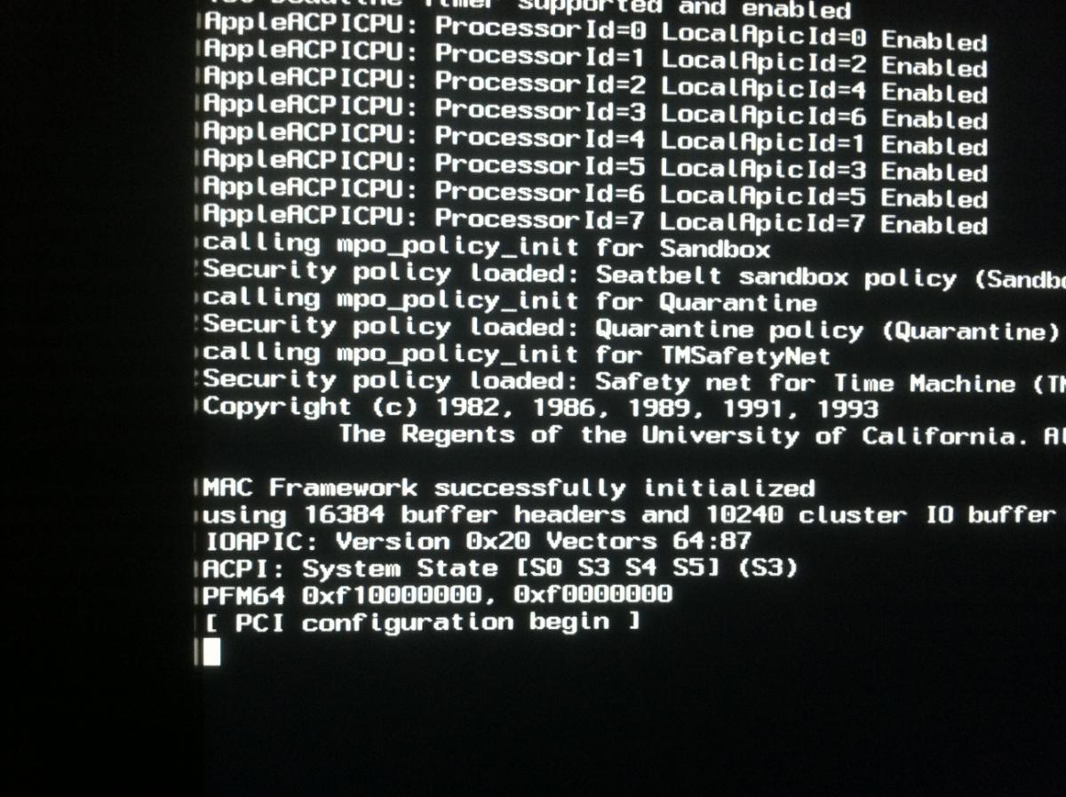

Gringo Vermelho Posted January 17, 2012 Share Posted January 17, 2012 Great, progress! Add npci=0x2000 to the empty kernel flags string in your /Extra/org.chameleon.Boot.plist. So that it looks like this: kernel flags npci=0x2000 Link to comment Share on other sites More sharing options...
EddyMac Posted January 17, 2012 Author Share Posted January 17, 2012 OK did all the above. Still won't boot to the desktop, so I'm attaching a photo of where it gets stuck. Link to comment Share on other sites More sharing options...
Gringo Vermelho Posted January 17, 2012 Share Posted January 17, 2012 Try booting with GraphicsEnabler=n -v Does it stop at the same spot? npci=0x2000 is supposed to cure hanging at "PCI Configuration Begin". Are you sure you have set it correctly? zip and attach the DSDT.aml you were using before, if you still have it. Link to comment Share on other sites More sharing options...

EddyMac Posted January 17, 2012 Author Share Posted January 17, 2012 OK I was able to try with GraphicsEnabler=n -v And yes, it stops at the same spot. Link to comment Share on other sites More sharing options...
Gringo Vermelho Posted January 17, 2012 Share Posted January 17, 2012 Where is the DSDT from originally, did you download it from somewhere (that's a big no no) or did you dump it yourself? Just so I don't waste my time with it. In the meantime try James' suggestion, set 3000 instead of 2000. ....is from the /Extras folder Extra, not Extras. If the folder is named Extras, Chameleon will not see any of the files in it. Link to comment Share on other sites More sharing options...
