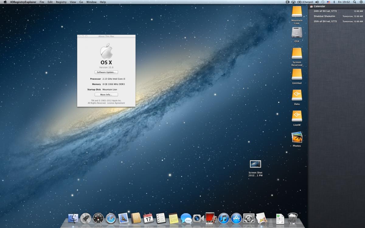

Ok guys, I've just installed 10.8 Mountain Lion DP1 on Lenovo T510
Install process was pretty simple:
Everything works fine but I have some random freezes.
- Atheros WLAN card doesn't work
- Sleep not working with my latest dsdt edits
- Cmos reset after sleep even with patched AppleRTC
- Still have USB lost after sleep

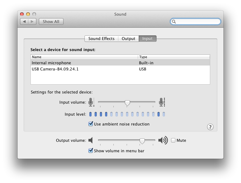

Good news
- have noise reduction checkbox in sound preferences mic section
Good news
About 10.8 installation
- Sleep now working
- No more cmos reset after sleep

Shalom folks!
I'v got completely working solution for sound at T510/T410 + T520/W520(with different bin patch)
What we got
-sound autodetection speakers-headphones
-internal mic
-external mic with combo port as line in
to use headphones+external mic you need to use headset like iPhone use or any other phone with 4 pin TRRS mini-jack connector
also to get it working you should use some patch for HDEF dsdt section
				Store (Package (0x0E)
						"AAPL,slot-name",
						Buffer (0x09)
							"Built in"
						"device-id",
						Buffer (0x04)
							0x69, 0x50, 0xF1, 0x14
						"layout-id",
						Buffer (0x04)
							0x6E, 0x50, 0x00, 0x00
						"model",
						Buffer (0x1A)
							"HD Audio Conexant Cx20585"
						"name",
						Buffer (0x11)
							"Conexant Cx20585"
						"device_type",
						Buffer (0x11)
							"Audio Controller"
//							 "hda-gfx",
//							 Buffer (0x0A)
//								 "onboard-1"
						"PinConfigurations",
						Buffer (One)
							0x00
					}, Local0)
				Return (Local0)
Then install next with updated dsdt and reboot
T520/420/W520 machines should patch my next with your codec IDs
sudo perl -pi -e 's|\x69\x50\xf1\x14|\x6e\x50\xf1\x14|g' AppleHDA.kext/Contents/MacOS/AppleHDA
Good luck
Conexant Cx20585-AppleHDA.kext-new-work-latest-2012.03.30.zip

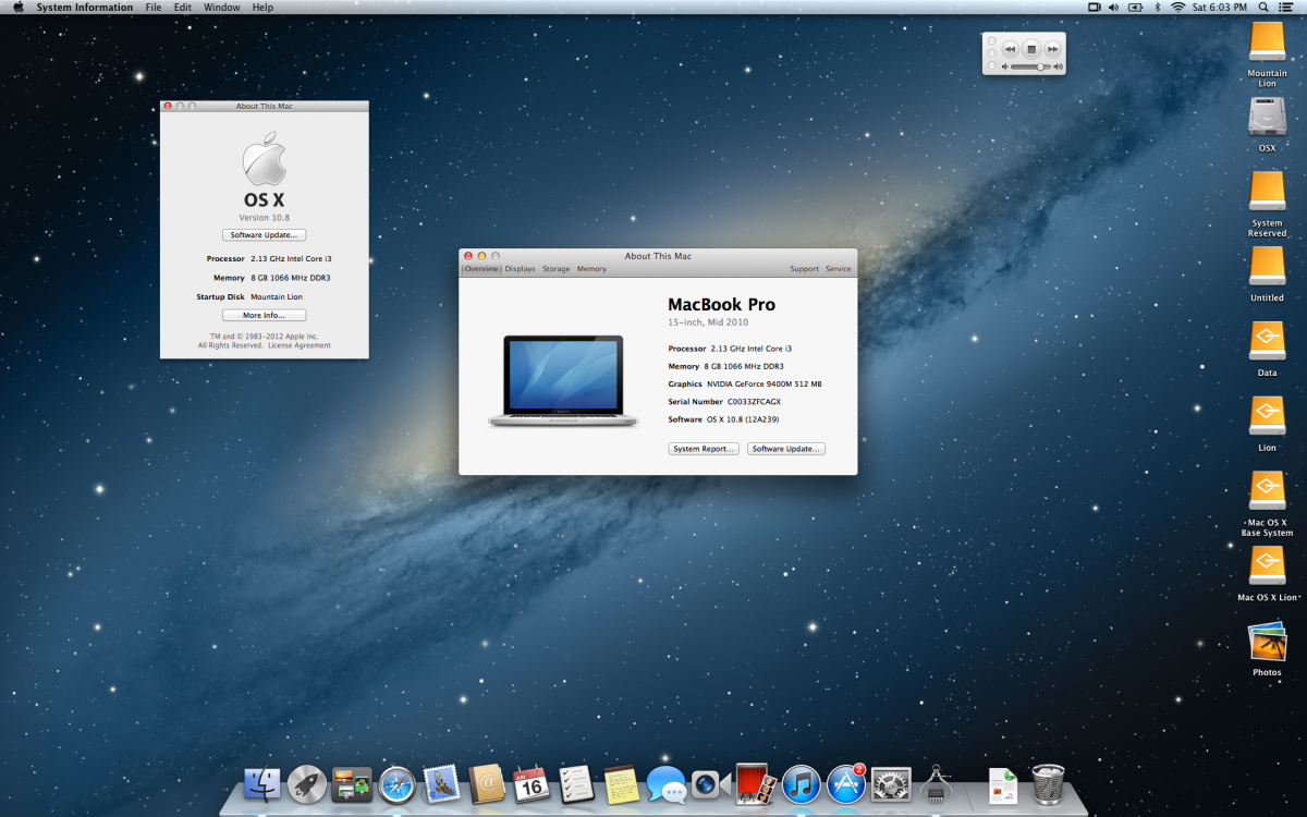

Ok folks! I've installed 10.8 DP4 on T510 and it works fine except audio (need to fix HDA to new format)
