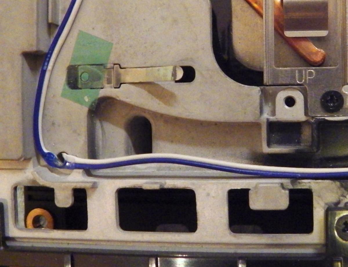

Hi Joshhh,
I think its sense pin in sound connector malfunction.
unfortunately I think you are wrong with this (see picture) :-(
Which idiot has done this???
Now I have to look how I get resolved this "issue", either I have warranty from the dealer where I bought the laptop used, or I still have IBM warranty. I think that audio probably never was working on this laptop, but it also is possible the the used-laptops dealer has done this, so IBM warranty will not count. And actually I do not want to send my laptop fo weeks to repair, so might be I just try to get a new speaker and replace the old one and hope, that the shortcut did not kill anything on the board.
Hi Joshhh,
Oh {censored}! really sad about it. Maybe possible to peel-cut wires, connect it and check if warranty is no more valid
